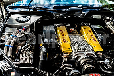

great videos and review, did you do one of those FTP style underhood tanks? any pics?
Thanks Yes it is one of those. Nice tank though despite their reputation.Here is a quick pic I just found. Very clean tanks. Actually makes it look better under the hood.
That's pearlpowers setup
