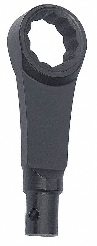

now if we can find a slim torque wrench, replacement would be SUPER easy

maybe a 24mm extension for a torque wrench like this would remove the need to raise the motor?
http://www.grainger.com/Grainger/PRO...nch-Head-4NAZ8
