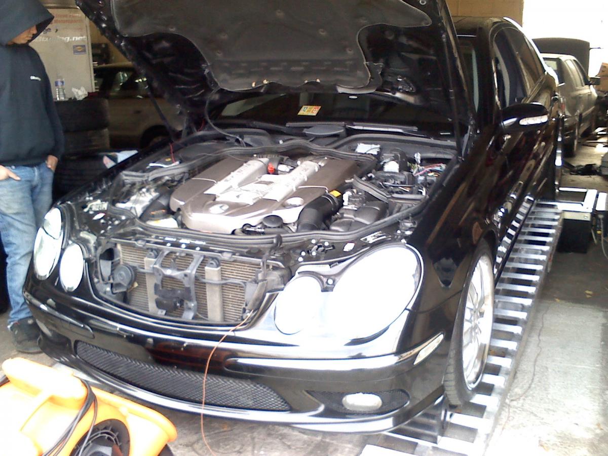

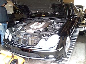

working on my buddies black e55 out with the old tune in with the bip tune. Getting rid of the lean tune it had in it.

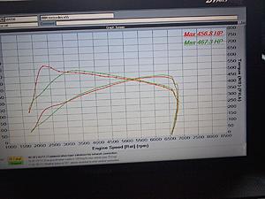

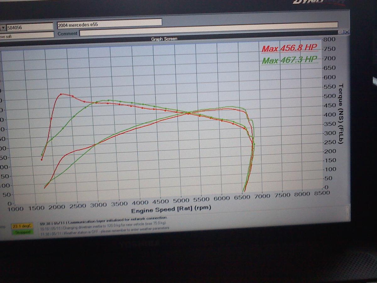

my buddy bought the car it had a pulley on it etc kleemans super lean though m first time using the dyno dynamics but it ended up 467 with dyno dynamics number with a much safer afr it was in the 13's now its in the 11's the air fuel

The dyno dynamics is way different then my dynojet so took me a few runs. even on the last run i rolled into too long before flooring it. but the main reason for the tune was my friend saw the car was in the 13's af i confirmed it with my zietronix. 2 pulls later we were good to go. Thanks craig and tony for fast easy service.
