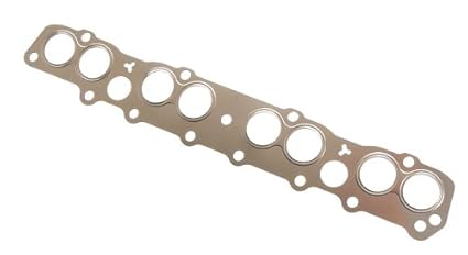

which exhaust gaskets are best to use? seeing a couple kinds..
1 set seems to be individual gaskets per cylinder (8 needed)

and the other style looks to be a left/right side (2 long pieces)
what's everyone prefer?

If you got it from Kleeman they come with in the packaging. gaskets, new brass nuts, referring to your two pictures the upper picture......thats you need if you were going to buy them individually, but they should come right in the packaging from Kleemann
+1
why you looking for gaskets. they came with gaskets nuts and all

I used these. Never seen the others before
Is that picture of 1 piece long gasket for M119 Engine...!, i think Kleemann not provides 1 piece gasket, isn't...?
usually, M113 comes with separate gasket pieces....!!
