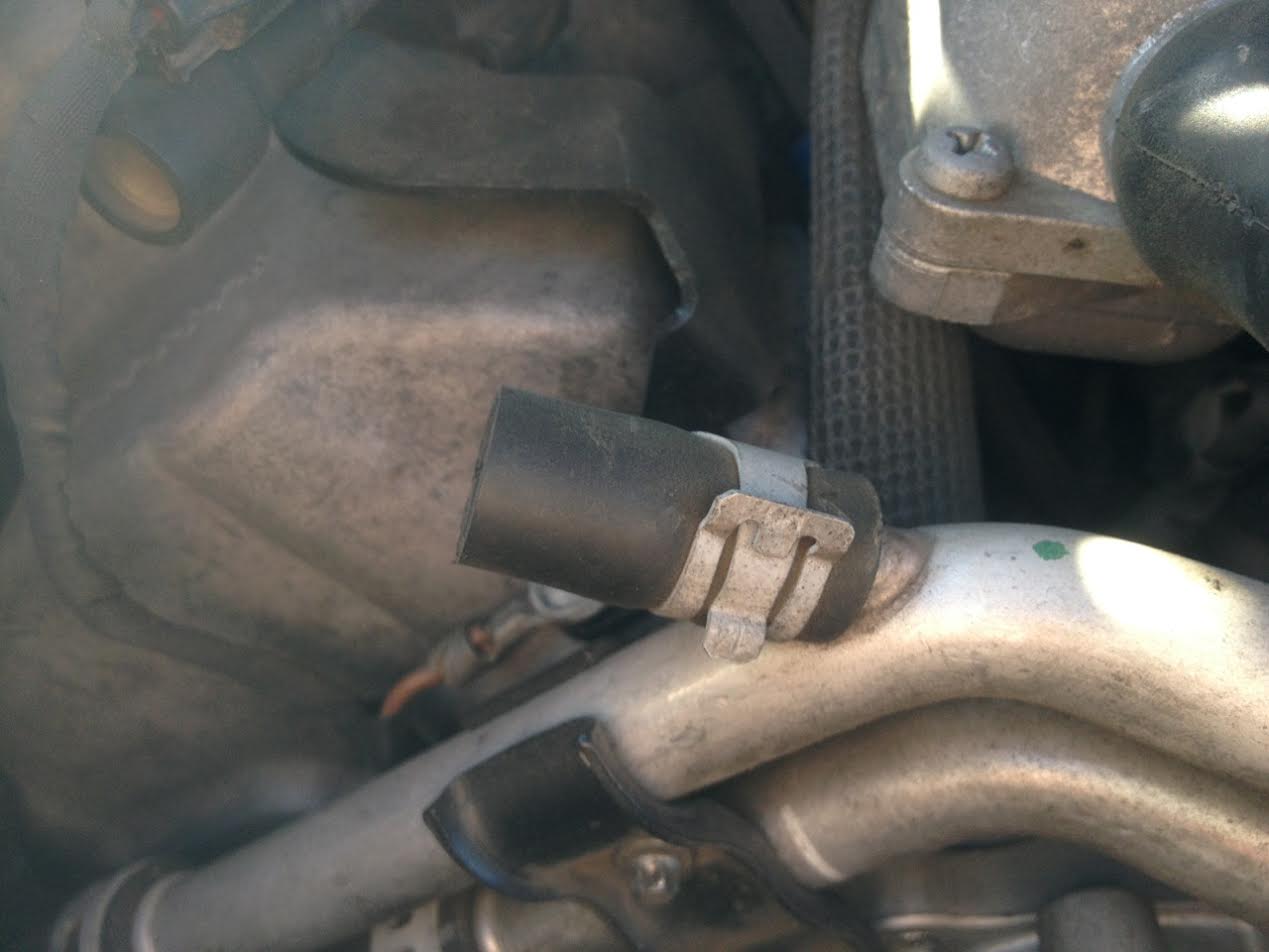

I think I do see it lol but not sure do you have a pic of it
Is this the self bled hoes you guys are talking about ?

Originally Posted by biggking
As stated by other members, you don't need to do anything to bleed the system. It's got a small bleed hose, really thin looking one going to the reservoir.
Is that the hoes you talking about ? Lol it is connected to the system -__- but not sure if it is
No those hoes are not needed here.
Disconnect this end cap and plug one end of a rubber hose here and the other end into your fluid reservoir. You then need to run the pump until no more bubbles come out. You can run the pump either thru STAR DAS if you have it or manually put 12v to the pump connectors.
I actually did that bro but insted of 12v or star I just turn on the car and let it sit ..After like 5 min I still saw lil bubbles but I just thought it was done ? At first I did see gaps of air...did I do it wrong ?
