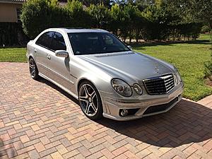

So you bought a grill not meant to work with the distronic front plate and it still works? Can you post a picture of your set up please?

Anybody retrofit distronic with an aftermarket black grill?-1f68fba7-d6f9-42d7-b8c3-106a87c5a5d6.jpgAnybody retrofit distronic with an aftermarket black grill?-bb4579be-834e-4464-a08c-2ed8e2e418cc.jpg

Originally Posted by BagMan
Super clean
Sorry for this potentially dumb question but wouldn't you have any wires just hanging around if you don't put the distronic front plate on the grill?
