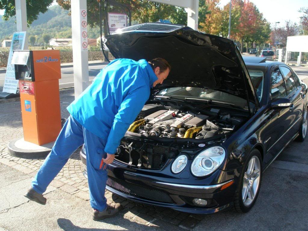

Jet Hot Coatings http://www.jet-hot.com/ is a good option. Applying gold thermal reflective tape to the air boxes and intake tubes will eliminate 99% of any radiant induced heat. You will find this material in use from spacecraft to F1 cars. I was able to achieve a significant reduction in IAT's.
Interesting. Can you share some stats about how much reduction in AIT? Was it measured at idle/cruising and WOT?
