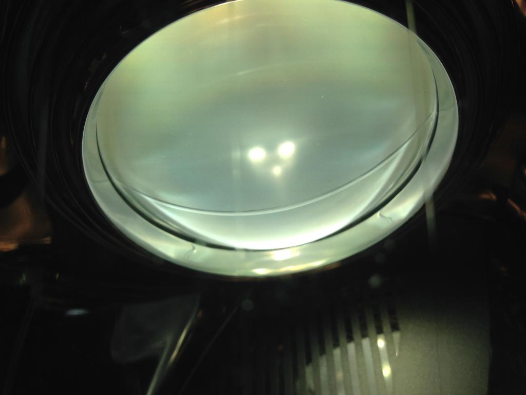

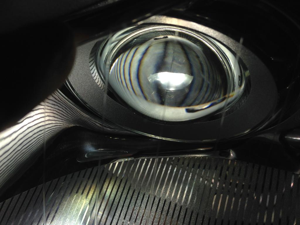

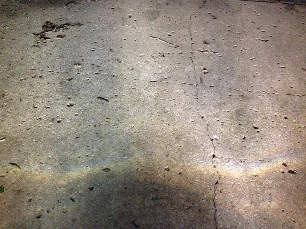

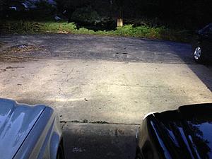

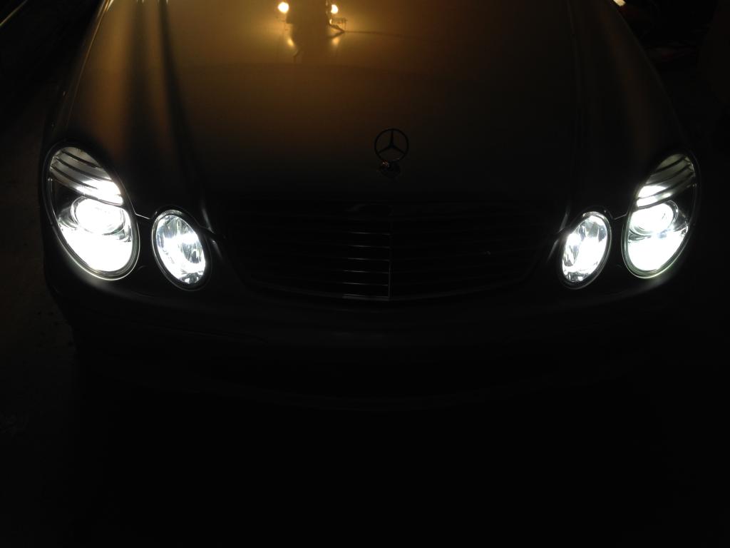

Didn't have a chance to take some nice pix but here ya go. Hope you like iphone pictures. the E55 has stock projectors with clear lenses and cbi bulbs from trs. The chrome was replaced with facelift chrome in the headlamps but the projectors are '04. The S600 has completely stock housings with the new Phillips x vision bulbs. Less than 1 hour burn in. For some reason the bulbs look green in the s but it's from the camera.
E55 clear lens
Stock S600 lens
Old bulb in vehicle left side, right side in pic. Cbi on other side. Camera didn't capture it well but the aged bulb was much dimmer and slightly bluer.
You can see it better in this pic. Old bulb on left, cbi on right. Notice the color difference and the "weaker" prism effect.
