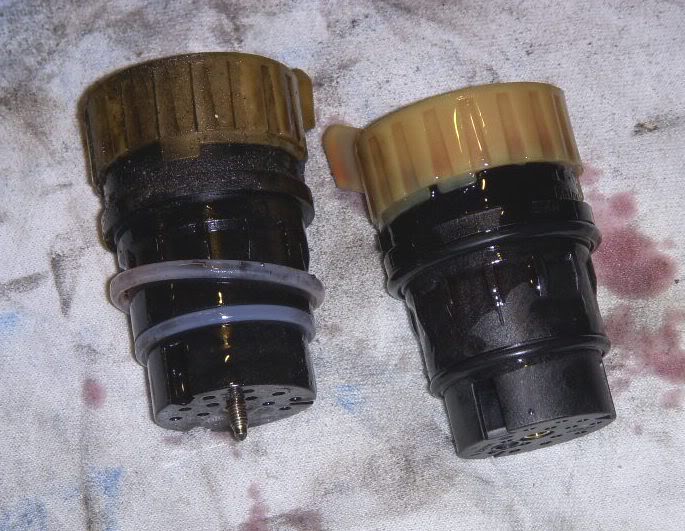

They are easy enough to swap out.
Ensure the pins and respective receptacles are perfectly aligned before sliding things home as they're quite fragile.
My first impression of doing this job was 'i'm going to eff some stuff up', right up until the part was delivered.
