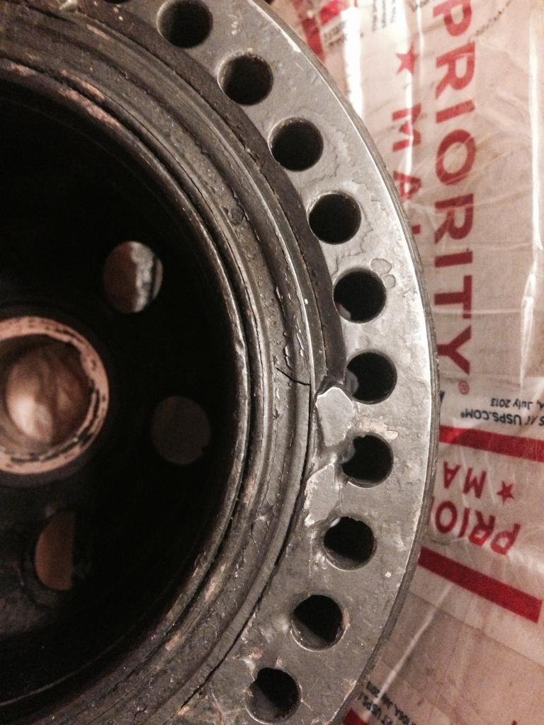

Does this work.
this is the only real crack, apart from that it is fine.

I'd personally run it as long as the outer ring is true. If you see it has lateral runout I'd probably scrap it. A little radial runout is to be expected.

Personally I would consider a crank pulley pin so there will no chance of the pulley shearing the keyway if anything does go wrong. Maybe have a word to Shardul to see if his kit will fit your pulley. It comes with a reusable hex head crank bolt also. A small investment for peace of mind.

Thanks, spoke to Shardul, and got a few extras needed.
