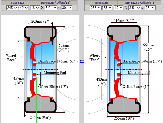

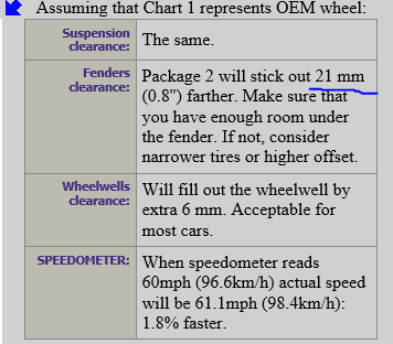

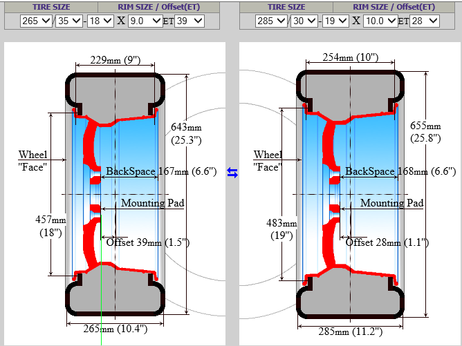

Are you sure they would fit? It says in the tire/offset calculator that the tire would be sticking out 21mm more then stock, I have heard people on the forums with the 9.5" sl65 wheels that they are rubbing with 285s on the back with a 31 offset that = only a 17mm more sticking out then stock. so if these tires stick out 21mm more then stock I assume they would rub, I tried 275 on the 10" rims on the calculator and it said they would only stick out 15mm. Also would the front wheels rub when u steer the wheels, the tire calculator said they will stick out 10mm more to the fenders then stock.
Anyways here is a screenshot of both the front and rear wheels that I am looking to buy in the tire/offset calculator, I put stock rims in first one then the sl65 wheels in the second one, Package 2= sl65 rims .

Front Wheels
Rear Wheels
