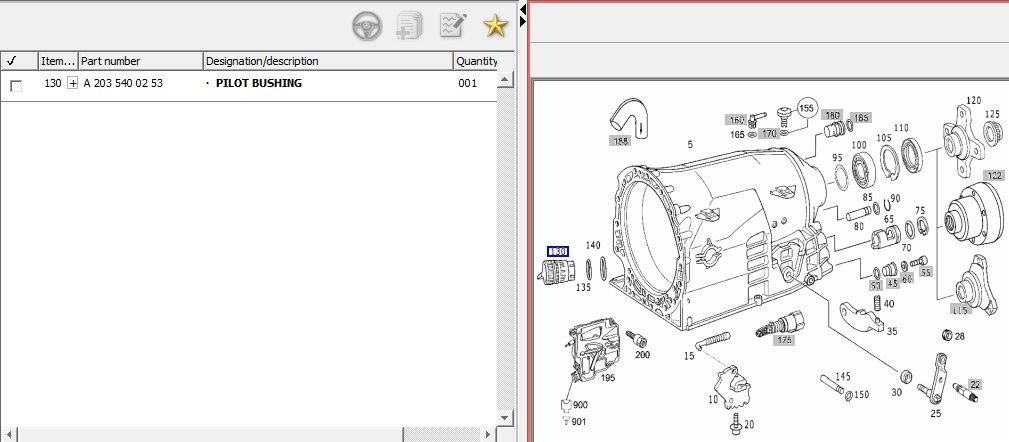

Any idea what the MB part number is for it? I know the Jeep number is 68021352AA.

Here you go.

I see that the o-rings are listed as separate items on the exploded diagram. Any idea if the pilot bushing comes with the orings?
Edit - Nevermind. Online searching shows that the o-rings do come with it.

Yep. A 6-point 7mm socket and some patience should make for an easy job. I have a few bottles of Shell 134 left over from my drain and fill if you need fluid for the job.
