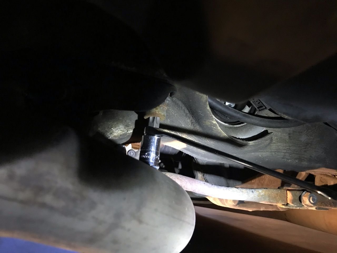

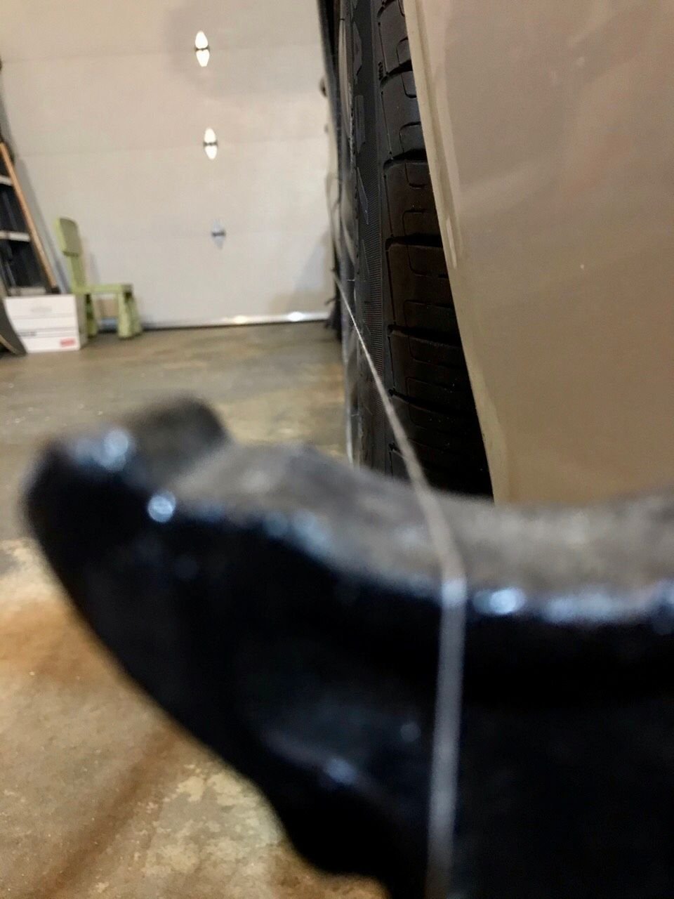

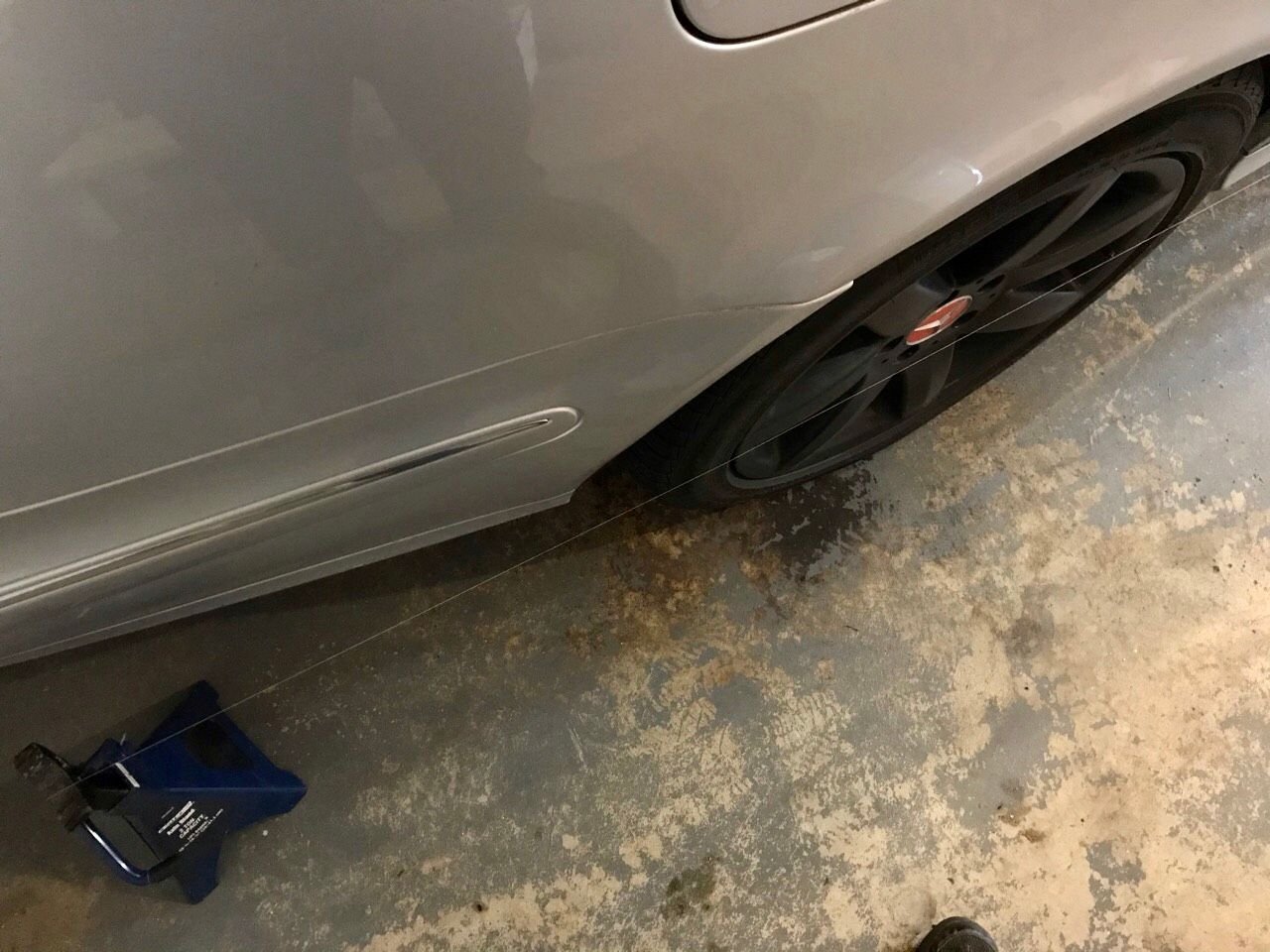

My W211 is 2008 E550 4Matic, I just adjusted the rear toe, her are some pictures:

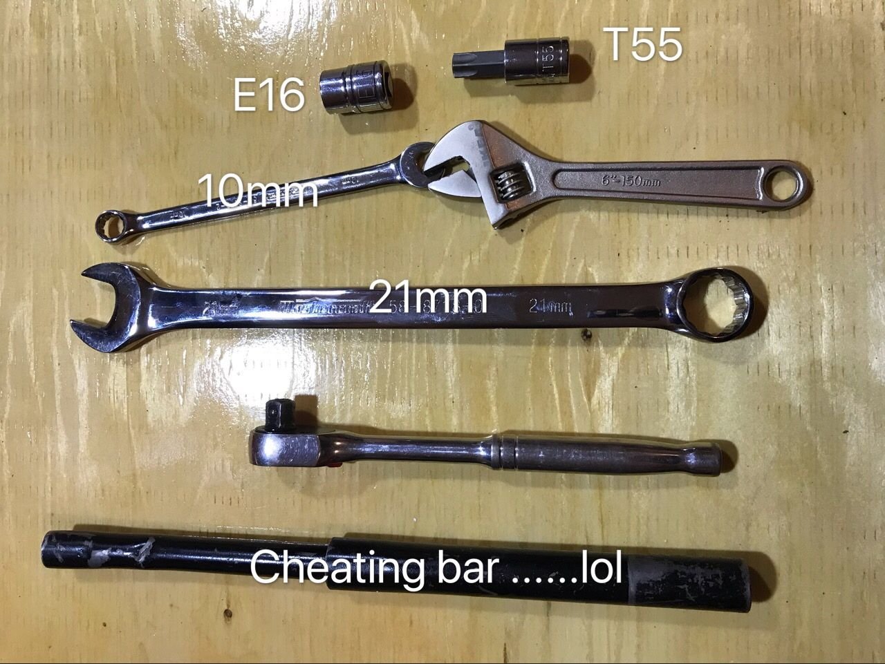

Firstly, I used old school way to aligning the wheels. Here are the steps I used:
1. Loose E16 and T55 screws, remember, just half turn is enough, do NOT take off screws.
2. Turn 21mm retch and you will find the arm slides in or out.
3. Tight E16 and check alignment, if not ok, loose E16 and repeat 2-3 again.
4. Tight T55, done.
BTW, there is not much space for T55, so I used a 10mm retch to play it.
So easy, right?
hope helpful, lastly forgive my poor English.
