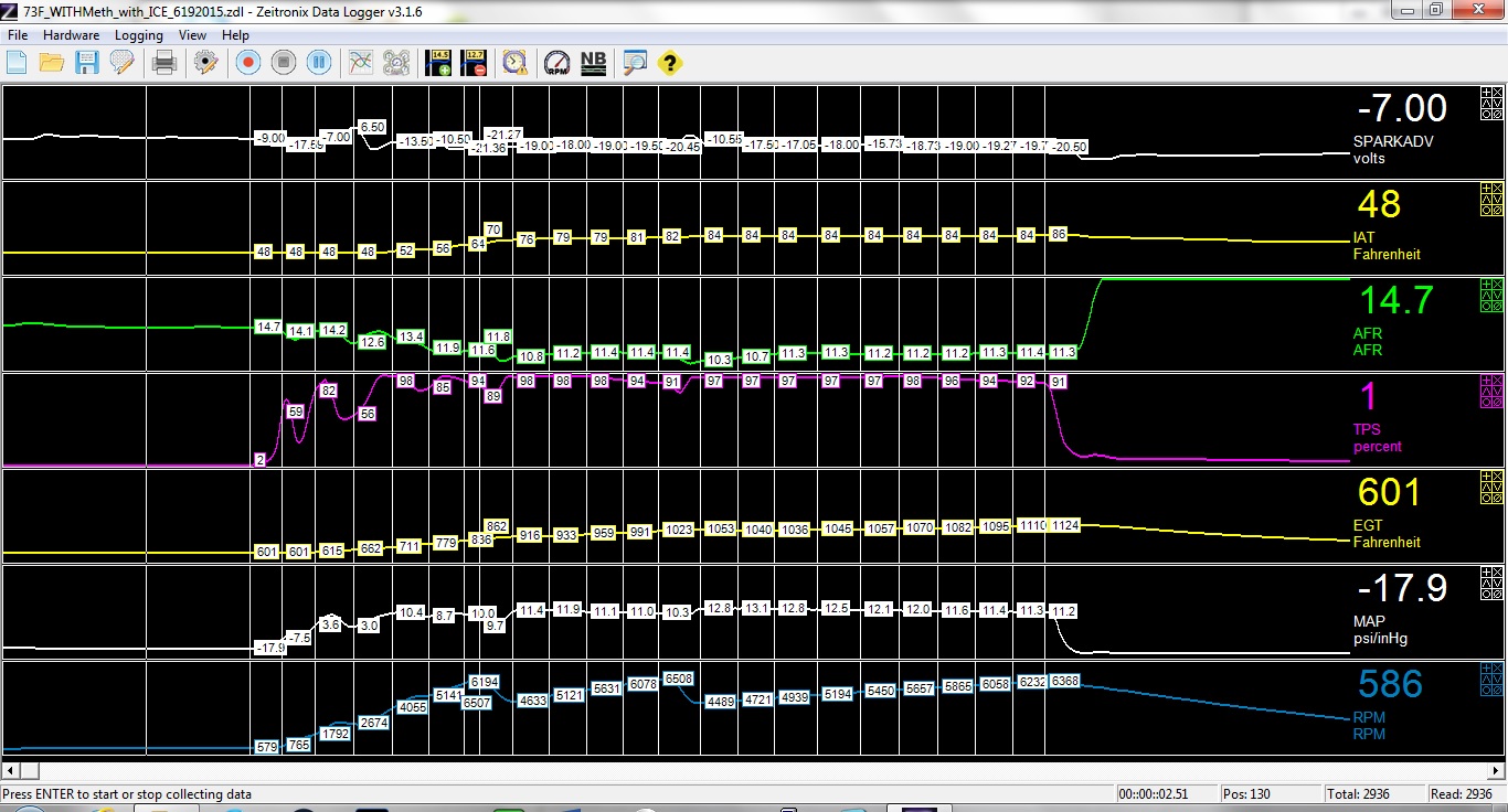

Looks like the meth is doing its job here. I'm seeing nearly the same results every pass with the meth, at the top of third its holding IAT's about 10-15F over ambient.

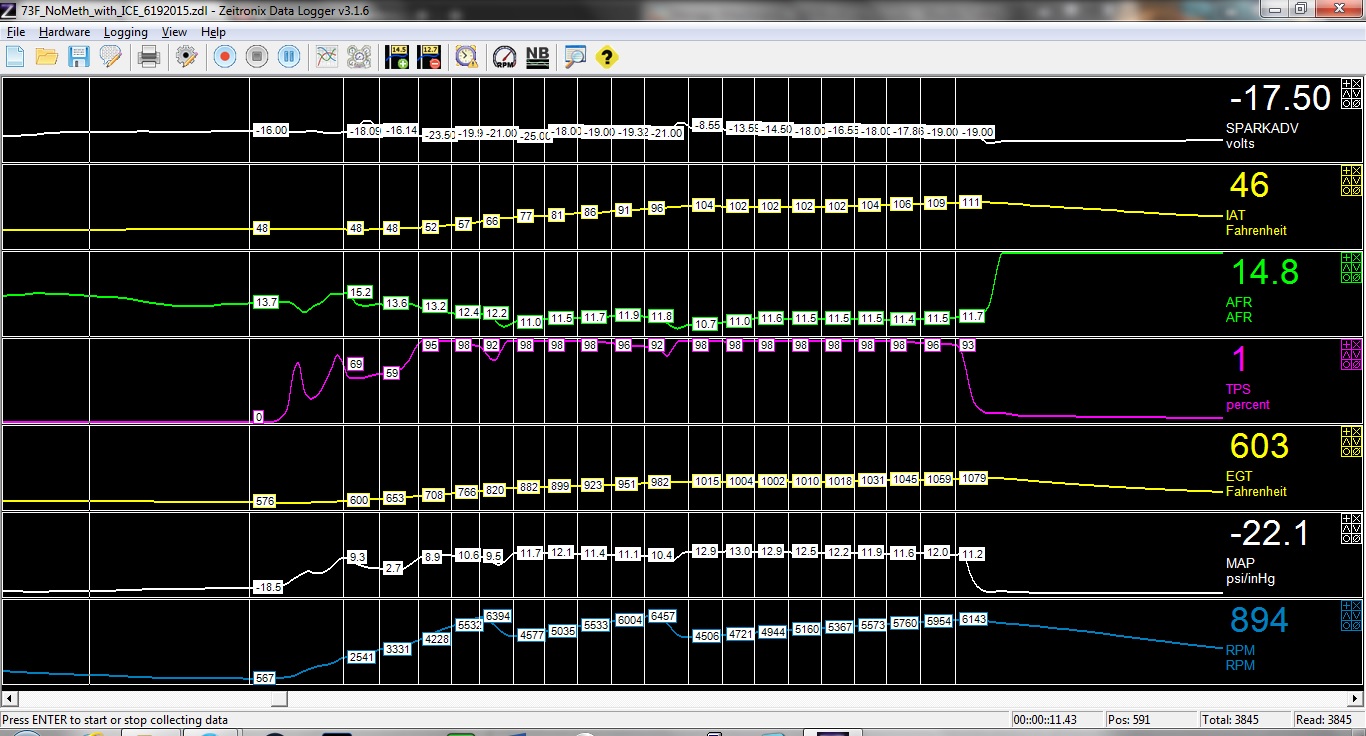

Also attached is a log on the same day, about an hour before the meth pass, this with just ice in the tank, no meth.
It will be nice to see what the real results end up being when I go to the track again soon.
So far so good, I'm happy with it thus far.
