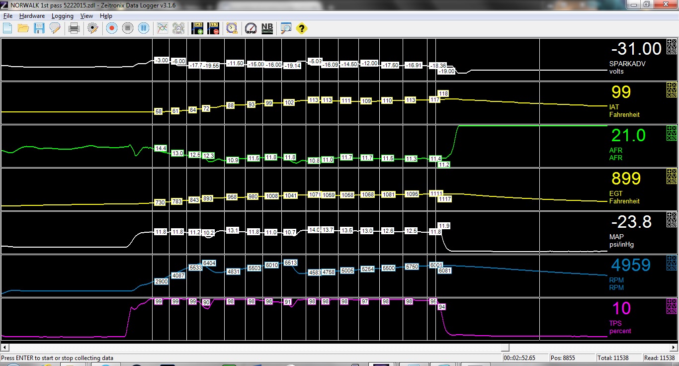

Keep in mind these are initial logs without the Aquamist controller being fine tuned, but so far so good! Really happy with the results thus far, though I am surprised that the EGT's are a touch higher (~50F-100F)than I am used to seeing. Anyone smarter than I able to chime in as to why that is?

nice act temps for this heat

I will most certainly get it. Those logs look nice. Care to share how you're setup?

Those iats are nice, how long was your pull? What size and where are your nozzles positioned?

Can we see a log from a dead stop, then full throttle all the way through the end of 2nd gear?

Single .7mm Aquamist ~300cc, per Hulk's recommendation, placed directly after the IC; AKA Sneakyneon location.
Actually this is from a stop, though not full throttle in first. I turned onto an open road and noticed no one was around so hit the log button on the dashdaq and floored it. The log shows second and third gear.
I will be taking more logs, this happened to be the first opportunity I've had to take a real log since getting the car back.

What was the outside temp (approx) when you ran this first log? Looks like your setup is working better than mine...if the IAT numbers are true and not spraying directly on the sensor. No matter what I tried, I only saw a max. of 30F cooling; meaning that with the system off, If I hit 160F at the end of a 1/4 mile pull, meth on I would see 130F instead. 130F off, would mean 100F on, etc...
So, try logging a pull with meth off, then on, and see what the results really are. Holding 95F doesn't mean much without comparing the value to something.
There are a lot of exaggerated claims about what meth can do for our IAT's.

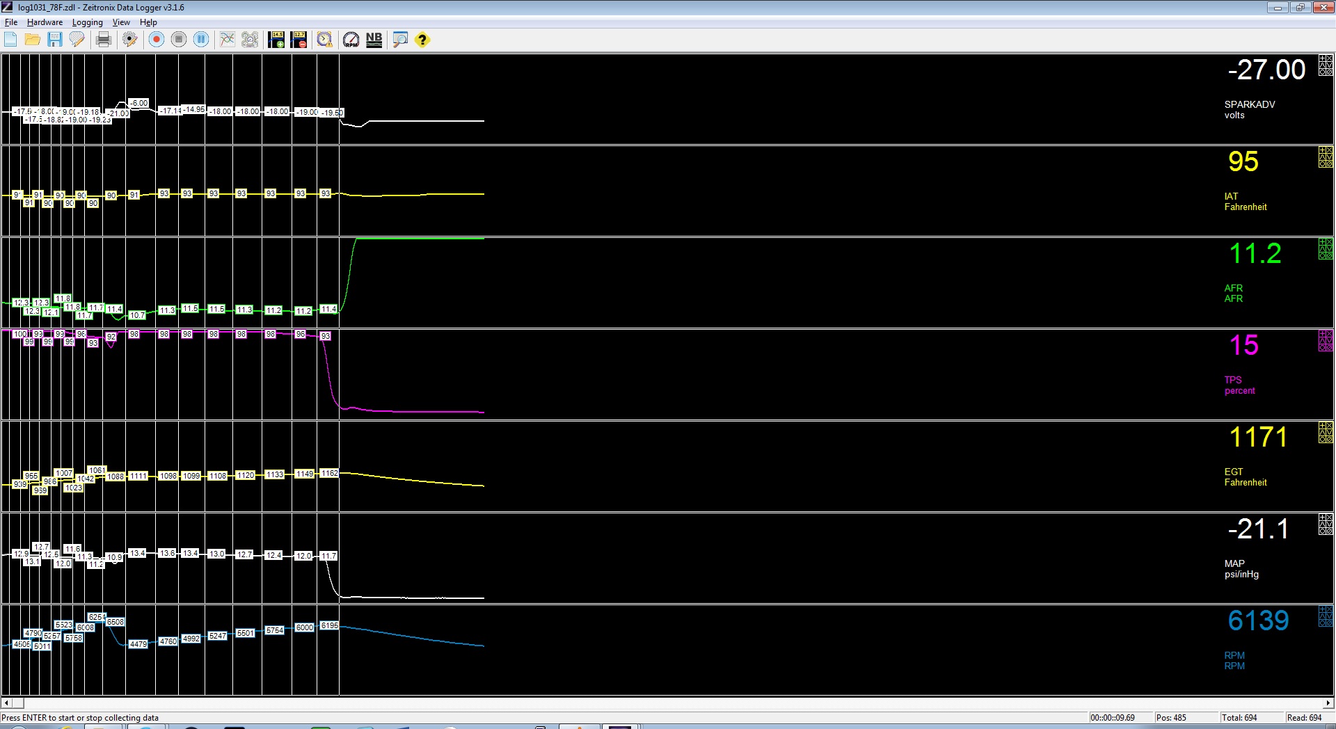

78F. Heres a log from a month ago without the methanol. Ambient temps were cooler, around 65F. I know it isn't quite apples to apples of course being different days etc. I did have ice in the trunk tank as IATs were below ambient at the start of the pass. Notice how the timing isn't as level as it was with the methanol, what that translates to in real world numbers I don't know as I wasn't on a dyno or at the track.
Once I get to the track again Ill pull some logs both with and without meth on and using ice in the tank. I may try bumping up to 50/50 at some point as well, just to see if trap speeds change at all.
Attached Thumbnails Why doesn't everyone have a methanol/water injection kit?-norwalk1stpass.jpg

Jmb, once you increase the meth% you will get a richer afr and power will go down.

Jmb, timing was all over the place on that run without water injection lol

Precisely. The car still felt really strong however, but not nearly as strong as with the methanol. It doesn't fall off up top.
