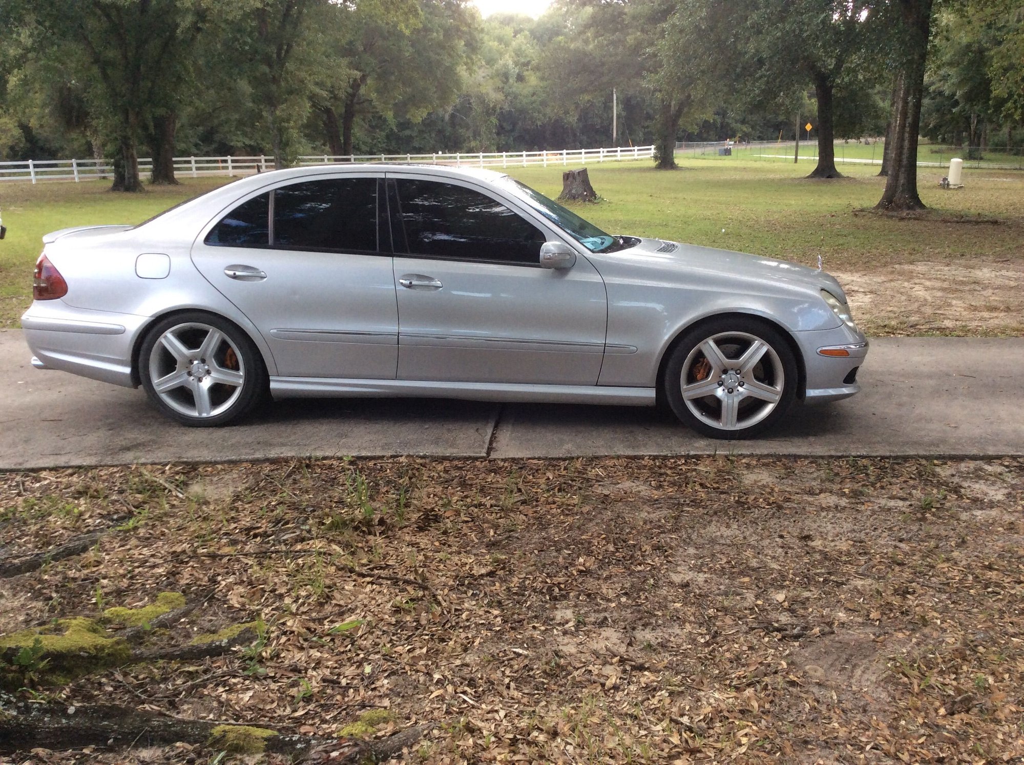

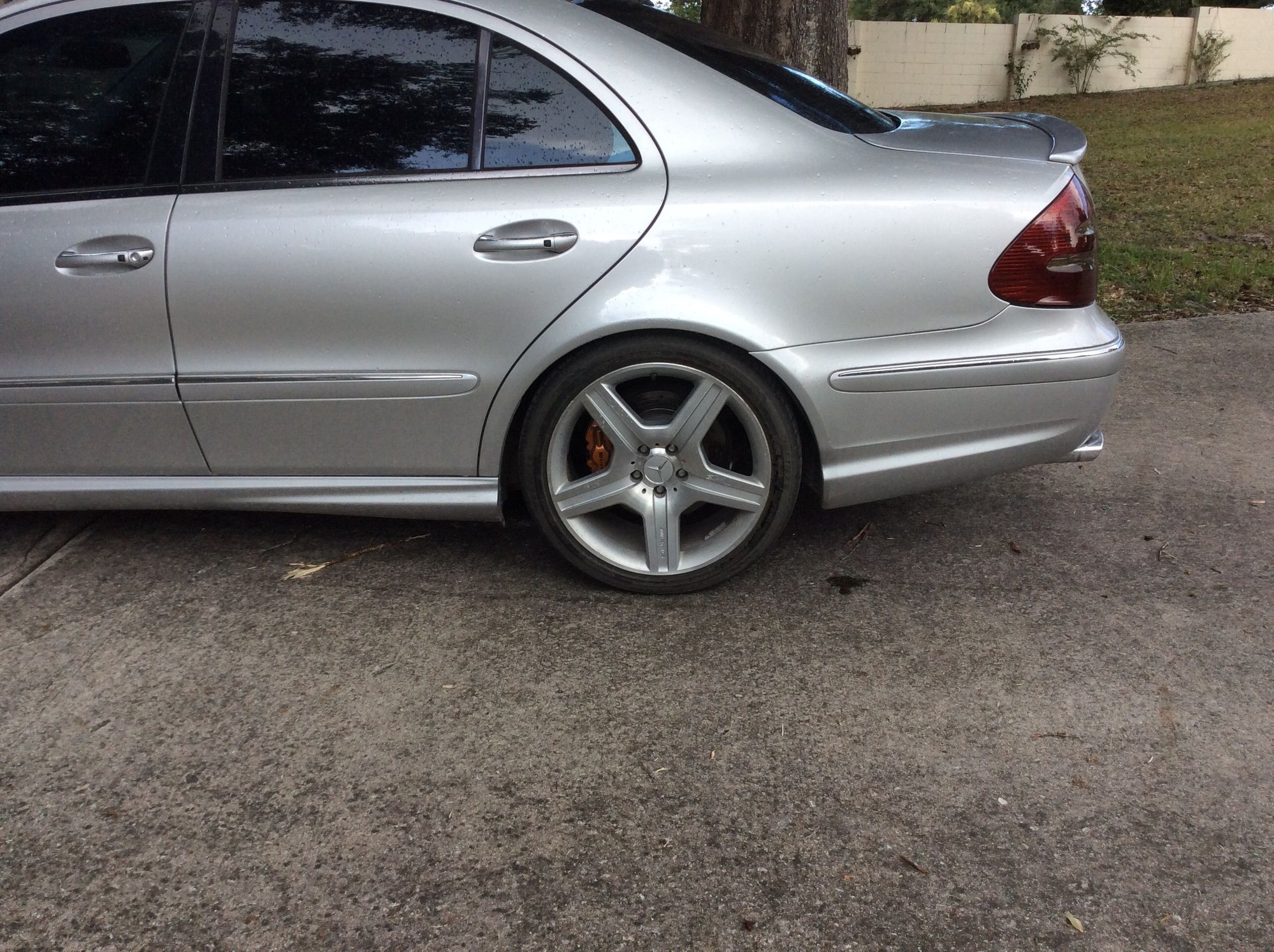

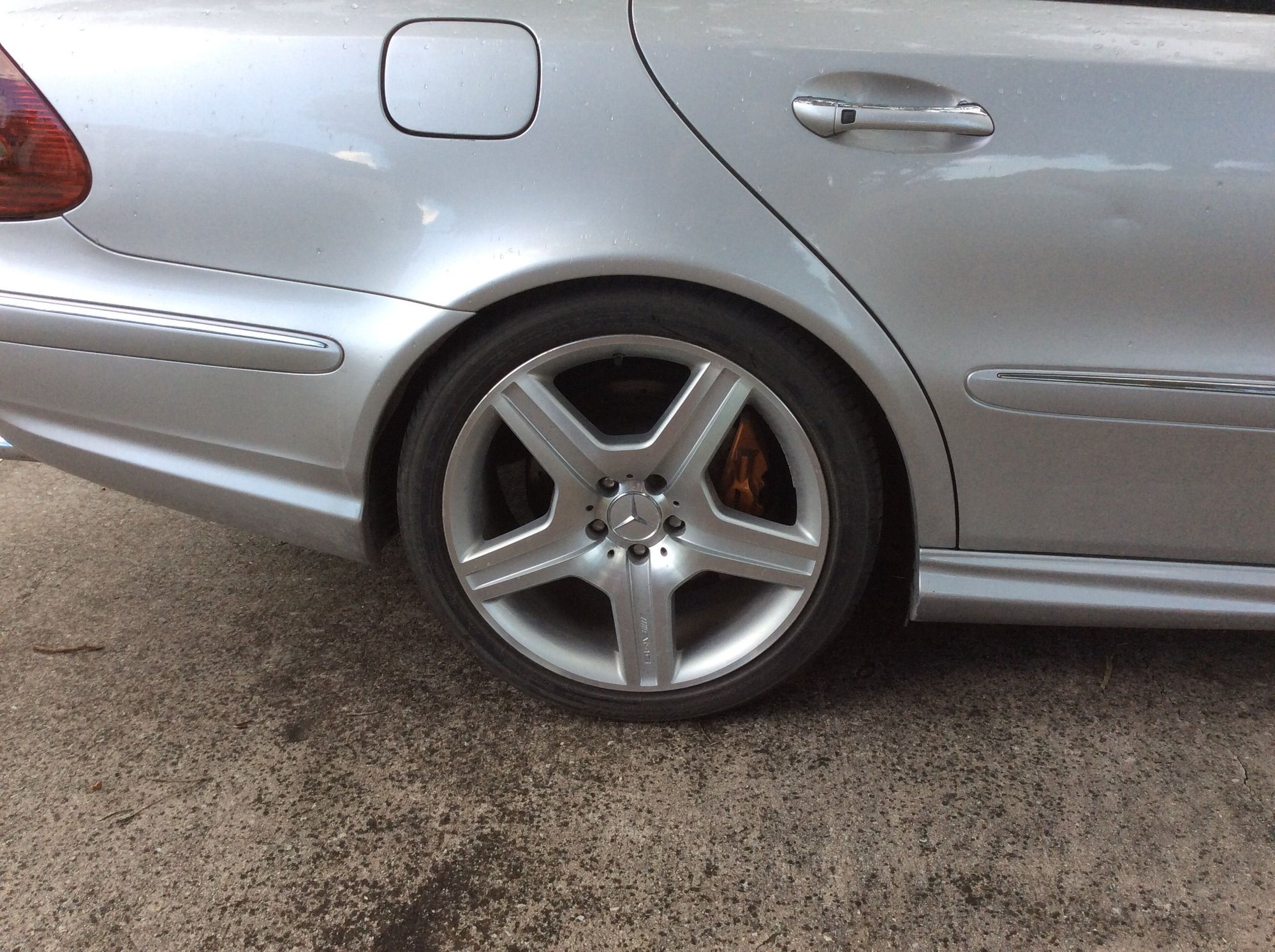

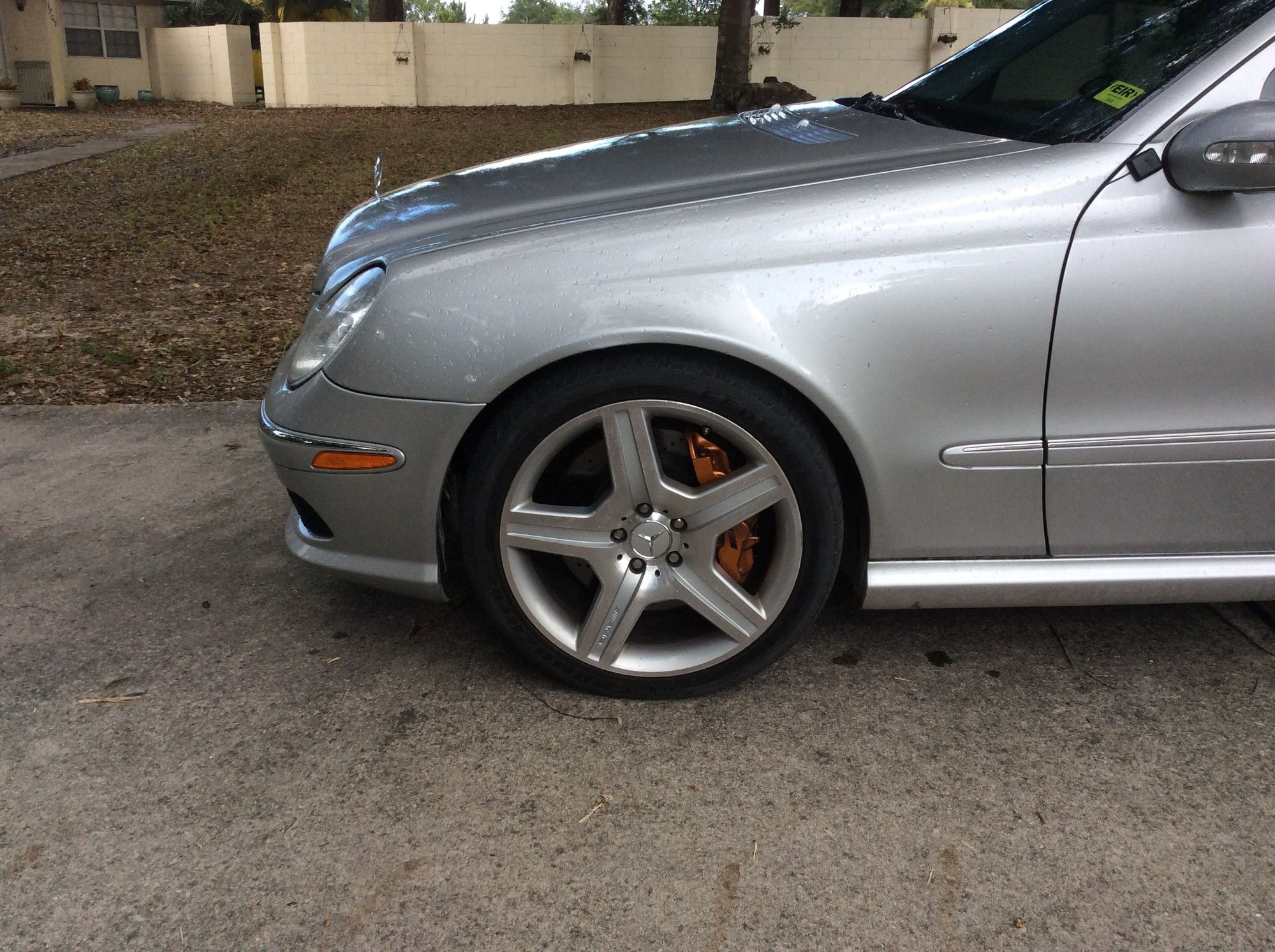

Just a few pictures of the arnott steel spring conversion

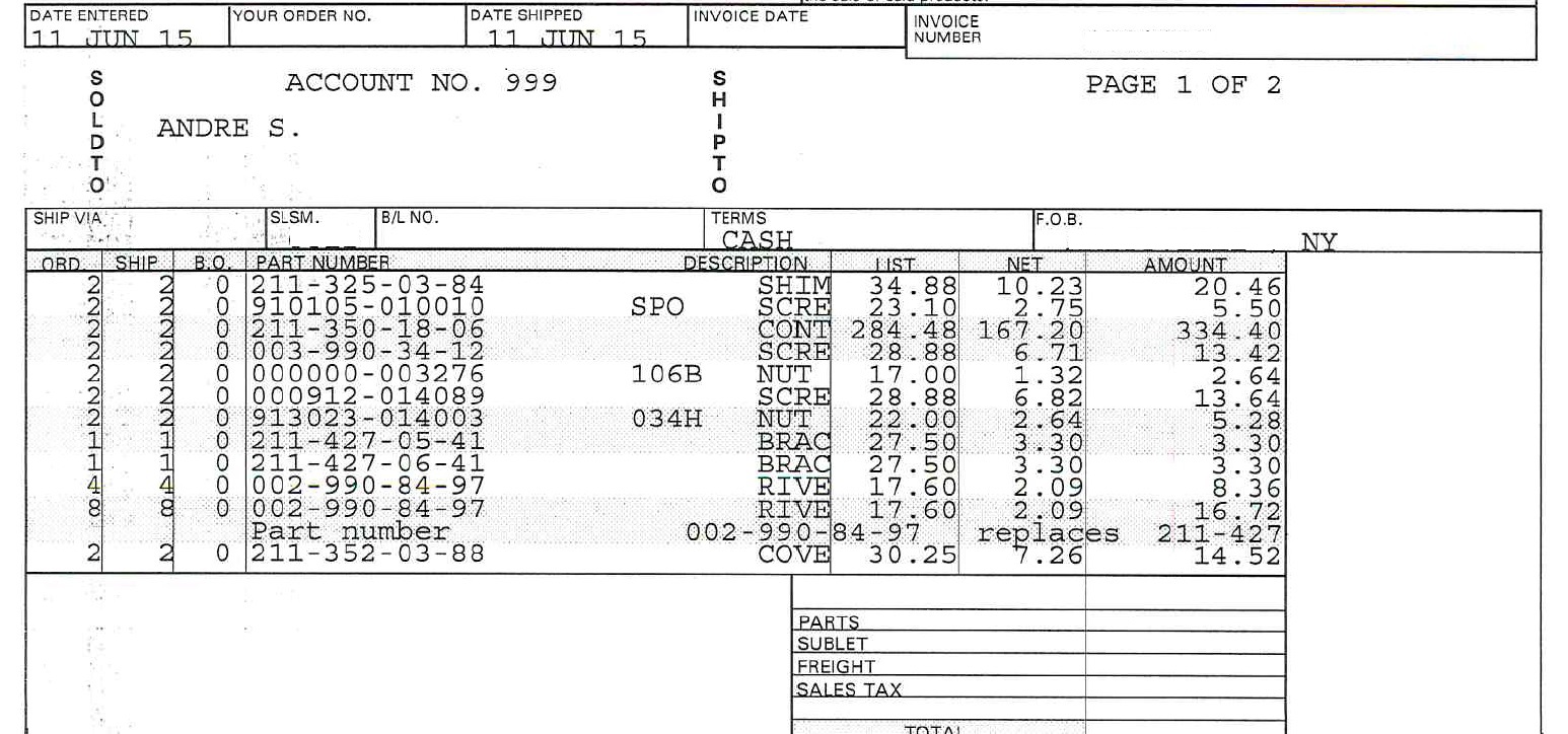

to do the job the "correct" way you need all of these

I just found used rear arms off Ebay in good shape for $90 shipped. They were from an E320. Gave those and the BC coilovers to my local indy and he installed it all. Not sure why you would need a bunch of other stuff

Couldn't seem to find anything on eBay. According to AndreNY, the P/N came up with these at Amazon for $163 each -
http://amzn.com/B0039HMBZS
Do these look like the ones I need? They don't look anything like the results on eBay that looked like "wishbones".

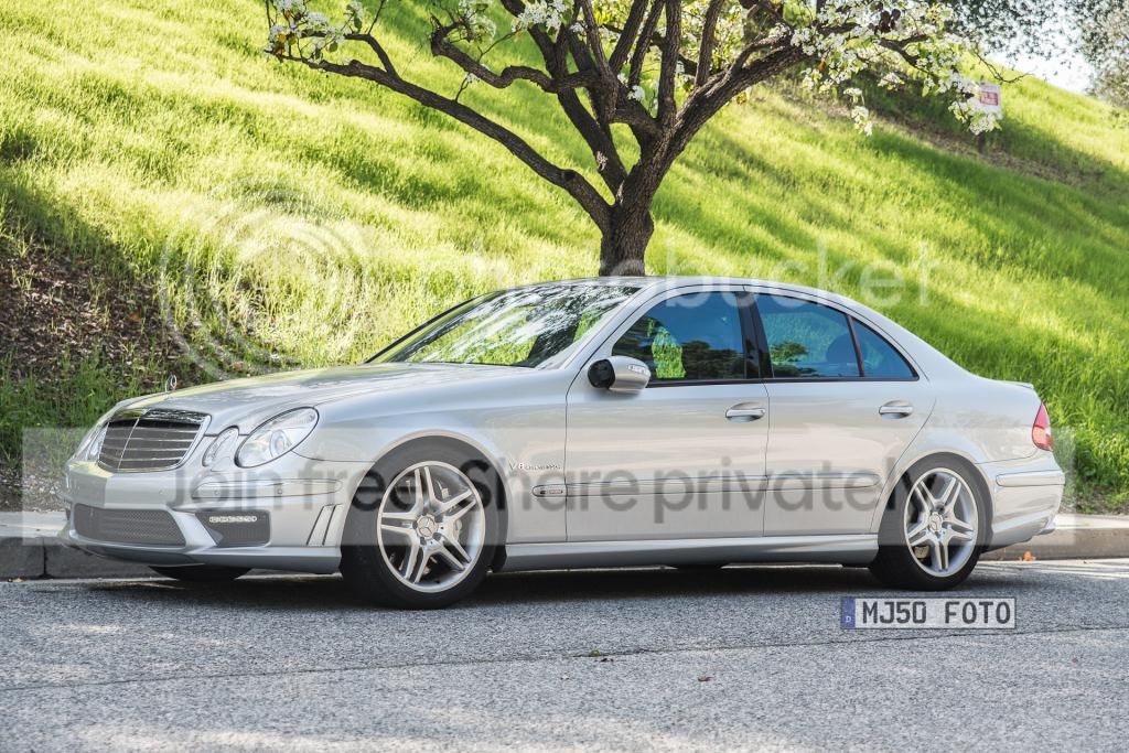

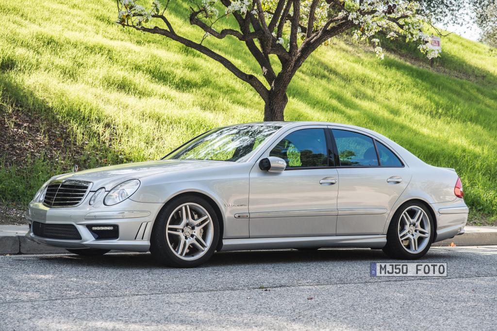

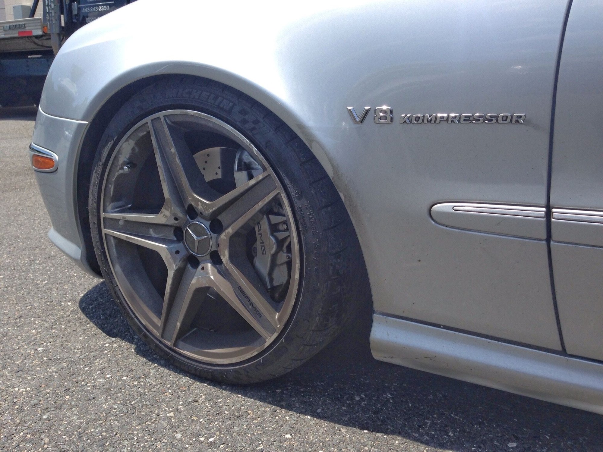

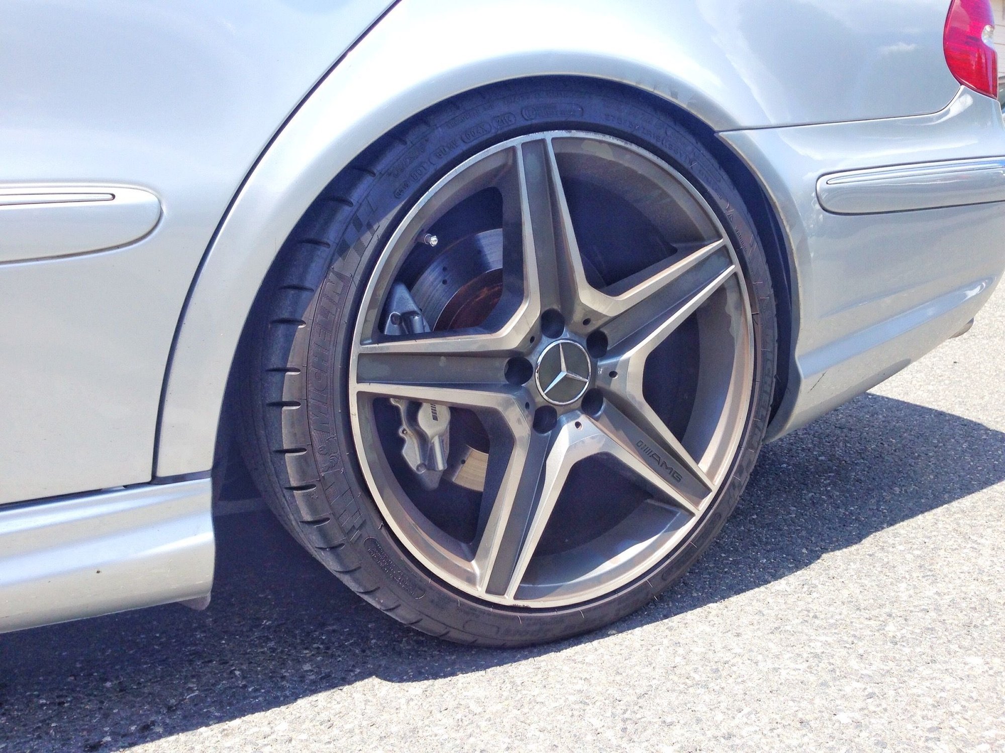

running KW V2...

Originally Posted by MJ50
running KW V2...
Looks great hyung!
