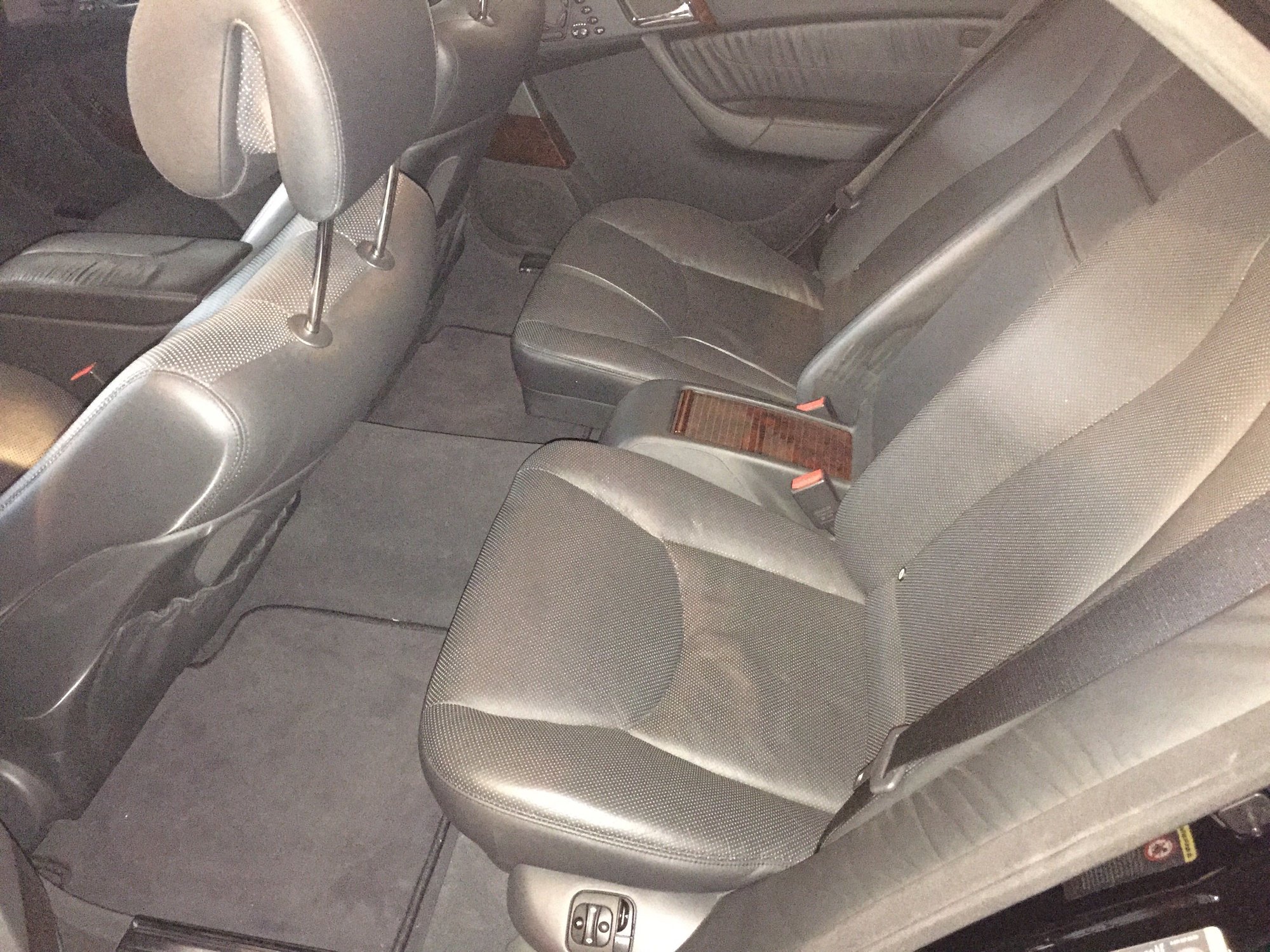

That being said, i have been toying with the idea of selling it. After buying my ml63 it doesn't get driven much and I need a new kitchen. it's a 04 sport with literally every option but designo. I've only seen one other w220 with rear buckets. The paint and interior are perfect. It will come with all my spare parts that never got used. Coil packs, abc parts, s65 cluster, etc... I have the stock wheels too. It has a Kleemann tune, bill shur trans, bigger h/e and a few other things.

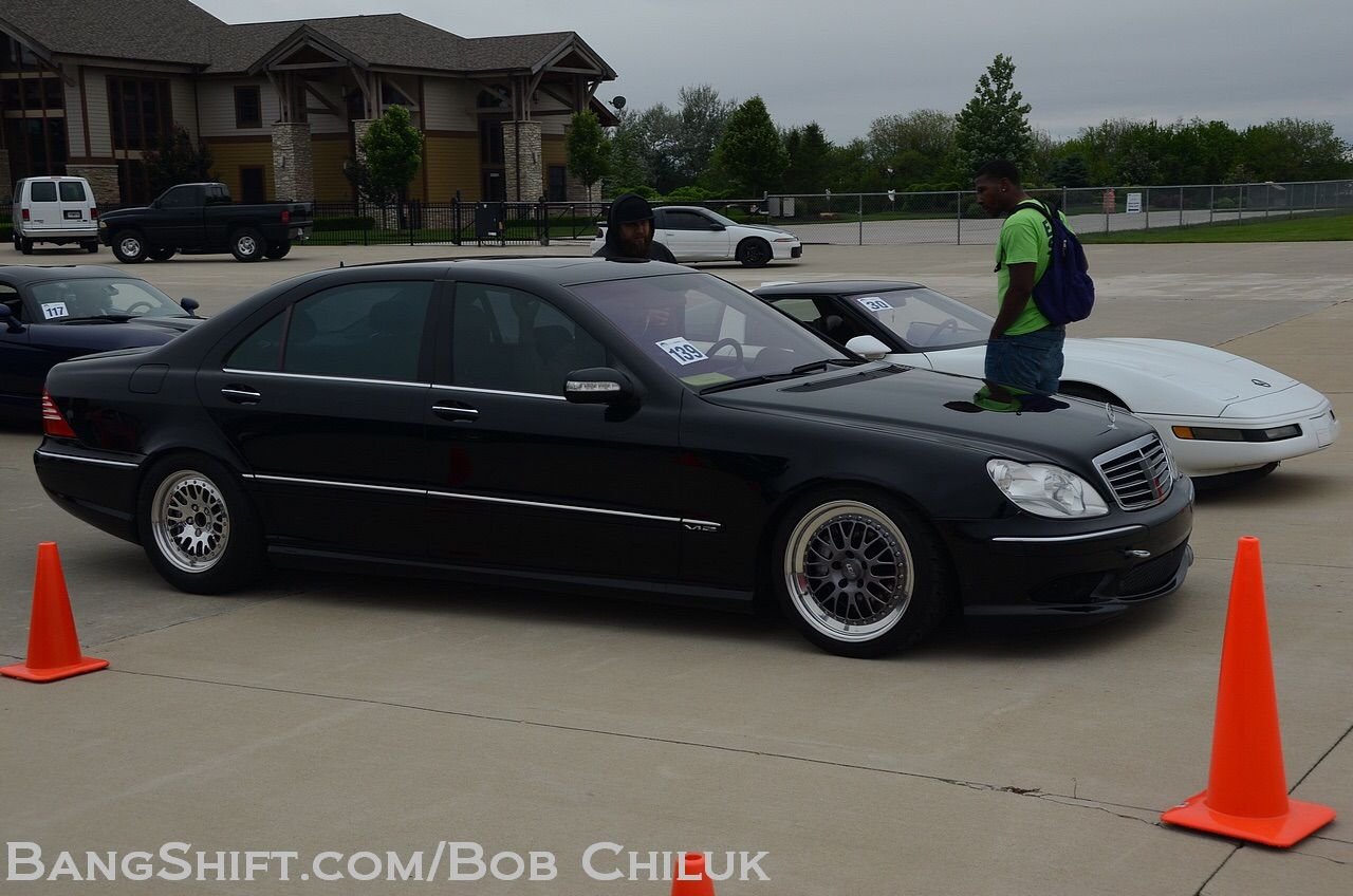

Crappy phone pic.
From 1/2 mile event. Went 149.8.
