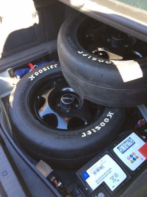

I went with the Hoosier/CLK combo after doing tons of research on this forum; it seems to be the Gold Standard for traction on our cars. The wheels are from a '98-'02 CLK, and they are forged factory units which makes them incredibly light and strong. The Hoosiers are also lighter than a comparable Mickey Thompson tire, or so I've read. I love this setup and I doubt any other single mod will lower your ET by as much.
They're easy to toss in the trunk:

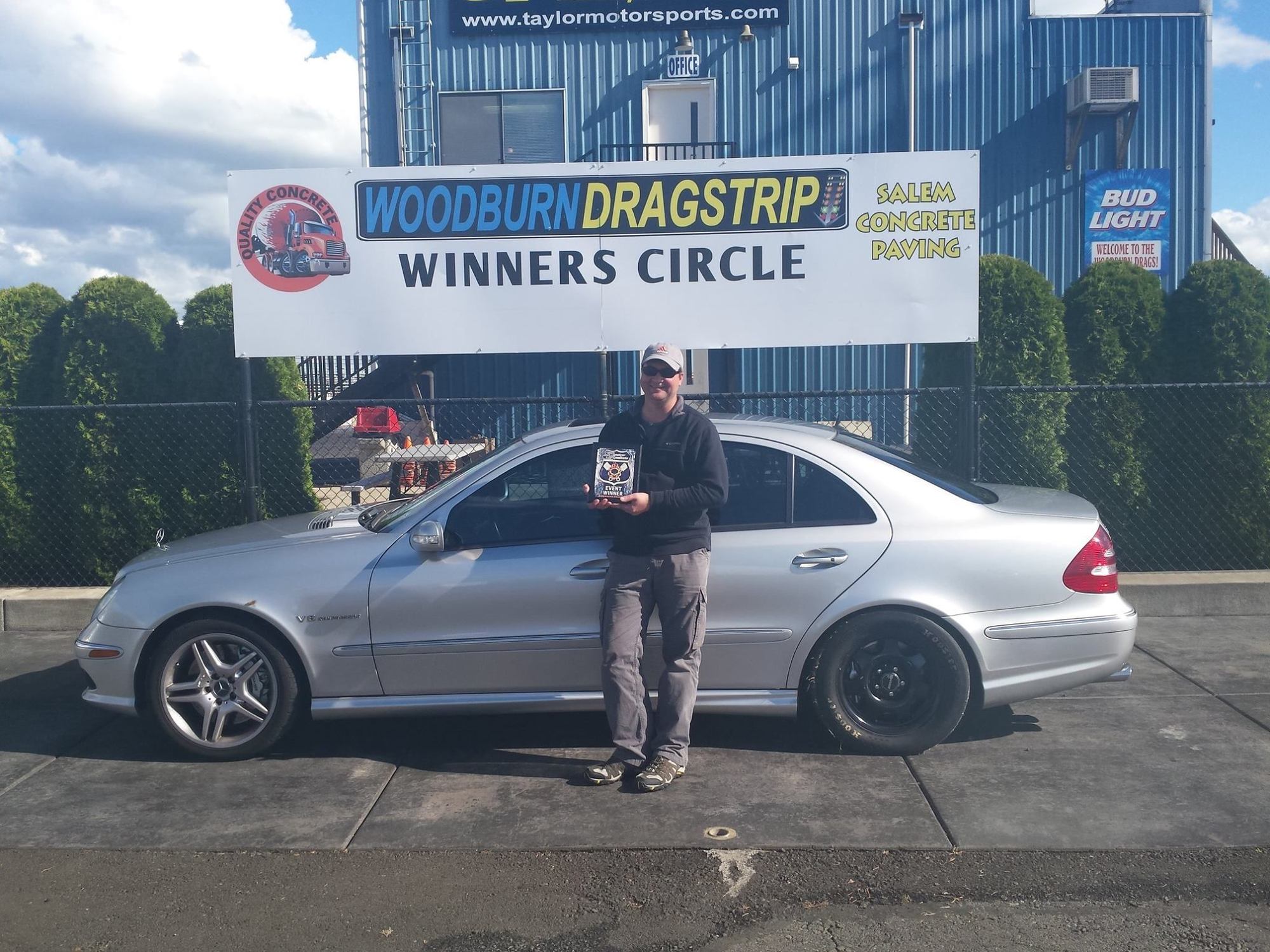

And they let you do this:
