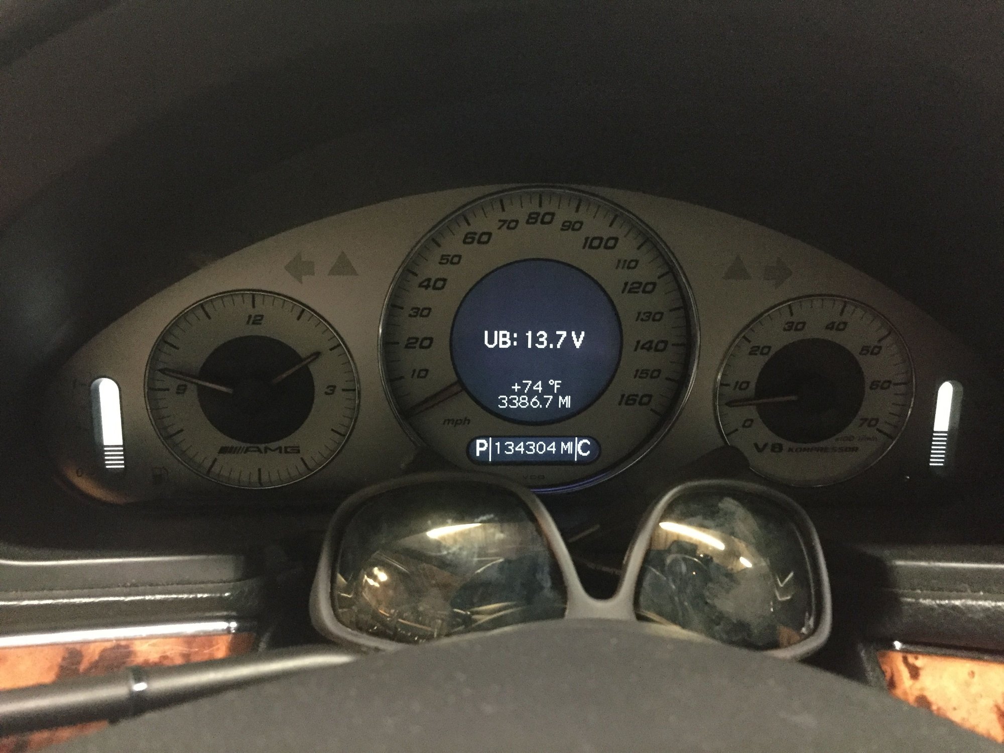

Thanks guys for helping me get here, I would have hated (and so would have my gal) going back up there 2hr 25min trip 1way to just replace the regulator and be dead in the water still. The engine bay smelled like roasted plastic after I jumped it off to get it to the shop so I am sure the Alternator ate itself.
