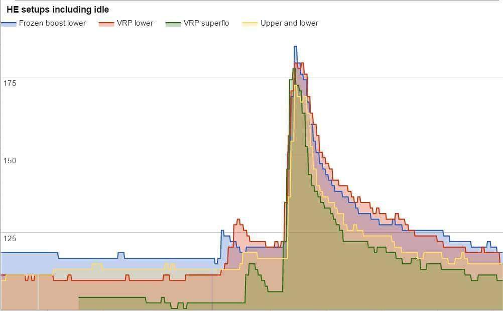

Sharduls input is always cute. Here's mapped results with different cooling components we have tested at the race track. Secondary HE works. Referred to as "upper"
