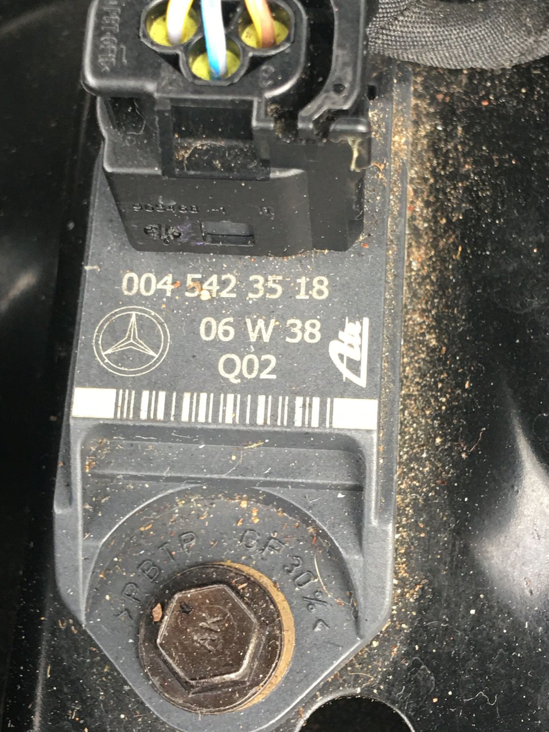

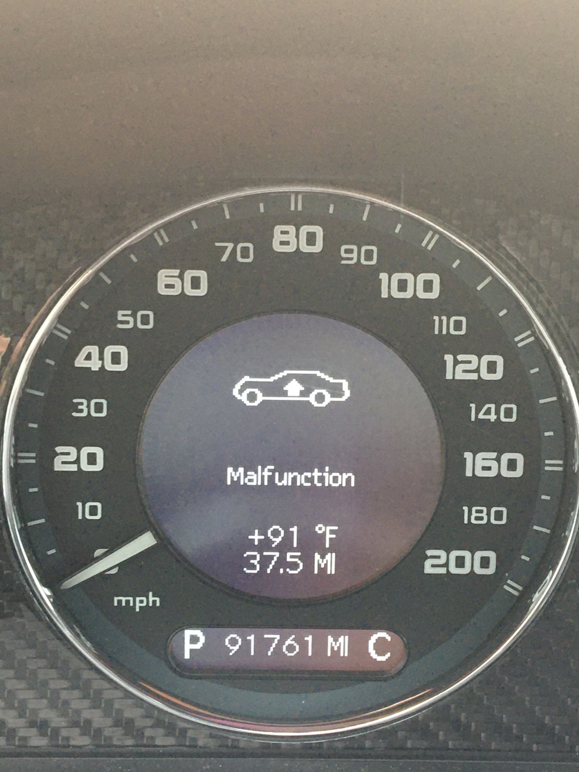

Thanks for the update, I will have this discussion with my tech on Wednesday. I’m having the windshield cowling replaced, and also diagnose this issue
This issue popped up after having my upper oil pan gasket replaced, they had to drop the entire engine subframe. We scanned this several weeks ago, and it pointed to this sensor, so my tech disconnected it and reconnected, and the problem seemed to go away, after the car was scanned. So it think that we may need to replace this sensor.
