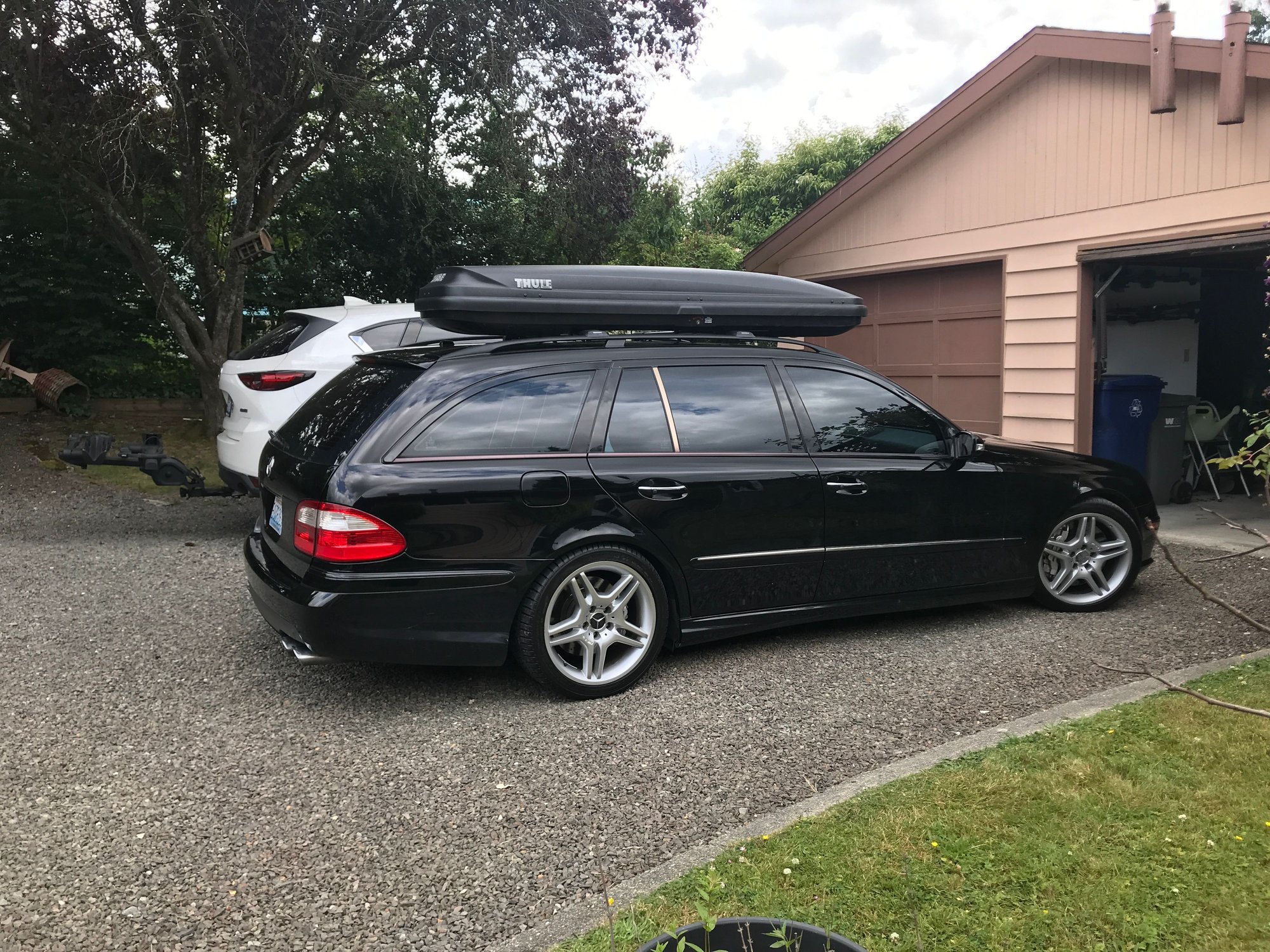

I have an 05 E55 Wagon on BC coilovers instead of the factory air suspension. Only thing is you need the control arm from a non AMG W211(same for the sedans) for the rear because the air suspension one is different. I believe I have seen recently a new company make a coilover conversion that uses the AMG rear control arm but I don't remember the name.

I didn’t install the coilovers the previous owner did. I talked to him in depth about them though. He didn’t raise any concerns about installation difficulty. Only thing that is a pin is removing all the interior trim in the trunk to adjust the damper stiffness.
the ride is still surprisingly comfortable yet sporty. It‘s not a harsh at all. I really like it. Never had any shocks bottom out or anything.
I don’t have a picture from under the car of the coilovers. But here it is as it sits

That's a great looking car!

Hmm, thanks for the answer, but unfortunately not the answer I was hoping for. Don't suppose you still have a way to contact the former owner? Also agree with the poster below. I love the wagon in black.
