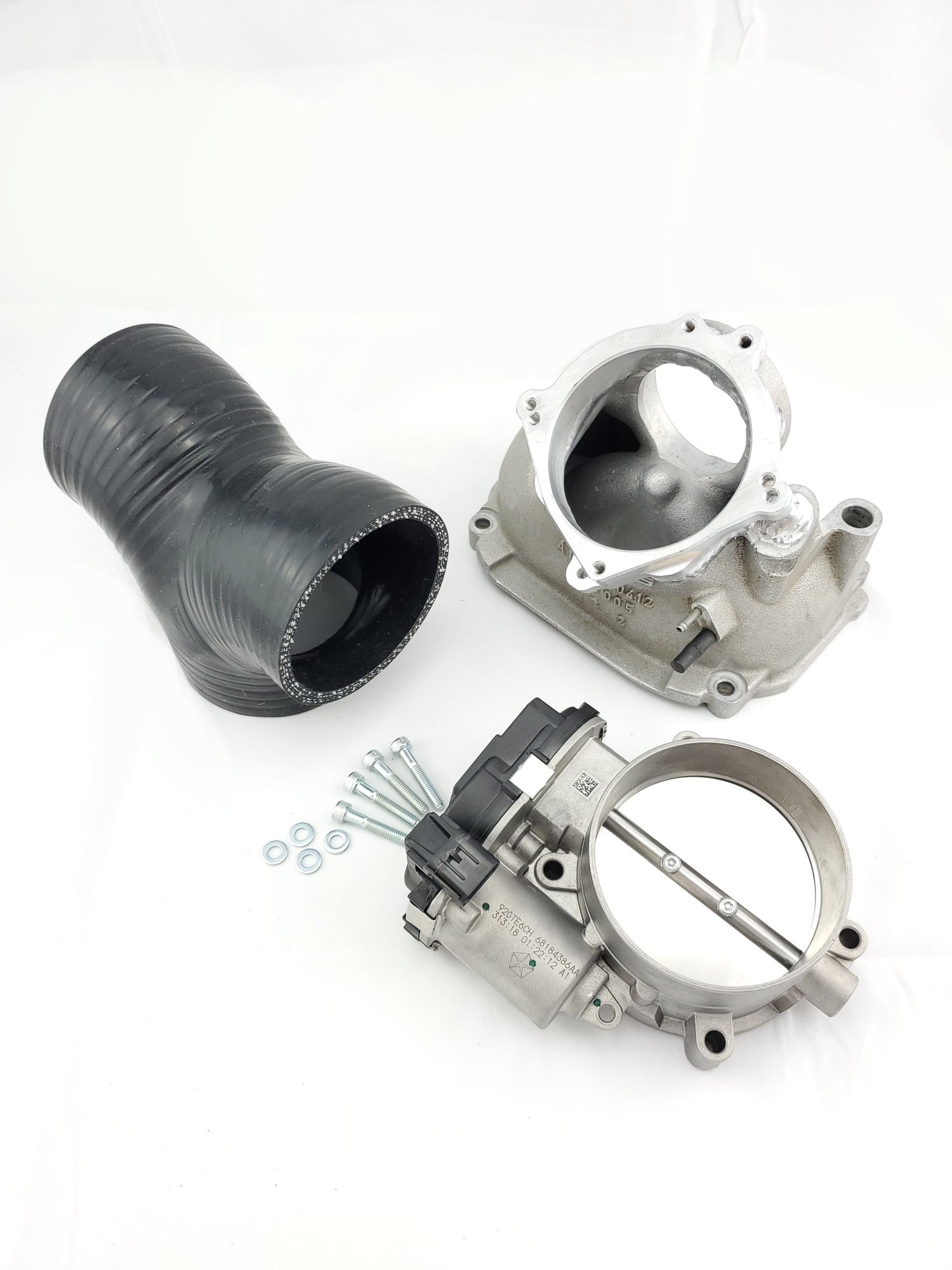

Hello from So Cal. All information is really appreciated.
Is there a 100% trouble free swap available? 90mm, 82mm? Or is the general consensus still a crap shoot? I own a few shops in So Cal, so my best tech would do the work, that eliminates any chance of mistake. I'd like to pull the trigger on this as it seems to be a bottleneck. I have MBH LTH's, meth (not tuned for it), and an 83mm pulley. I put down 520 whp and 530 ft lbs. Next up would be CNC ported heads and a cam, but I need to get air in to maximize the mod.

No, crapshoot. The 80mm is the best bet for trouble free install.

Well that’s unfortunate. I was hoping someone would chime in with a solution. I guess I’ll just buy a larger tb and snout and give it a go.

Id really like to get the throttle body issue figured out, it seems ridiculous that this is still an issue after all these years.

Weve had customers with really good results at World Motor Sports!,
Throttlebodies are not an issue when installed correctly.
There are acctually less issues with 90-92 TBs then 82mm., Our 85mm are fully rebuilt and modified 82mms.

How would one go about installing a 90-92 TB and not have issues, if I can guarantee a perfect install, what would the variable be?

Did you know there are 92mm throttlebodies available now?

Some people are skeptical on the gains you get from even just an 80mm throttle body. Is there really anything worthwhile to again between 80, 82, 90 and 92mm? Unfortunately the combining of mods makes a lot of dyno runs impossible to interpret.

With ONLY changing the throttle body I picked up ~27hp peak but the dyno curve speaks volumes more to the gains than just a peak number.

And in full transparency I now have about 212 miles since the TB upgrade and got my first P0106 code on the way home today. I didn't feel any sort of hiccup, just saw the CEL come on. I cleared the code so I may wait till traffic dies down a bit to try and see if I can replicate it. The Y-pipe was a little loose I noticed so I might have to see if I can get the connection to the TB tighter.

Sorry I was under the impression that was combined with dyno tuning. The only other evidence I have seen was 10hp gain on a dyno back to back.

Well you have to do some sort of ECU flash when doing the throttle body. I just had them spend some more time doing the tuning. The real interesting thing moreso than the peak horsepower is how the shape of the torque and horsepower curves changed. At least on my car, the engine seems to be breathing all the way to redline now instead of dropping off near 6k like all the other charts I've seen posted.

I really hope you don't have any issues with it. I would jump on it if a vendor could guarantee no side effects.

I'd keep an eye on your stft when getting that code if I were you.

The 80mm with the shaft grind picked up exactly 1lb of boost for me, pulled much harder up top and I did have to do the throttle body adaptation stuff in order to get it to drive correctly recommended by Hulk. Took a couple times and a good drive cycle but for sure if it is driven exactly in the sweet spot with very light throtlle you will feel a little throttle close or hesitation but only I can tell and it has to be driven "right there" to notice Anyone else driving will never notice it.Then there are days when it is there 1 out of 10 times so it is no bother to me with drivability.
