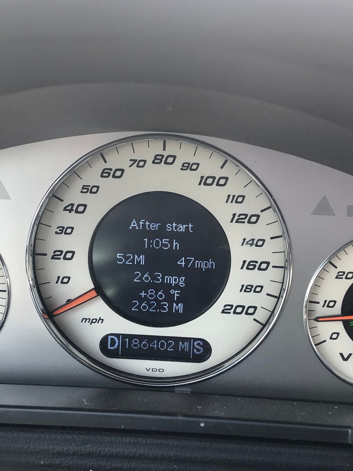

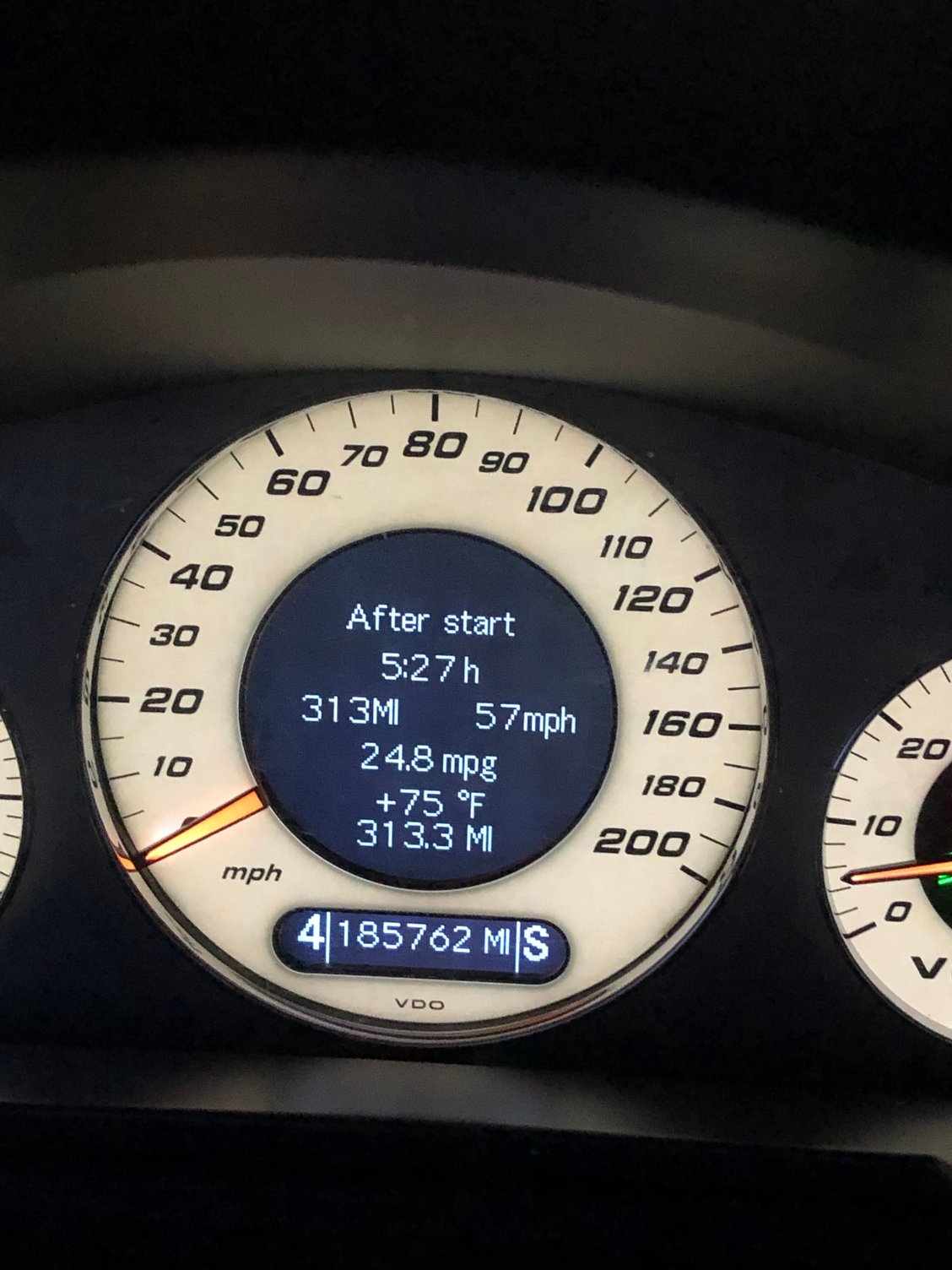

I was cruising with 26 mpg going home from the drag strip. Normal fwy driving in 80s mph I averaged 18-22 gallons. I saw a big jump on mpg from stock to mods. I have following mods: 72mm FSP, 82mm TB, LTH, x pipe no cats, 550 cc injectors, BWK, upgrade superflo ic pump, RaceIQ ECU, split cooling with bay tank. KnN filters with spacers, C63 mufflers, & Killer Chiller with Drag Kit

Do you have the stock wheel and tire size? I can't imagine this car really getting 26mpg average. Max I've gotten stock is 22mpg average on a trip.

hand calculation? You mean via dash command? I can’t recall verifying but I vaguely saw fuel average were same. If they were off I may have noticed but I can check and update.
The trip I got 26 mpg was when I was driving back home from the track with my Drag Radials setup so I was driving 65 mph.
However, there’s one 313 miles trip I made with average speed of 80-85 mph on 19” CLS63 wheels 245/35/19 & 275/30/19 I saw 24 mpg.
