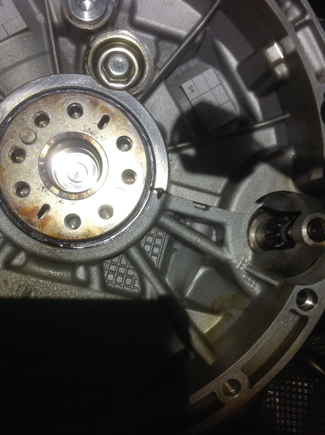

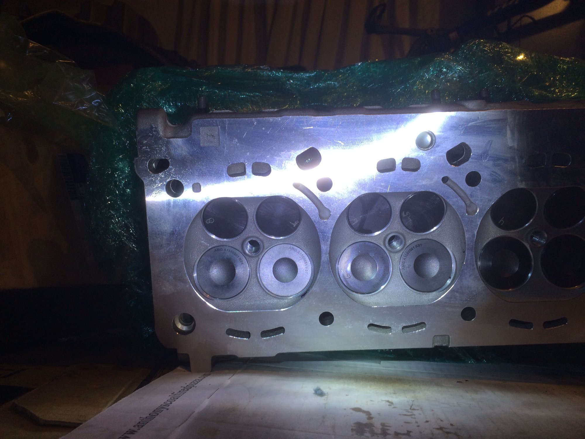

May 15, 2023 | 12:47 PM
It goes without saying, our AMG 07' E63 were $95K+ when new for a reason. I am fortunate to have a garage to do my own work and when I come across issue beyond my ability (ie-Intake Manifold, both Heads/valves, F & R AirSprings) I've removed them to have them rebuilt. In the end, its such a great ride with performance that hangs with the best of them!!!
First Stop was to have a Huge Smiley Face Gouge and the whole front end repainted.
Fresh Face!!

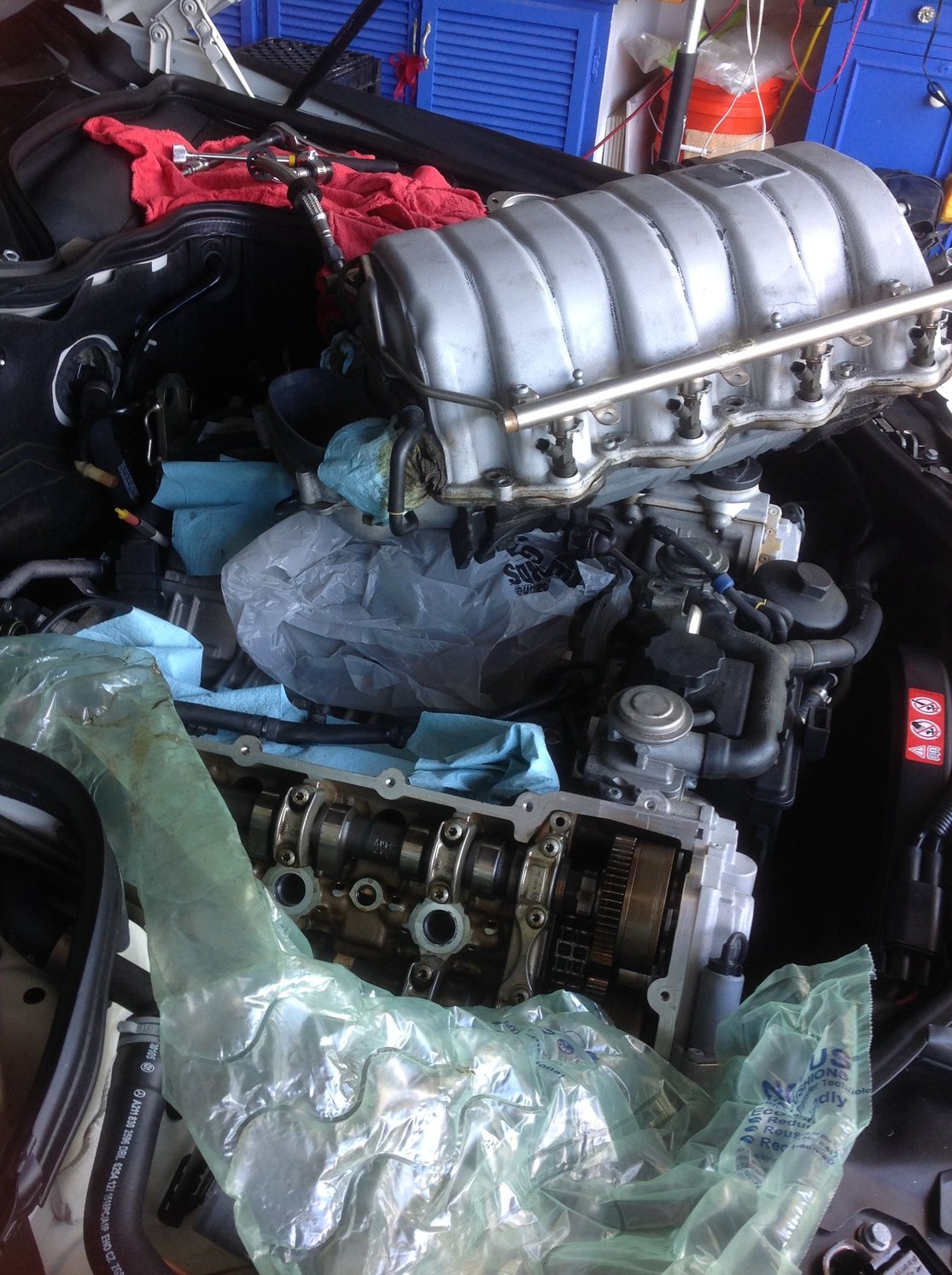

Upon getting the car home, the RPM's were hitting 1200 at idle, so out came the Intake Manifold before I even got the WIS!!
Newly Rebuilt Heads. 8 of 16 Intake Valves were bent!!
Racing Brake Rotors/Pads, still going strong!!

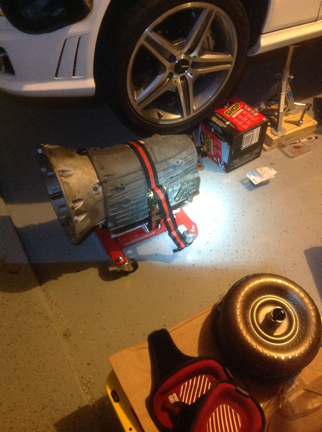

When the Rear Main blew, out came the Tranny!! I should have sent out the TCM as a preventative Measure because a month later the Speed Sensor Magnet needed repair leaving me stranded at the side of the road!!
Rear Main Seal Replaced!

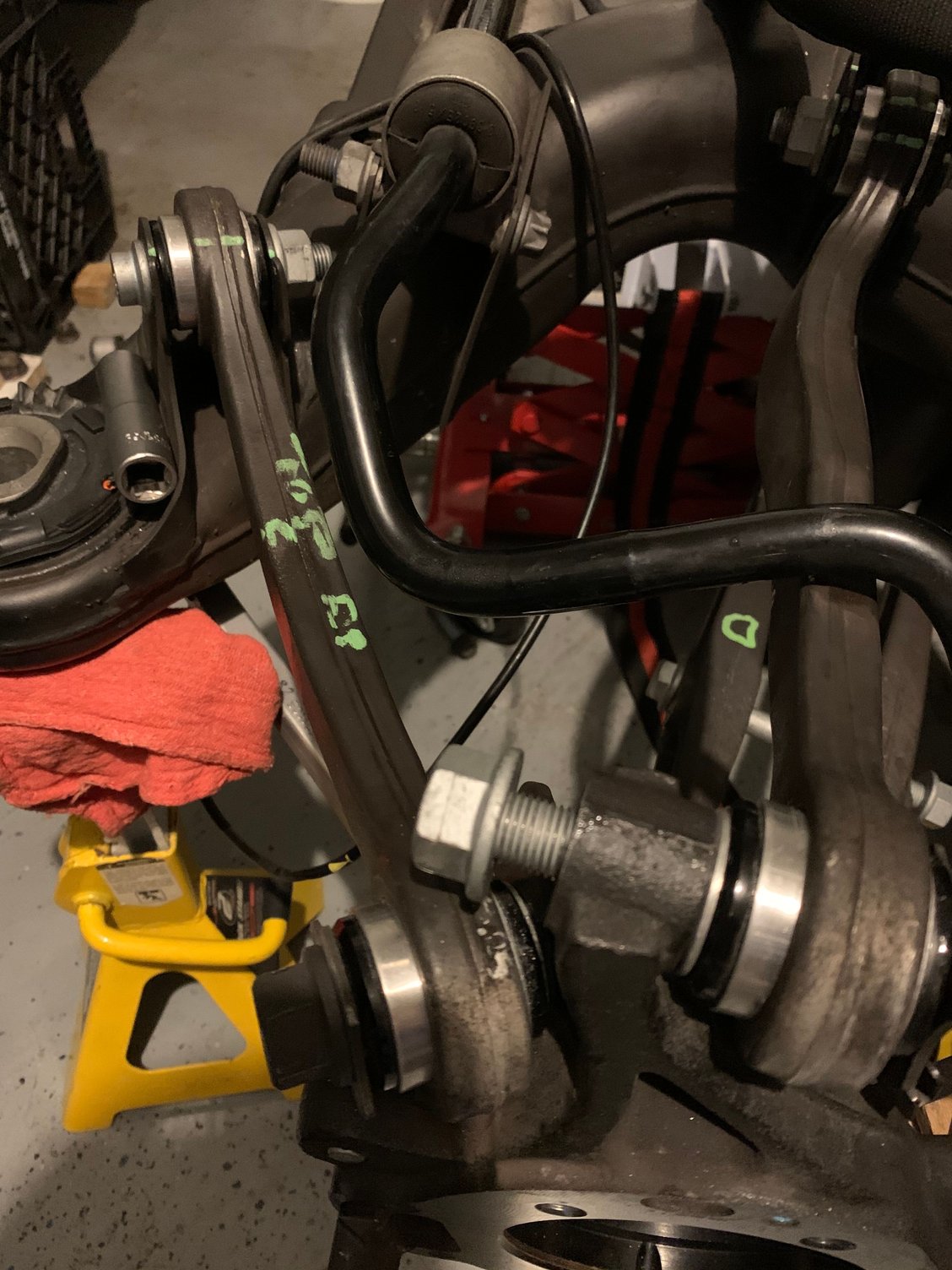

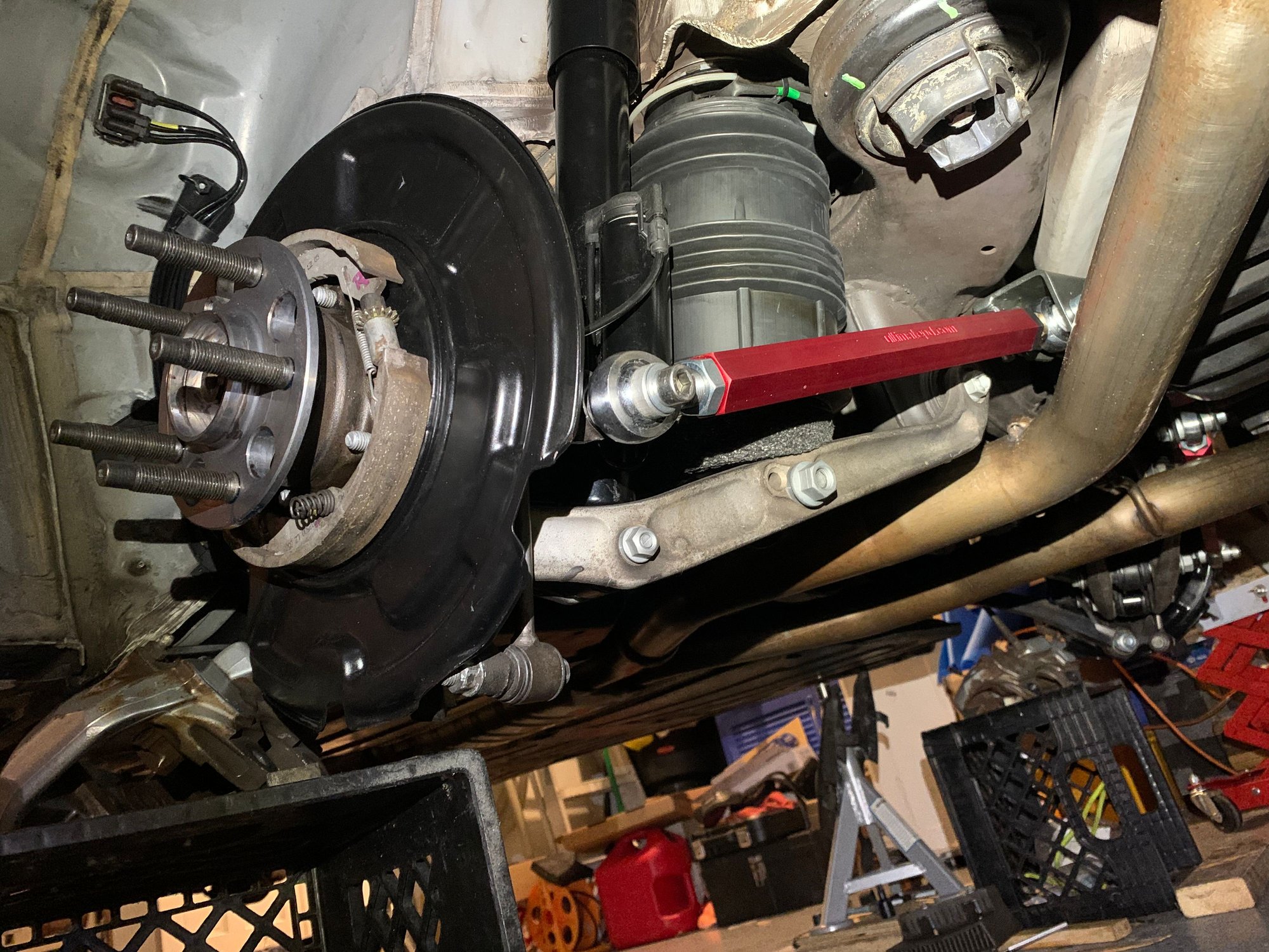

Removed the entire Subframe to replace all the Bushings for the Subframe to Car as well as those of the Arms (see shiny Poly KMAC replacement bushings), the Rear of the Differential, the front Diff Carrier to Subframe, wheel carrier to Torque Arm Bushings!!
Rear Subframe Installed with new UPD Rear Toe Arms. Notice all the alignment marks I made making sure to install those huge bushings just where they needed to be!!

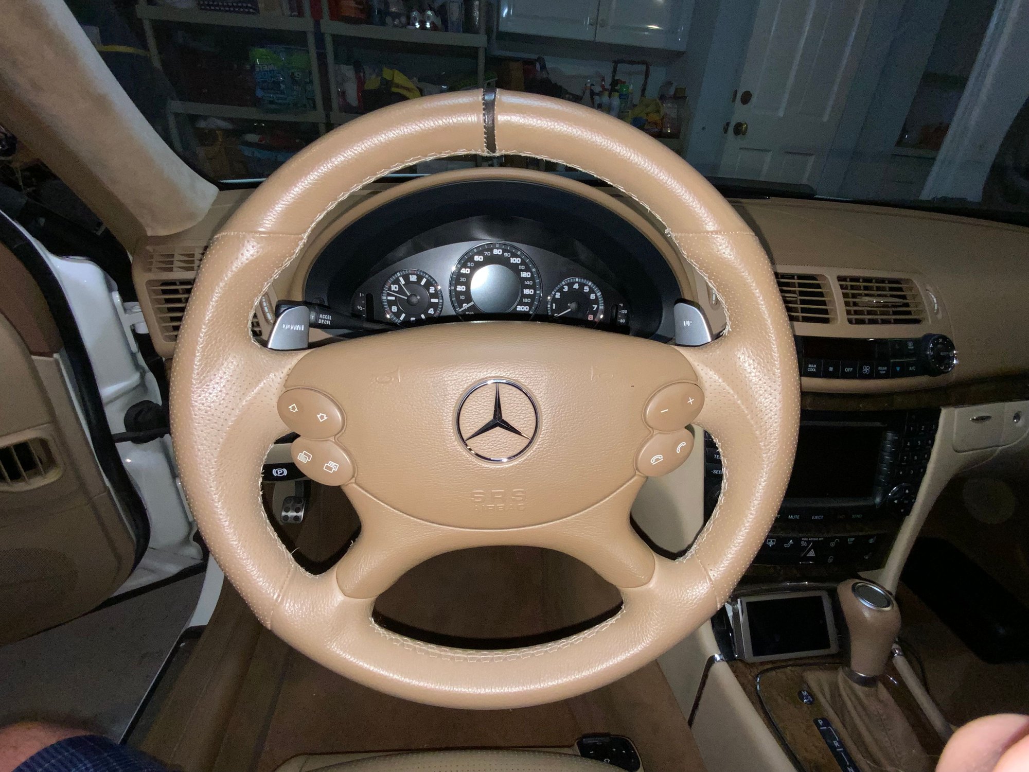

I finally got the Steering Wheel and the Gear Shift Knob redone with new leather by a local guy!!
