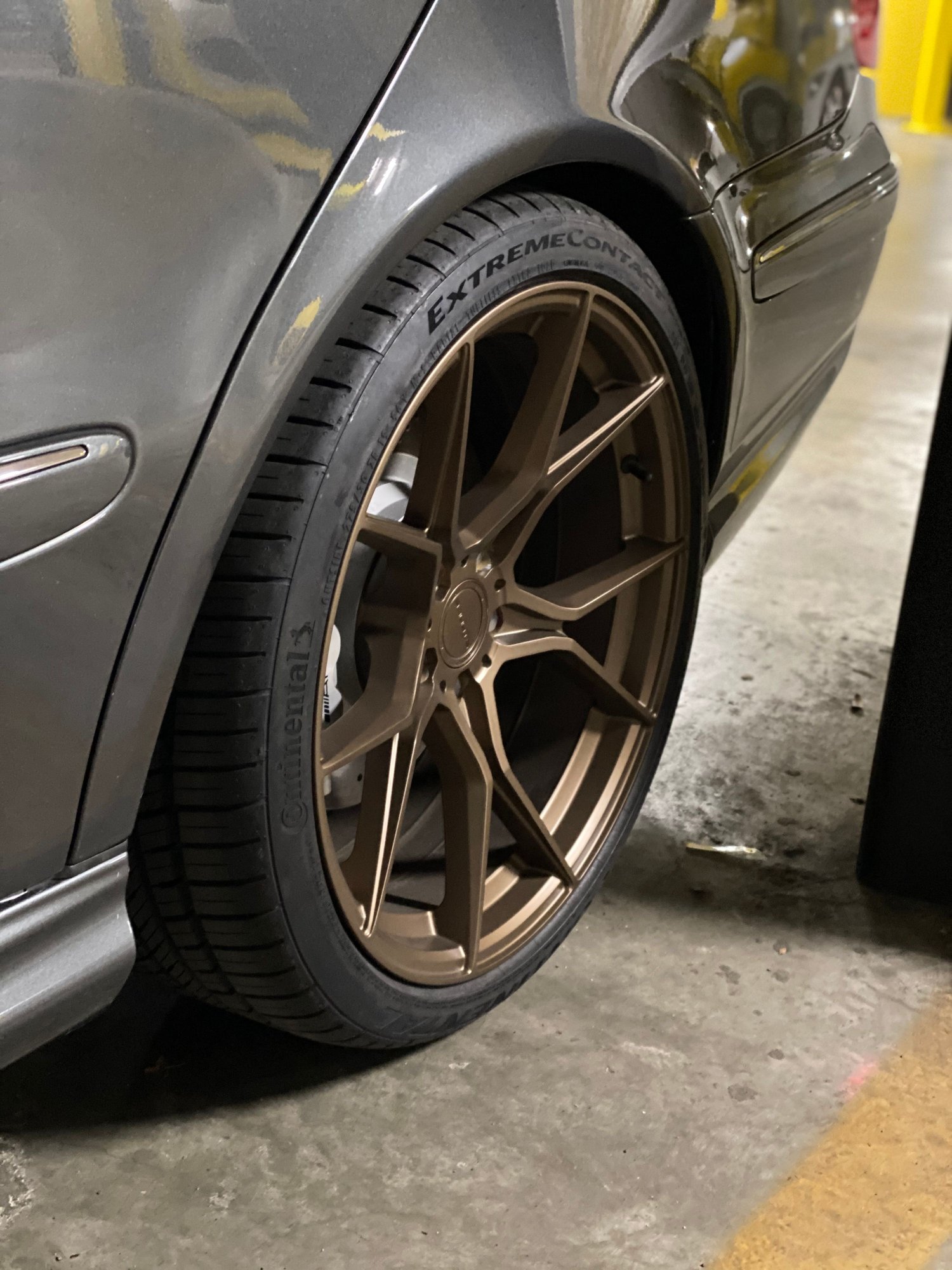

I cracked 3 in a year and ended up going with aftermarket flow formed 19s. Solid 7-8 lbs lighter than stock and should be a good bit stronger. Seems like it’s pretty common with these and the cls55 wheels. Check out the marketplace - you’ll be hard pressed to find a set without at least 2 currently cracked or repaired. Weird thing with mine was there was never a pot hole that really stuck as the cause. I’d just notice a low tire and each time a cracked wheel was the culprit

that’ll look sharp! I went w bronze in a somewhat similar style from stance
