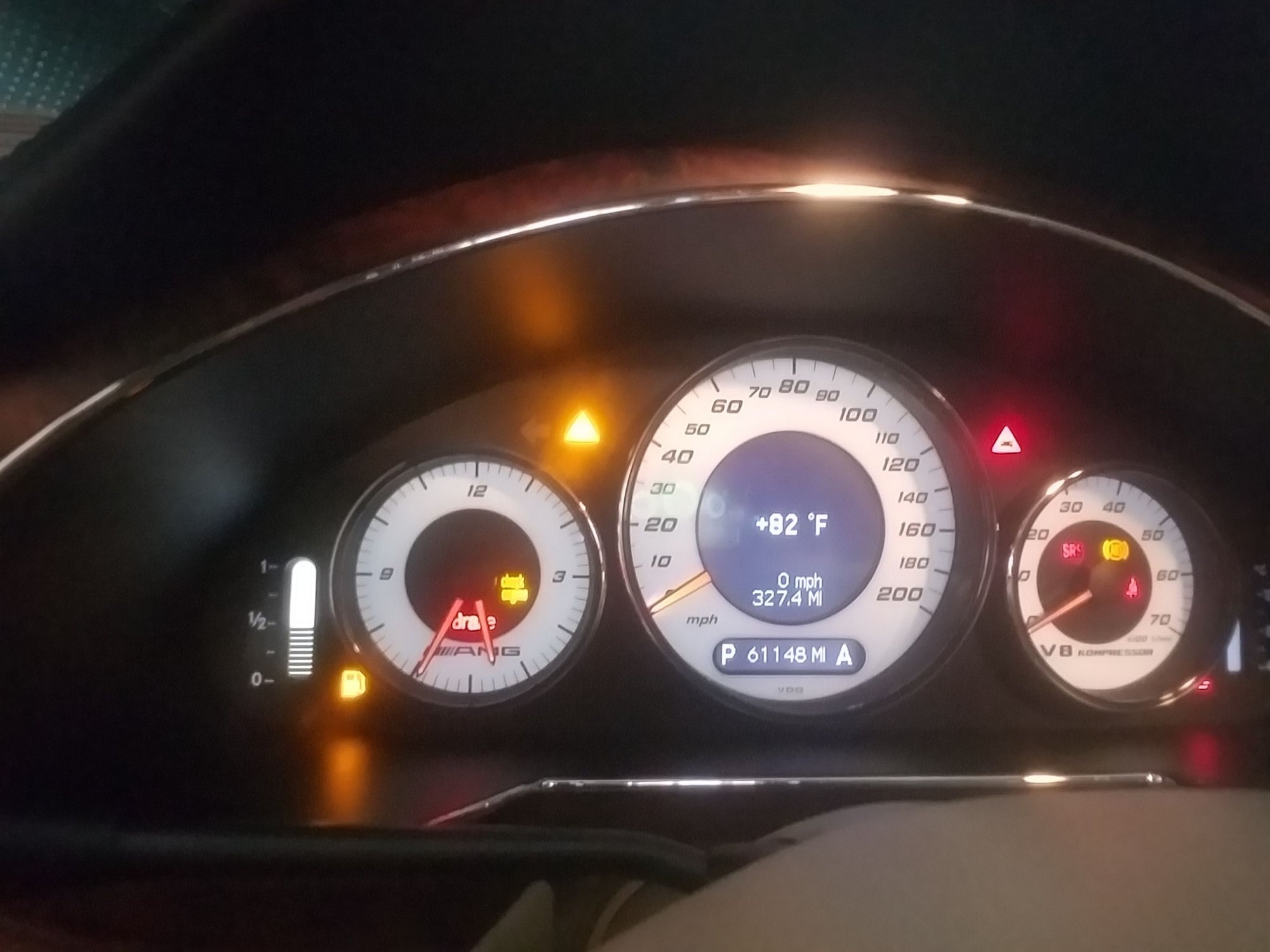

You don't have to jump over to the w219 board to find switching between the modes. Here is a pic of my dash after the feature was added and showing the A in the mode section. As PieRat noted the switch next to the shifter that toggles between the different transmission modes will be the way you set it. The sequence becomes C, S, A, M. I never use C or S any more.
