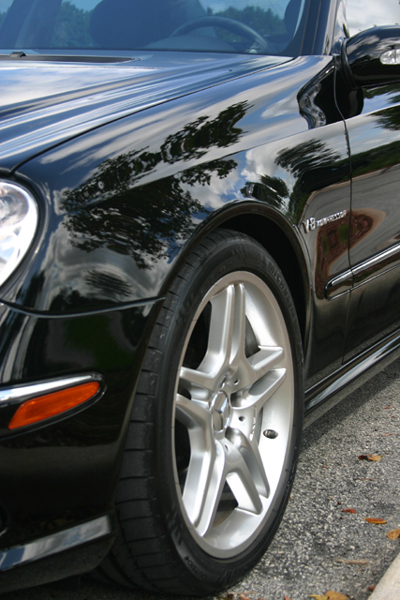

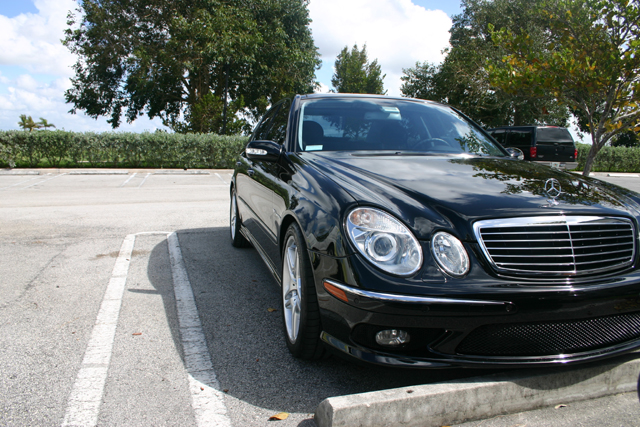

All true. At ET40 you would still have about 2mm clearance with the two tires I tried. ET42 is going to put the tires I tried against the upright. Even if you could find a slightly smaller tire you still leave no room for deflection.
Here are pics of the rear wheels on the front.
Attached Thumbnails Fitting the rear tires on the front of a W211 E55-wheel1.jpg   Fitting the rear tires on the front of a W211 E55-wheel2.jpg   Fitting the rear tires on the front of a W211 E55-wheel3.jpg
