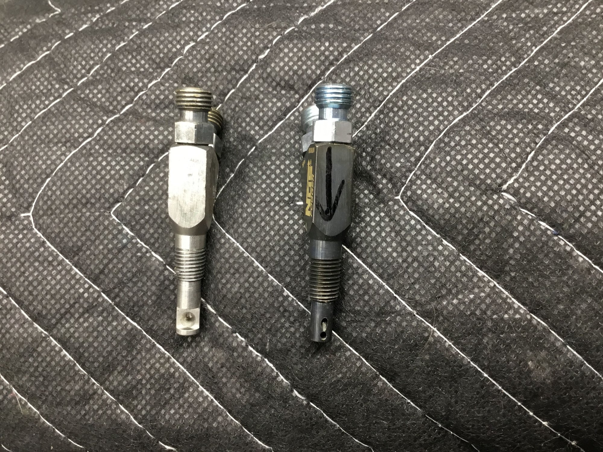

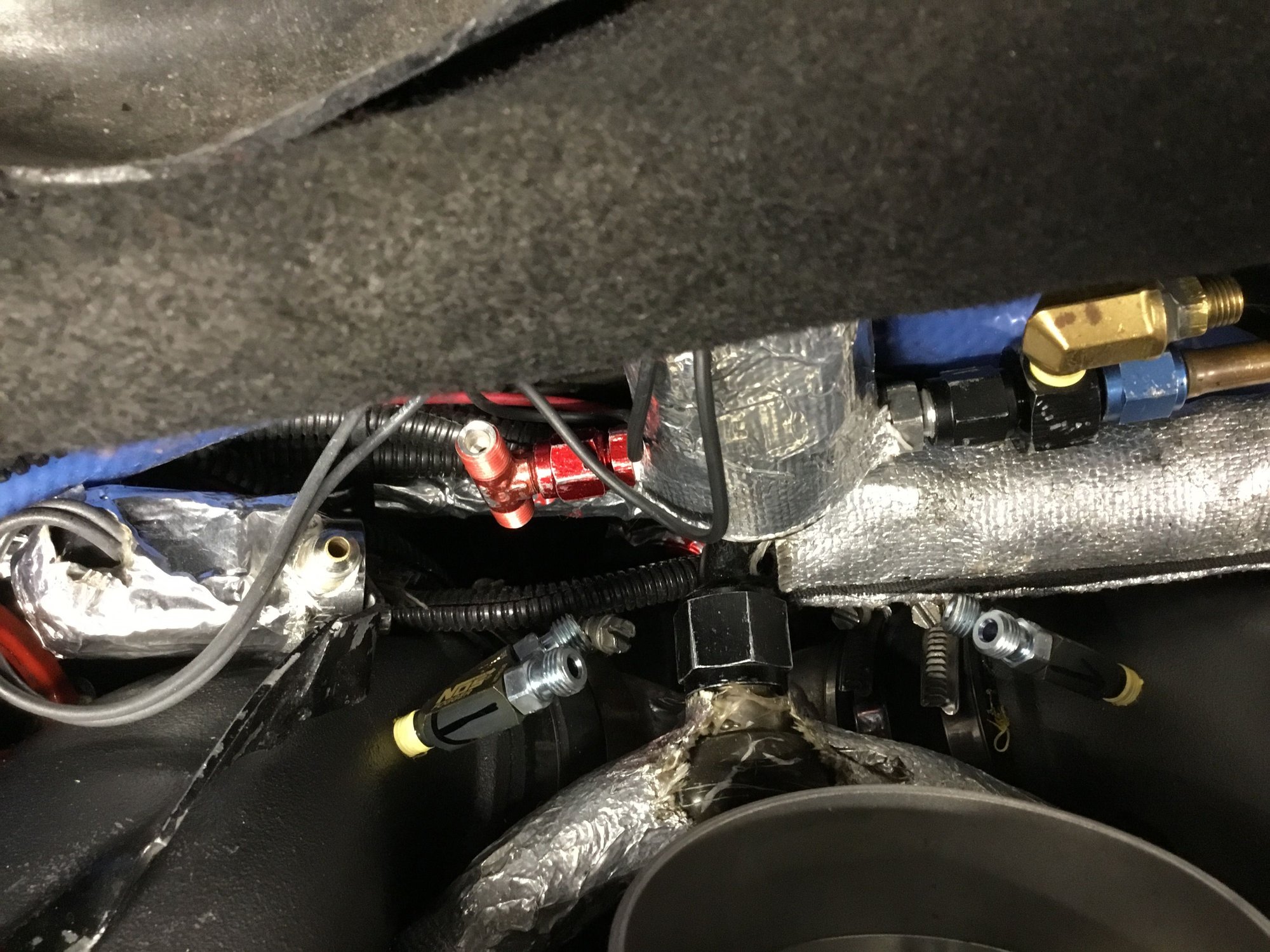

A little Nitrous work. After talking with someone that know far more than I do about nitrous I decided to swap the nozzles out for the NOS Fogger 2 over my older nozzles. You can see the drastic change they made on the outlet side.They will provide much better atomization and distribution to each cylinder which is a good thing for sure. will make new lines as well because the inlets are backwards the the Fogger 2 so that’s fun since it is all hidden and very tucked away behind the plenums.
Hopefully tuning will be right where it was before because it’s very hard to do it on the street now.

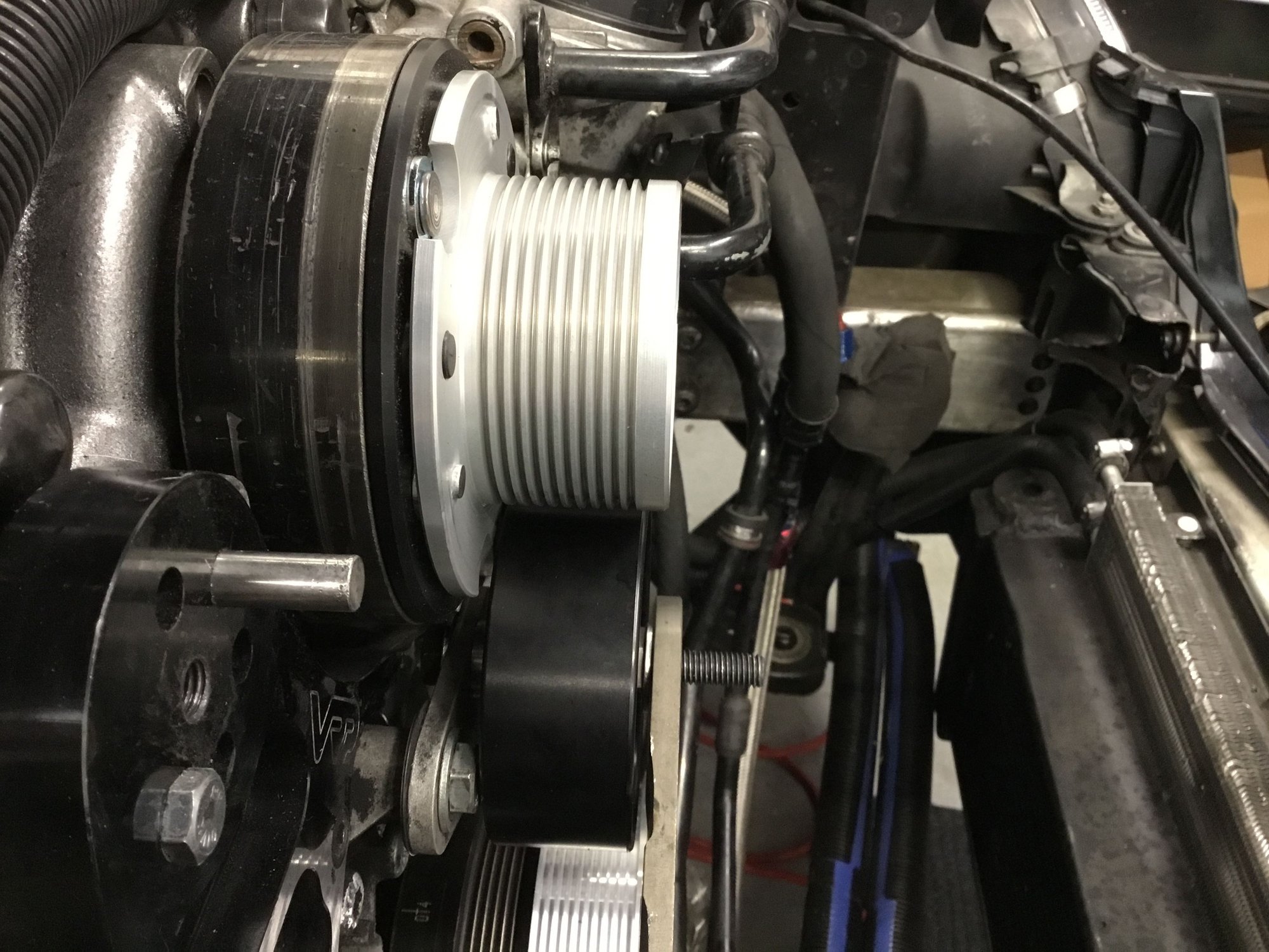

The pulleys are clean?
And I've never seen a 10-rib pulley...
Custom made?

Yep 10 rib. I was so tired of the belt slip and black rubber dust everywhere...and I mean everywhere that I felt I had to do something outside the box even more so so I had ASP Specialties make a set for me and felt this was the most logical step since I had done everything else. There was no way to get around the boost backing up in the intercooler unless top mounts where done and I was not going down that road so this should do the trick.
I went from a 77mm upper to an 80mm and a 168mm lower to a 172mm which puts me around the same boost but 2 ribs extra grip and a bigger upper pulley for more wrap. Of course I am having the upper Griptech treated just to make sure. Hopefully I will not need the extra belt tensioner that I had with the 8 rib but we will see I guess.The amount of money I spent on belts probably covered the cost of the new pulleys LOL.

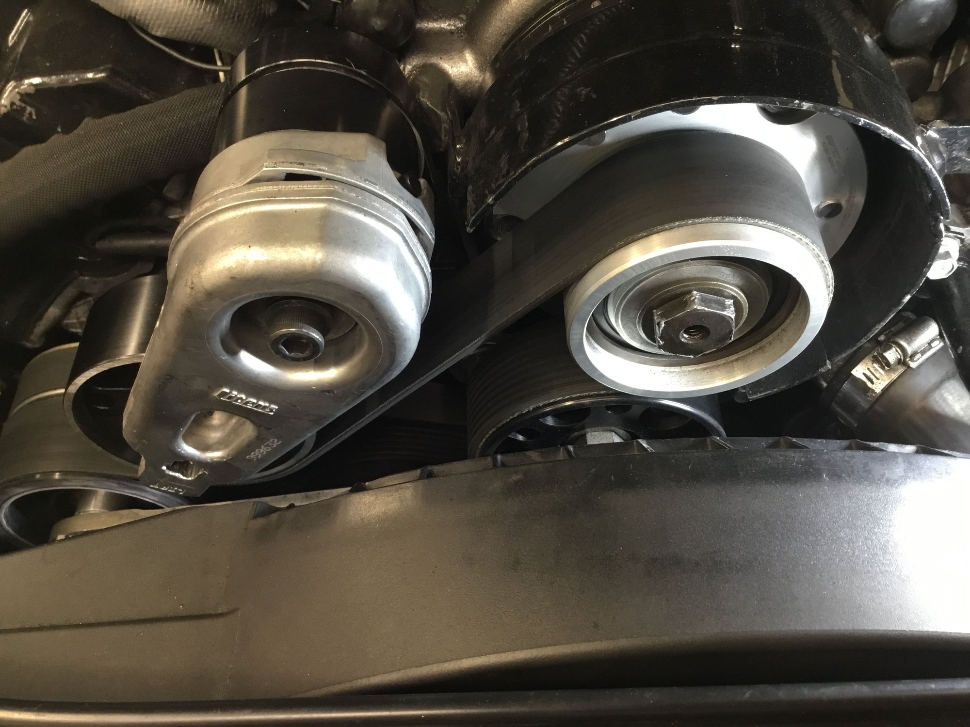

After some road tests and some Nitrous tuning I STILL have some slip,dust showing, but no where like it was. Im also not running the extra spring tension kit I made on it right now and just wanted to get a baseline with out it. It's amazing how much the stock intercooler backs up boost that's for sure.

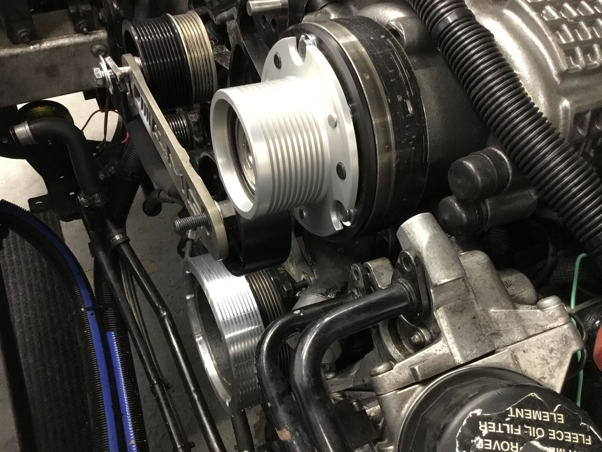

Last picture all assembled. My bottom "wrap" pulley is as close as I can get it to wrap around the blower pulley as much as possible.

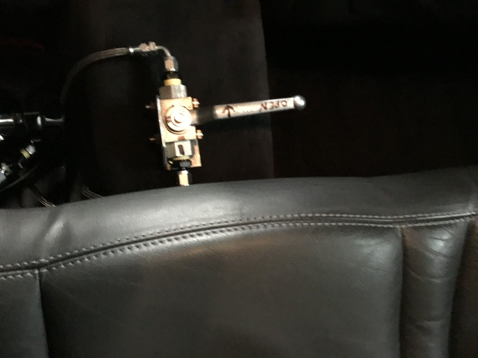

So anyone in the know about Nitrous is aware that as fantastic as it is, it could be a real problem if you need to shut the tank off as fast as possible especially with a fire of some sort. Most company’s offer a Quick Shut Off Valve for that reason so l decided to put one in just in case of that “oh sheet moment” because you never know. In a panic situation turning that tank valve off will take a little to long when something is cooking and swinging a valve handle is quick and easy.
I'd love to get one of the pulley under the blower... That would solve a big problem for me. Do you have a source for that?

Hey man,yea I have an extra if you want,it's a 100mm pulley and makes a huge difference on how much more wrap you will have, $65.00 shipped. PM your phone number and I will send a picture of it.

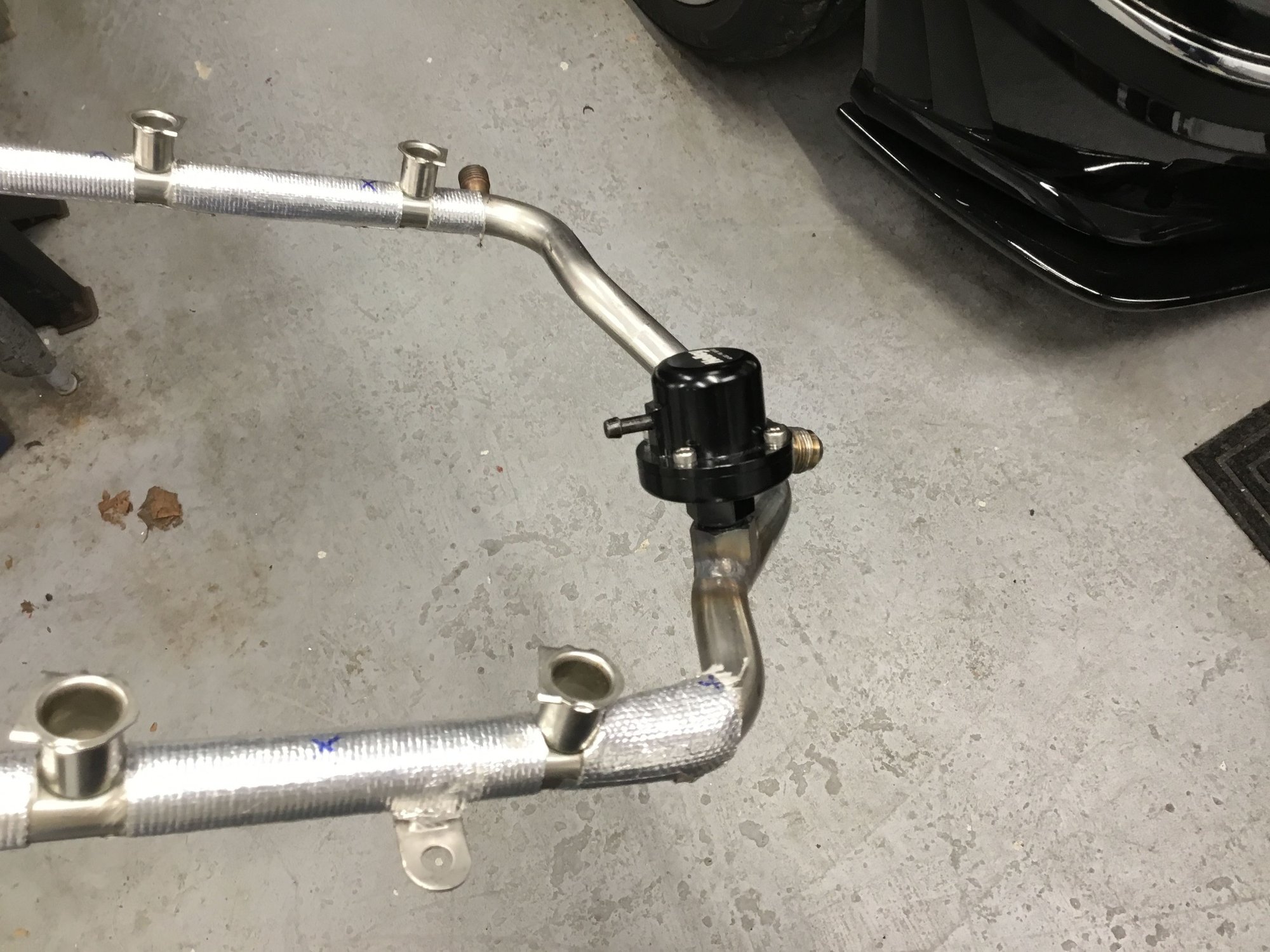

Also if anyone needs one I have a new ,200 mile of use, fuel rail damper for 50.00 if needed. I am switching over to a custom Holley set up so no longer needed.

Changed out the fuel damper to a Holley unit that is much larger than stock. Definitely a pain in the *** to set it all up but hopefully will even out the AFR from bank to bank. Don’t try this at home kids !!
