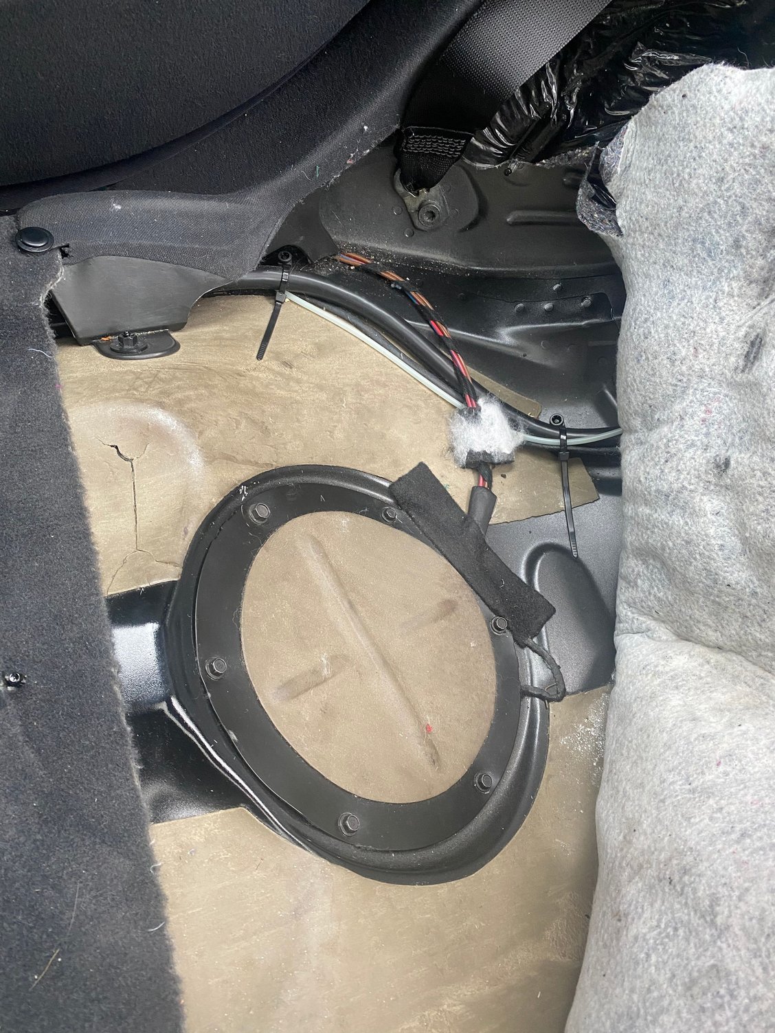

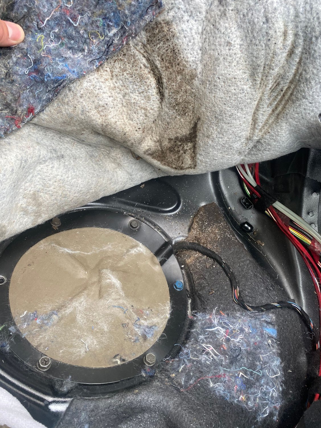

hey man, this is what I found. The passenger side has 0 leaks/fumes but the drivers side has a leak I think. There’s dirt/moisture and gas fumes. The driver side looks like it has been tampered with ( mismatched/missing nuts)
should I open those up?
Passenger
Driver

Yes, open it up! If there is gasoline pooled on top of the plastic cap put it all back together and go talk to the dealership from where you bought it. They may be able to get away with just a new filter/regulator and an o-ring on that side. Part numbers are important! Not all filter/regulators are compatible with the two generations of fuel pumps. Read the links I provided to you earlier.
