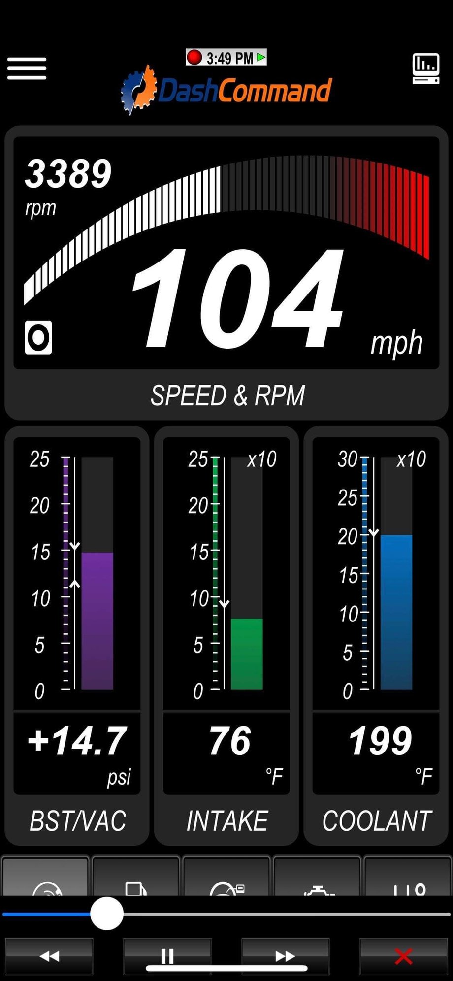

Your ait can be cooled down by installing a Force Induction Interchillers for around $1500, my ait runs in 50s/60s Fahrenheit and recovers within seconds

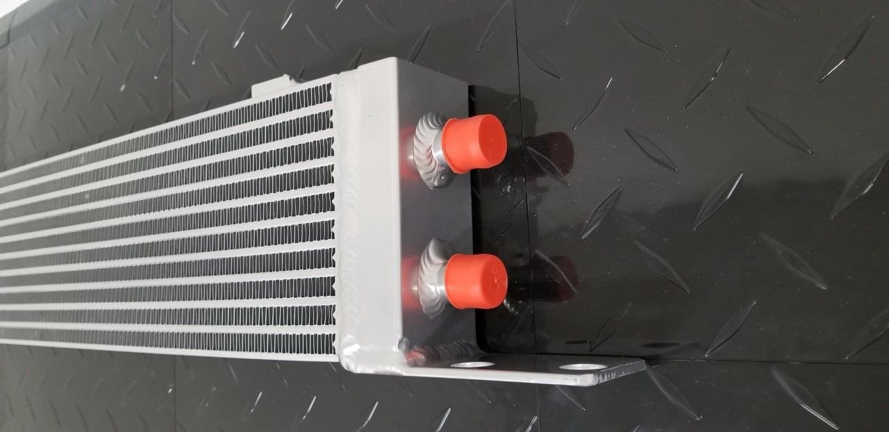

IAT`s move quick under any acceleration and if you want cooler IAT`s, then you can add one of our XXL heat exchangers to help with more water volume and cooling surface.
