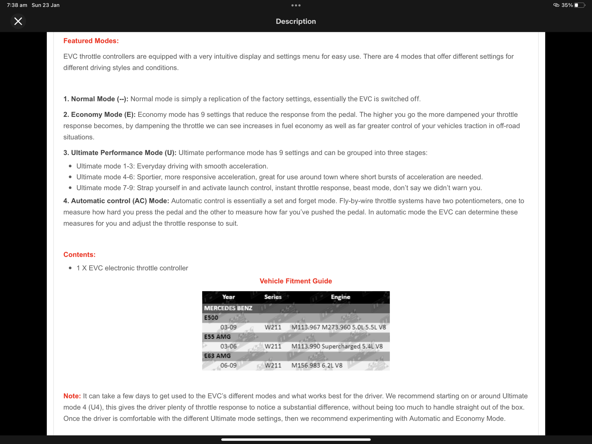

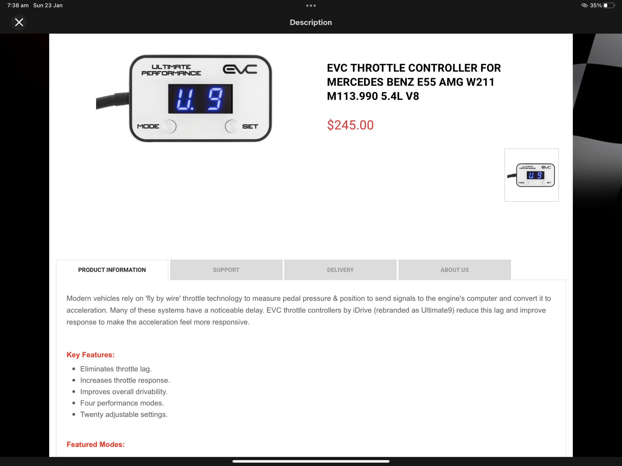

Has anyone had any experience with the EVC Throttle Controller? Wondering if it’s worth it?
