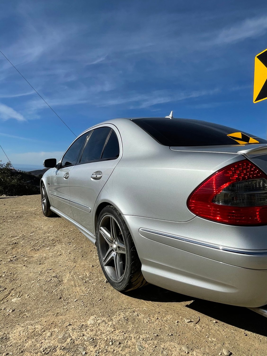

I'm sure for the stock E55 wheels, but the wheels that I now see on your car posted here are not those wheels. The wheels you have are from a new model car - I think the W212. Others may know familiar enough to know the offsets of those wheels but I don't without the part numbers off the backs of the wheels. But, if you are pulling wheels the ET is also on the back so you can confiirm the offset that way too. MB often have the same wheel style with different widths and offset depending on the model the wheel is originally used on. Therefore, you can't always just look at the wheel style and know what the offset is.
Oh okay. Will be taking wheels off to install coilovers soon so i’ll check. By the back do you mean on the inside of the wheel?
Those wheels are the stock wheels for the W211 E63, although newer models also use them too.
