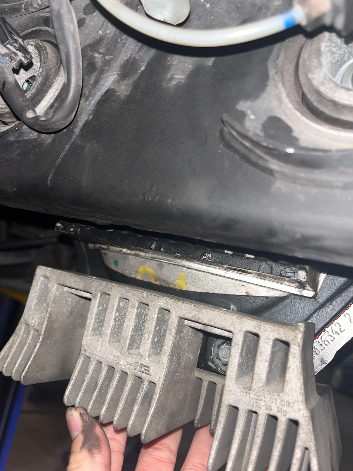

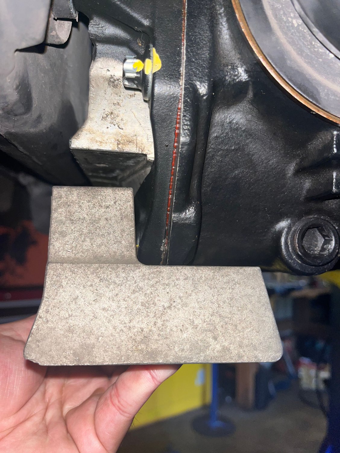

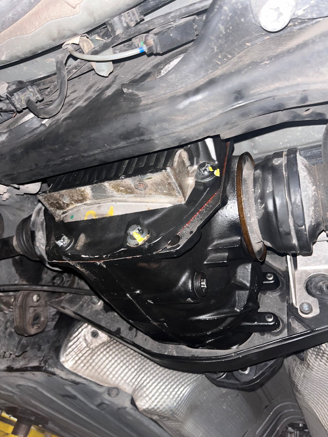

I bought a replacement differential for my E55 from a forum member a few weeks ago and installed it today. Everything bolted up great except for the heat sink that bolts to the bottom. It is a few inches short to reach the edge in order to be bolted in.
The differential has been modified with a P30 LSD out of a CLS63 and stock E55 gears. It did not come with a the fin attachment. When I looked up the part number for the original heat sink, it says that it will fit a cls63. Does a P30 diff come with a different diff cover? Since I already installed it, I can’t see the part number on the new diff. Can anybody help me identify which diff cover I have so that I can order the proper heat sink?

Cant you mount it the other way around or will it interfere with the exhaust? If it fits the other way around, you will still have the heatsink function.

I didn’t check to see if it would work in that orientation, but I would like it to be “right”.

Other solution would be if someone could fabricate an aluminium spacer for you, if we cant solve this puzzle?

Anyone know what the different heat sinks look like?

Looks like the guy I bought the diff from was incorrect about it being a 2005 diff. The diff cover is off of an 03 or 04 with the different style heat sink.

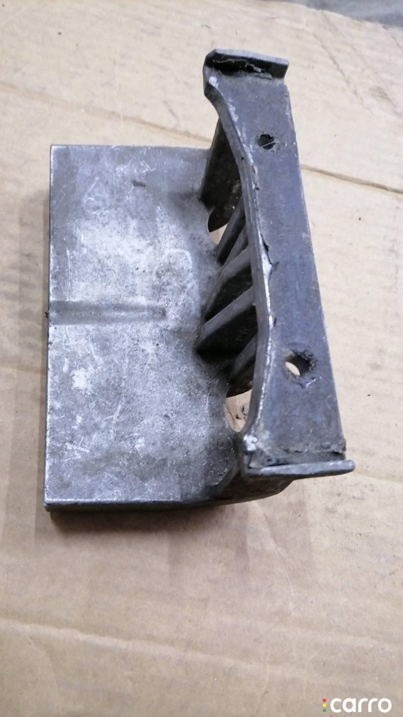

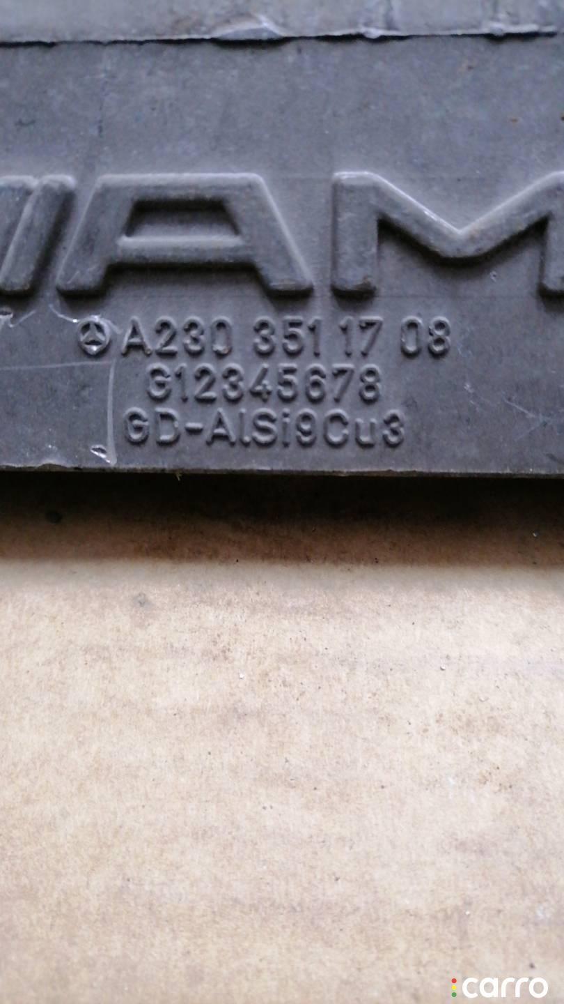

I think you’re looking for this one….
PN#
2303511708
Good Luck!

That should explain it indeed

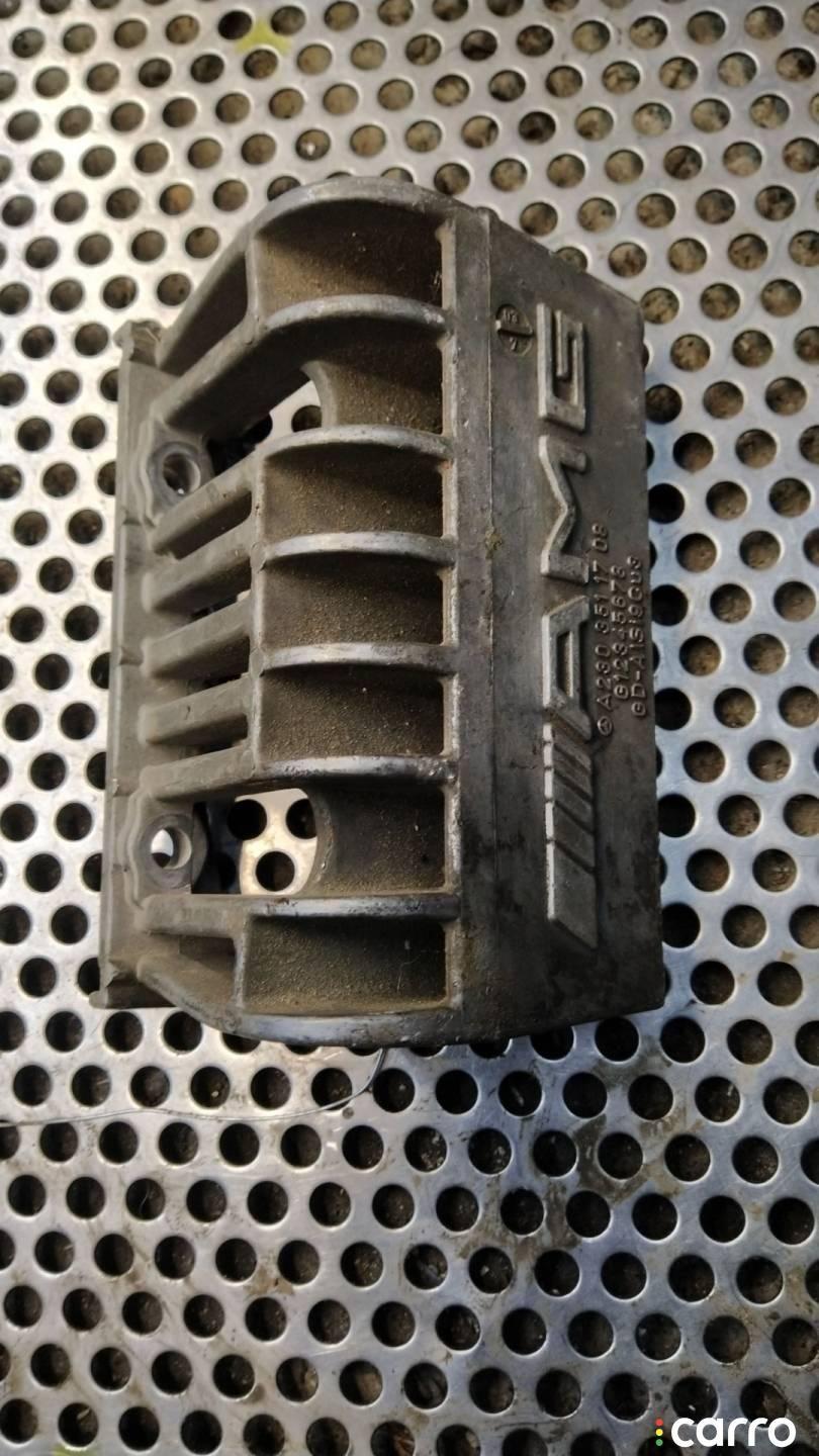

Got lucky and found a mint one from a guy off Facebook market place and he ended up working in an office building right outside my neighborhood. Happy as hell as it doesn’t seem like there’s any undamaged ones for sale at the moment.
