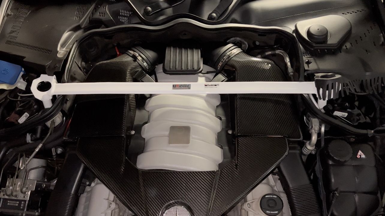

Ultra Racing Europe mentions 1 for E63 W211 chassis? Picture shows E55 engine bay though....
https://ultraracingeurope.com/index....pper-strut-bar

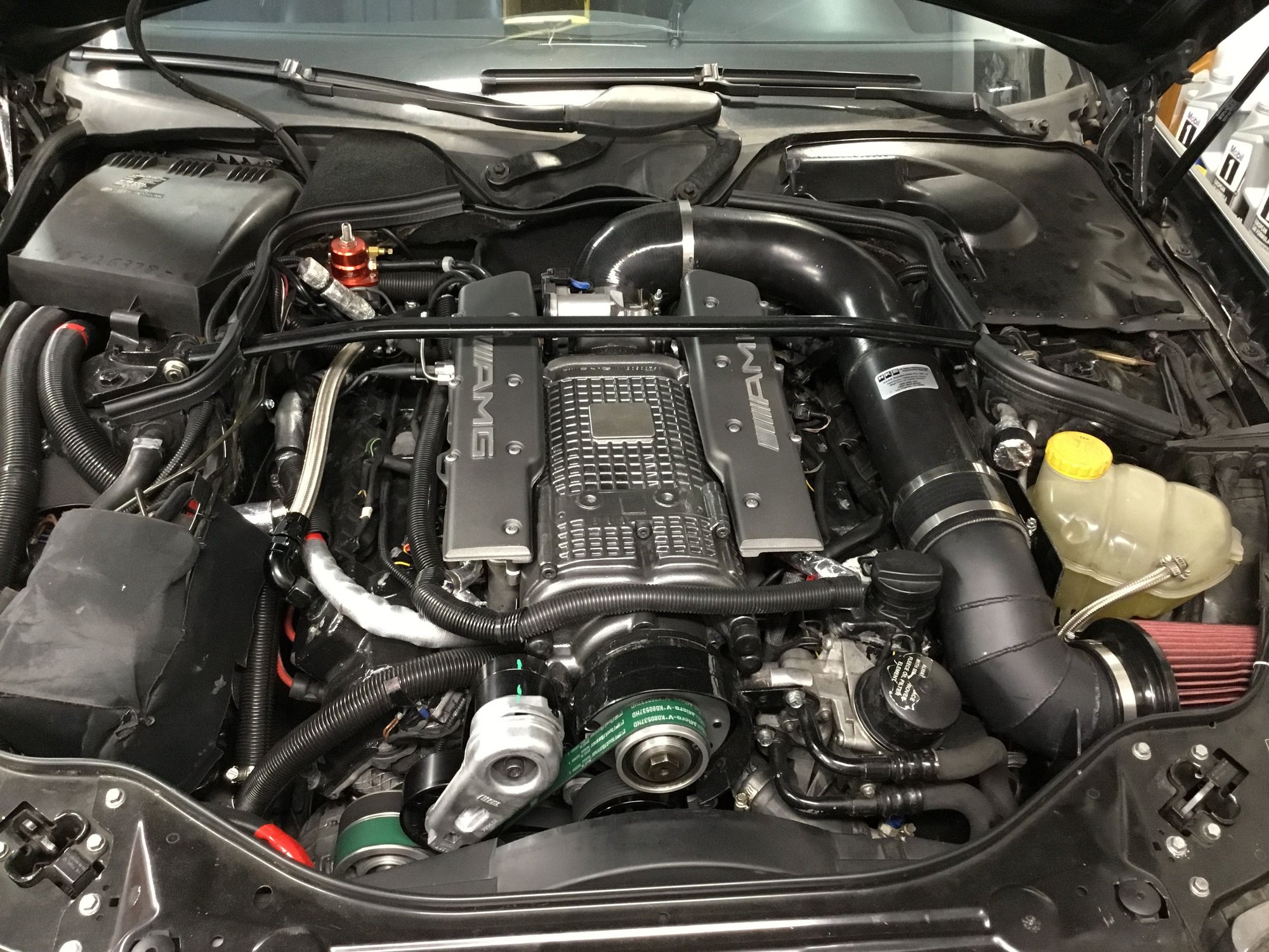

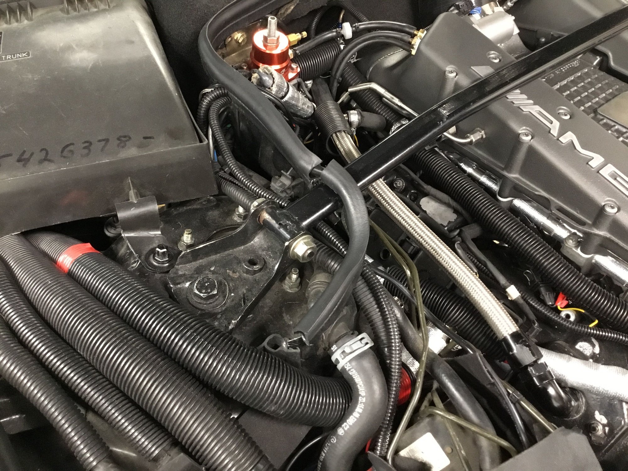

I made my own set up for my E55.
A few things to remember as far as the bar doing nothing.
First I bought a couple Ultra bars and they were very "flimsy" for my liking.
Second as far as the bar doing nothing I can tell you with 100% that if the bar is off the car and I have it on jack stands or one side lifted I can not get the bar bolts back in do to the flex and need to have the car flat on the ground. Under the car I made a custom support that goes from the transmission crossmember to the from frame as well.
Old Jun 1, 2023 | 04:04 PM
eightysixtuned's Avatar
Joined: Apr 2022
Posts: 379
Likes: 133
W211 E63 AMG
i'm not 100% certain but now looking at this photo it looks like the bar on your car will not clear the M156 engine.
but...thoughts to building bars and selling them?

You can bend the brace for more clearance but no....I only build stuff for myself. As you can see in the picture......she an't stock no more. Just dynoed it at 598hp and 625 tq LOL

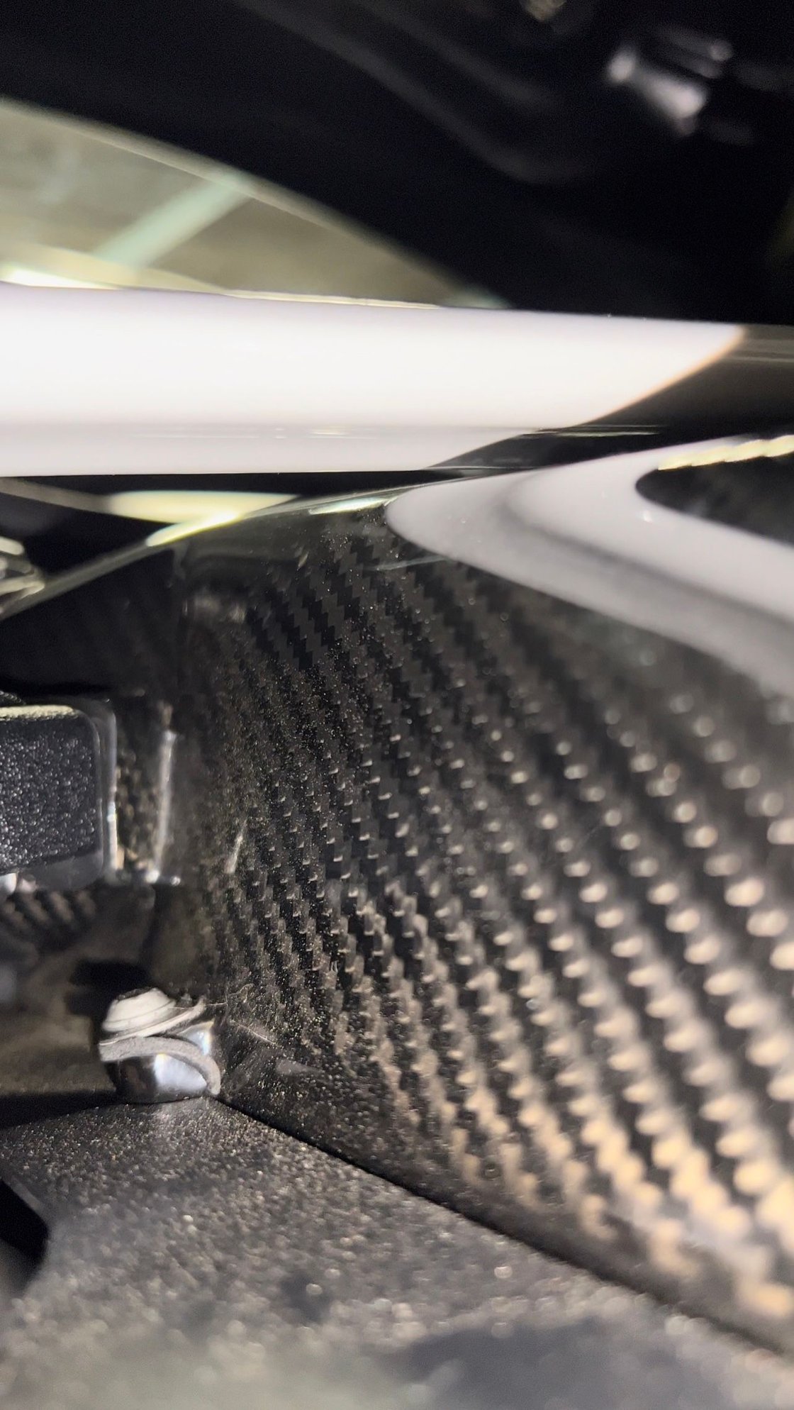

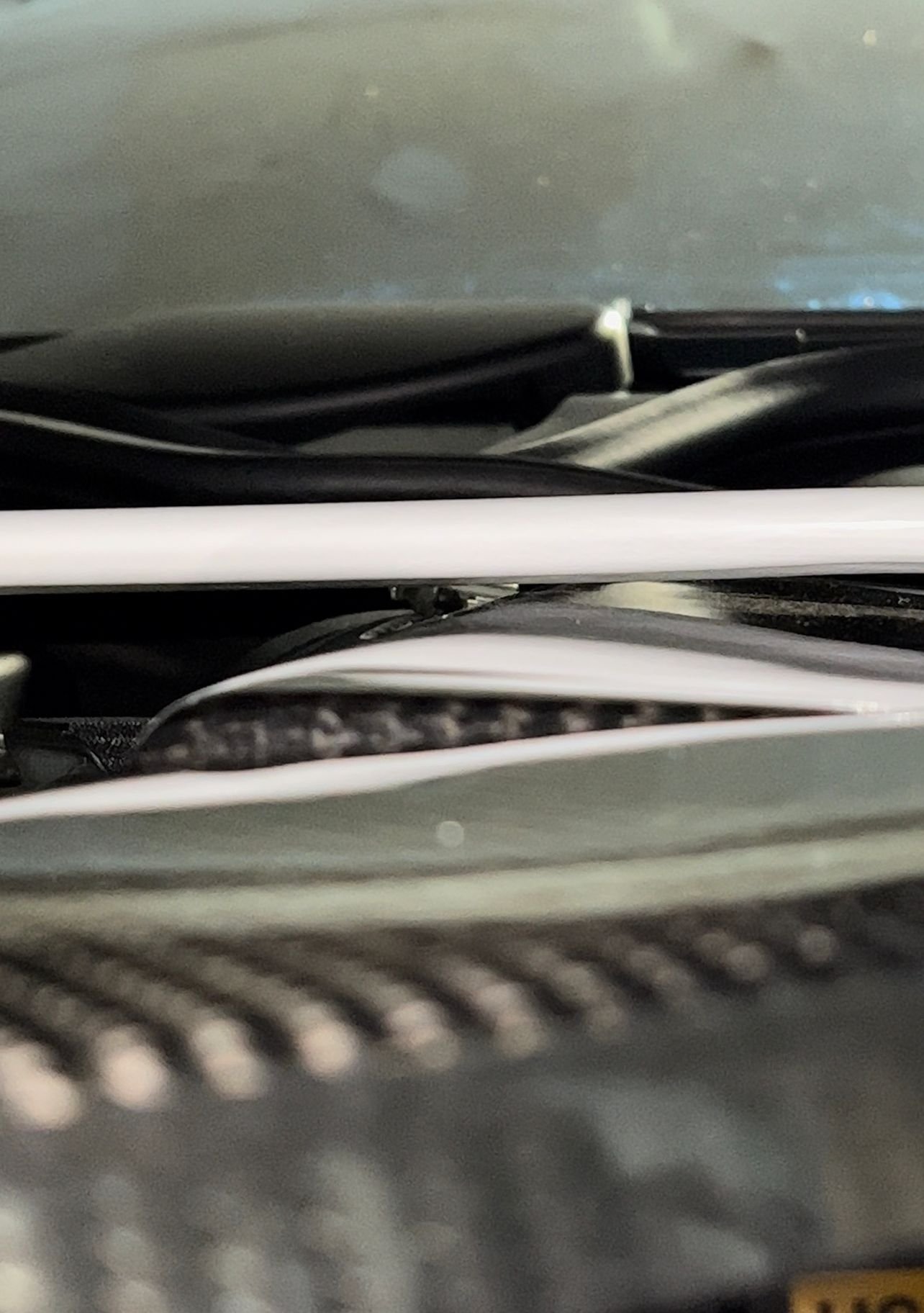

So I can confirm the ultra racing bar fits a w211 e63….shorta. The bar was a pain to mount up as you really need two people to press down on either ends while tightening the nuts. But I got it to mount, the only issue is the clearance. On a Clk63 black series the strut bar is slightly bent and now I realize why. It’s very close to the inner ends of the airbox, I can fit maybe 3-4 pieces of paper before it gets jammed in between the box and bar. So I’m not sure what I can do as I can’t put spacer since the nuts on the strut itself is almost to the top because of how thick the strut bat bracing is. May have to just cut the center and bring it to a fab shop to bend up some metal and weld it to the endpoints.

What's going to happen is under hard acceleration, the carbon fiber air box will make contact with the strut brace. It's going to happen at some point. I have the carbonio carbon fiber engine cover and airboxes.
And I can just see in now, rubbing a hole thru them. But taken it to a fab shop would fix the issue, just ensure that you have enough clearance for the hood to close.
Sigh, I’ve been trying to avoid a fab shop. All the ones by me only work on their friends cars or have a 3 month waiting period with a non existent waiting list. And yea I don’t want these to make a whole in my carbon airboxes, that would be a real bummer.
