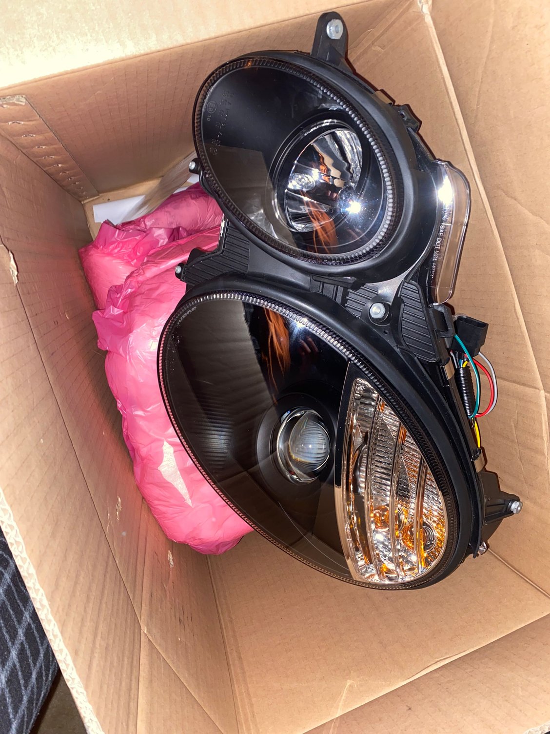

Hey y’all, these beauties came in the mail today, suuuper excited to throw them in, but I fear that I might be missing something or not as knowledgeable on the process. I was wanting to know if there’s anyone that’s done a job like this to their E55? I want to make sure I have absolutely everything I need for the whole thing so nothing breaks, or if I’m missing anything, fragile spots or screws, etc. I’ve watched some YouTube vids on the process and everything but I know the forum is where the real experts reside

You’re gonna love this one… I go to put them in and everything is going exactly as planned so smooth but there’s one problem. The connections for one of the ballasts were different… I call the support line from whom I got them from, they said “oh you have the TOP of the line E-class Mercedes” I said “yeah I guess” he said “the thing you’re looking at that’s wrong is the ballast for the motor that moves the headlight bulb up and down, left and right, unfortunately those headlights you got do not have that, you can still use them but the bulb won’t move up and down and such and it’ll also throw an error code on your dash telling you that motor is out because it can’t find it.” And let me tell you man that broke my heart just absolutely shattered it.

then they told me “we don’t sell those ones and idk of any other company that does”

As soon as you posted that picture I knew those wouldn't work but you were too pumped. I ran into the same problem when I replaced my lights (I bought different lights than you) and found out the connectors were wrong. I ended up ordering these:
https://www.uniquestyleracingstore.c...ctor-headlight
R.K.
thanks for reaching out. The link you sent me were headlights without the AFS function I was needing them with AFS.

“The Adaptive Front-lighting System (AFS) optimizes distribution of light from the headlights according to driving circumstances. Depending on vehicle speed and steering input, the system points the low-beams headlights in the direction the driver intends to travel” -google
It moved the bulb in the direction the steering wheel turns I’m pretty sure. When I bought the car it was my first time hearing about them too.

Active headlights are code 615. Code them out as "Not installed" using STAR/Xentry. If an error, you will receive an error message on the instrument cluster referencing the failing/failed headlight.

So I can just use a OBD2 scanner and code them out and it won’t give me a message on the cluster anymore? I also don’t have the correct ballast for it. The ballast that moves the motor in my current ones have a different connection than these, idk if it’s NEEDED or if it can stay unplugged.

Go here to put your VIN in to see if your lights are active.
lastvin.com
code 615
if you need active lights you either have to buy OEM or get reg HID headlights and code them out using STAR

I checked and I don’t have 615 option on my car.

so then just reg xenon/HID units are needed
you can open them up and make them even better if your wanted to
