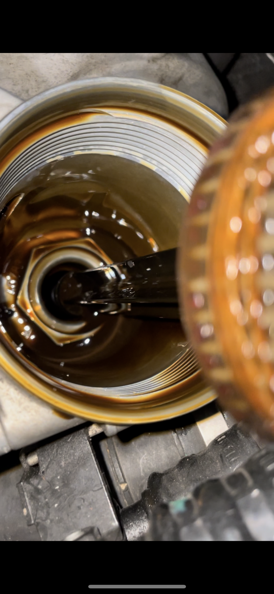

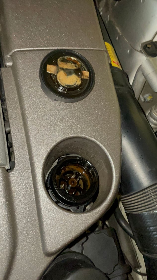

Hello
am posting here since the SL55 boards are not as active….
Just had a MB Indy shop install a new MB water pump on my 04 SL55 with 81k last week and after 2 low coolant warnings (I topped them off) I found coolant is now mixing in my oil which you see the milky dirty oil in the pic with the oil cap removed.
The car was running perfectly before this, except for a noisy water pump. The oil was clean and I wasn’t leaking any coolant.
What could they have screwed up on this repair to cause the coolant to get into the oil?
They have damaged the head gasket? Or damaged one of the cooler lines?
I’m will call rhe shop Monday morning since they’re not open this weekend. Thanks for any feedback.

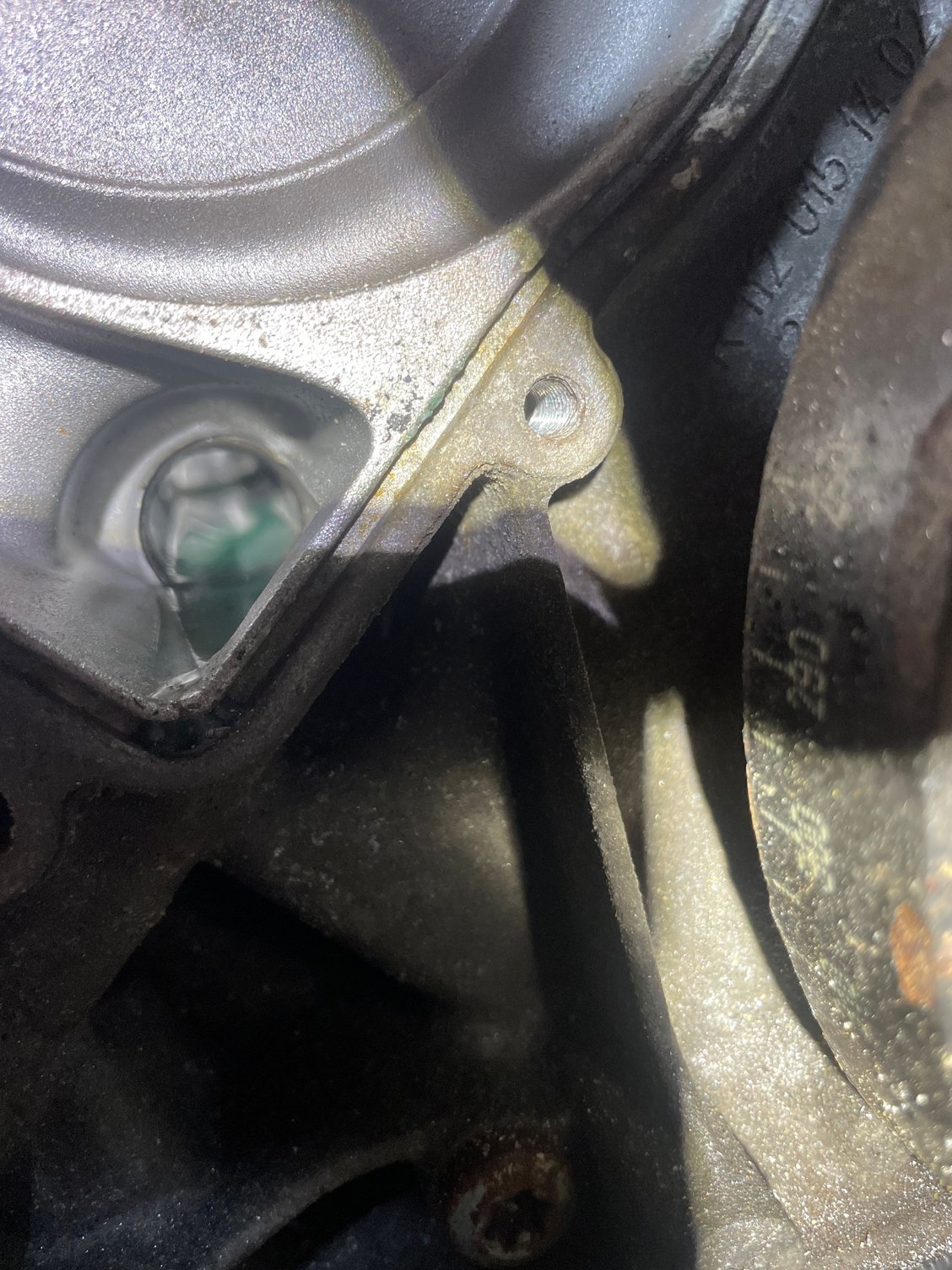

The timing cover orings are bad. That’s the problem with these engines, very difficult to get to. While you are in there do the pickup tube oring

That is also my thought. You can see it here:

Nope they are destined to fail from the inception. If you would like to be mad at someone, be mad at Mercedes for designing this front cover with such a silly design. To replace these correctly, the oil pan, and the heads need to come off.
The Mercedes engineers designed the top of the cover to be sealed with the head gasket, and decided that the oil pan would be sealed with the same RTV as the front cover. It’s a real ****ty design and much Rube Goldberg was engineered into it.
I have dealt with this quite a few times, and it isn’t an isolated problem.
There’s some pictures for you. The first is 2 orings, they are the same, but one has been compromised from either oil or possibly coolant. I would go for the oil contamination that has swollen the ring to a jelly like substance. The other one is an oring that has started its journey into the water passage of the head , that’s where they end up, at least the passenger side one. This one is starting to swell and bulge like a bad spinal disc. A little more swelling and movement means coolant dumped
this one is harder to see, but is the factory install with a bulging oring ready to leak. It’s quite the Achilles heel of these 112 and 113 engines .

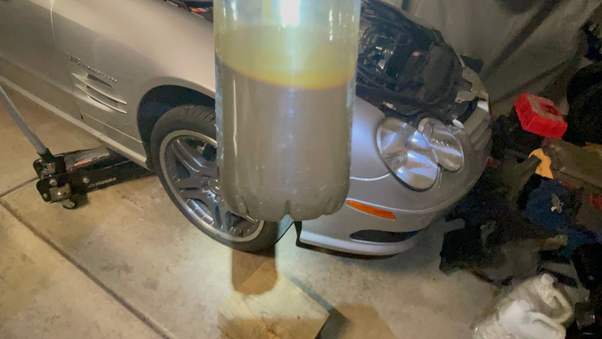

@cdk4219 thank you for sharing this. Indeed am upset at the terrible design with these o-ring seals. I am curious as to what age / mileage these o-ring seal failures are happening? I saw some of Tassos videos of these issues at 150k miles but I’m at 80k and never expected this.
my car is 100% stock never tracked and is a 4th car I drive maybe 2-3 time per month for long weekend drives so perhaps I am just unlucky with this happening to mine.
I’ve enjoyed the car and will put some thought into repairing it of parting with the car as it’s a SL55 R230 which has been amazingly enjoyable to drive when it works but between all my ABC issues and now this the love for the car is at its end for me…
Coolant mixed with oil

I today just drained the oil and refilled it with 8 quarts of Mobile and will do as you said and drain it again without any coolant in it. It’s been 1 week now and I’m nervous having that coolant mixed with oil sitting in the engine. But I’m going to drain the coolant next and fill it again with new oil maybe 1-2 time more before I have it repaired.
