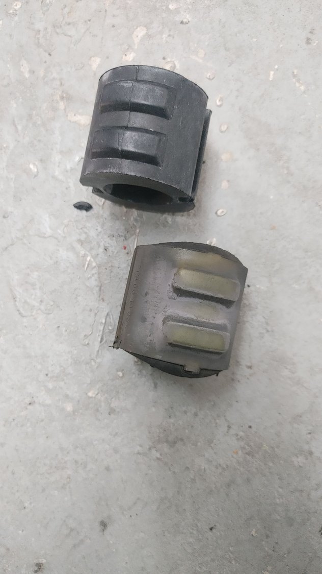

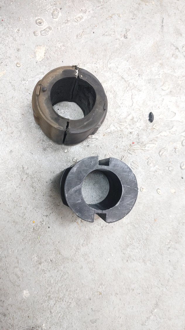

Originally Posted by hachiroku
what are the front bushings you ended up using? rear's not aware of as the fronts are considered non replaceable bushings. rears likely as well, but been a while since i've looked at the sway bars.
I took a chance on these https://www.ebay.com/itm/395636998979 and they turned out to be a great fit.
At first glance they look too big, but that was compared to worn 20yo bushings. The notches lined up correctly, I replaced the holders as recommended in WIS, everything fit well.
Last edited by mekantor; Oct 14, 2024 at 12:34 PM. Reason: add photos of aftermarket front sway bar bushings
Old Oct 14, 2024 | 07:09 PM
SICAMG's Avatar
Joined: Jul 2014
Posts: 3,321
Likes: 583
2005 e55 AMG
Yep bought those too....dirt cheap and perfect fit.
