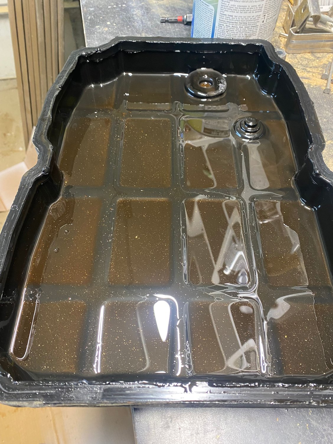

My 2005 E55 AMG has run great for the most part. It has 70k miles and I've been driving it since 50k. I was driving the car to a thanksgiving meal and about 45 minutes into the mostly highway drive I started to hear a whine I'd never heard before. I hadn't accelerated right before the whine or anything it just started to make the noise. I then pulled over and investigated for a few minutes but found nothing. I had a passenger in the car rev up the engine a bit in park to see if the noise was dependent on engine speed. I didn't hear the noise so we took off and I accelerated hard to get back on the highway. The transmission slipped trying to get into 3rd gear but eventually found it. The noise was more prominent now so I pulled off to a gas station about a mile away and on the way to the gas station the transmission became stuck in 2nd (limp mode). I turned off the car and got gas. When I turned over the engine again everything seemed normal except for the noise (no CEL or limp mode) so I took off down the road to test the transmission a bit more. After about 30 seconds of driving the sound came back. I pulled up to a stop sign and when I let off the brake and got on the gas the car was in neutral while saying it was in drive. I had lost all gears but reverse and now had the CEL on. I reversed onto the side of the road and had it towed back home.
I first checked error codes and found a P0730 incorrect gear ratio error and then a few "The Gear Is Implausible Or The Transmission Is Slipping." errors (P2561, P2563, P2560) for gears 1, 2, and 4. Another error I got is a P220A stating "The speed comparison of Y3/6n2 to Y3/6n3 is implausible. Finally I got a 6230 ESP error and a 6210 ABS error - not sure if these are meaningful. I read up on all of the issues this could possibly be such as conductor plate, atf wicking into tcu, and coolant mixing with atf. I first disconnected the battery fully in order to reset the tcu. This seemed like it solved the problem as I was able to drive completely normally but after about 20 minutes the sound came back and then it was back into limp mode. I got the car back home and let it sit for a few minutes and then tried to replicate the sound and it came back fully after about a minute of getting on the gas with the brake pressed down in order to heat up the atf by running the torque converter hard. The sound seems to only be made when the fluid is pretty hot. I could not tell exactly where the sound was coming from but it sounded like the back of the engine. I got it up on stands and dropped the transmission pan and found metal shavings in some very dirty fluid along with a seemingly normal amount of clutch pack wear on the magnet.
I plan to drop the transmission next weekend and see if the transmission pump has gone bad. The fluid level seemed fine to me too. One odd thing I noticed is that the fluid when measuring with the dipstick seemed a lot cleaner and more red than the fluid that drained out of the pan. Let me know what you guys think.

That's some nasty fluid.

Trans is done and will have to come out by looking at what is in the pan. They are easy to rebuild if it needs to be done.

Just completed the rebuild on mine. Same issue. 2nd and 3rd was gone and oil pump was bad. Sent mine to Southern Hotrod in Louisiana. OEM+ rebuild. Similar price to OEM parts. Only problem is shipping the unit to them. They do not have cores.

The fluid always looks cleaner on the dipstick, it’s always surprising when it’s drained
