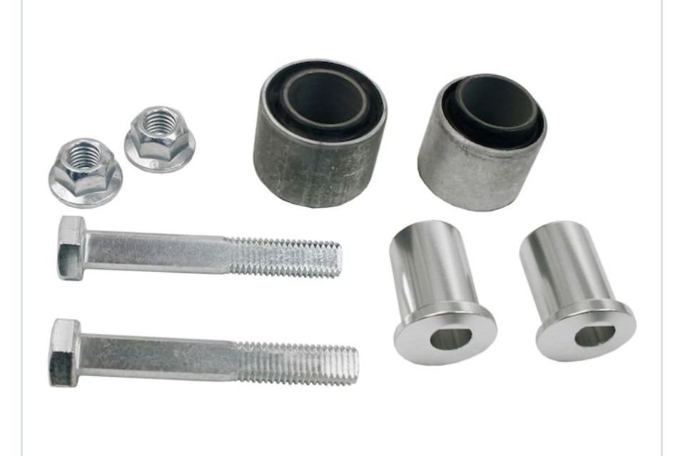

Good answer, no warranty on this. It’s not a good design, and it needs to be greasable. Probably works well in Australia, not in the rust belt. Looks like moog makes some uppers that don’t have saw teeth.
Seem to be more cost effective as well.

Re your pic of brand without teeth. Pic shows they have plagiarised our design / helped themselves to our exhaustive research and development - K-MAC Patented design breakthrough. But the result having no teeth “MINIMAL” adjustment - (Simply cannot expect offset bush to maintain security) !
