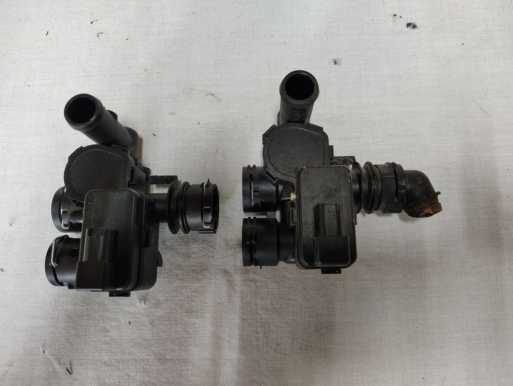

Next up, replacing the heater control valve in my W211 E55 so I can get some heat in the passenger compartment. I've done it before so I expected to have it done in 3 hours or so.
Nope!

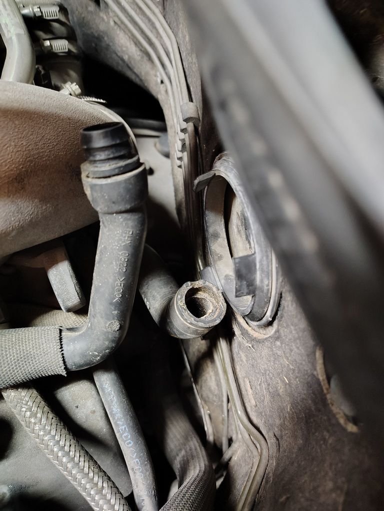

Used an old drum brake spring puller to pop off the metal clips that fit the old heater control valve to the engine coolant hose and the heater core. Heater valve slipped right off of the heater core connections but the plastic fitting on the hose from the engine was stuck in the old heater valve. Tried rotating the fitting to break it loose and only managed to break the plastic fitting! (Not much bad language. I just accepted it as my fate.)
Now to obtain a new hose with pre-installed plastic fitting from the dealer. Yay.
And looking at everything, it appears I have to remove the driver's side surge tank so I can get to the hose clamp attached to the engine block under the throttle body. Joy oh joy! Can my day get any better?

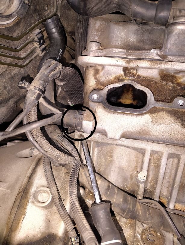

Well, I'm going to drop even more money. The clamp where the line connects to the engine cannot be reached by ordinary means as the blower outlet snout and proximity to the firewall prevents access.. My thanks to HemiAlex for his suggestion to pull the blower off the engine (I was seriously considering dropping the transmission).
Since the blower is going to be off, it means "as long as I'm in there" rules apply. Rear bearings, fuel pulsation damper, possible injector cleaning and flow testing, new injector o-rings, MAP sensor, cleaning of valley between the heads, replace any rubber lines in there, and degrease the intercooler if needed.
All for one clamp...

All of this
Just so I can remove this clamp on the heater hose...
I'm glad I kept my engine hoist...
