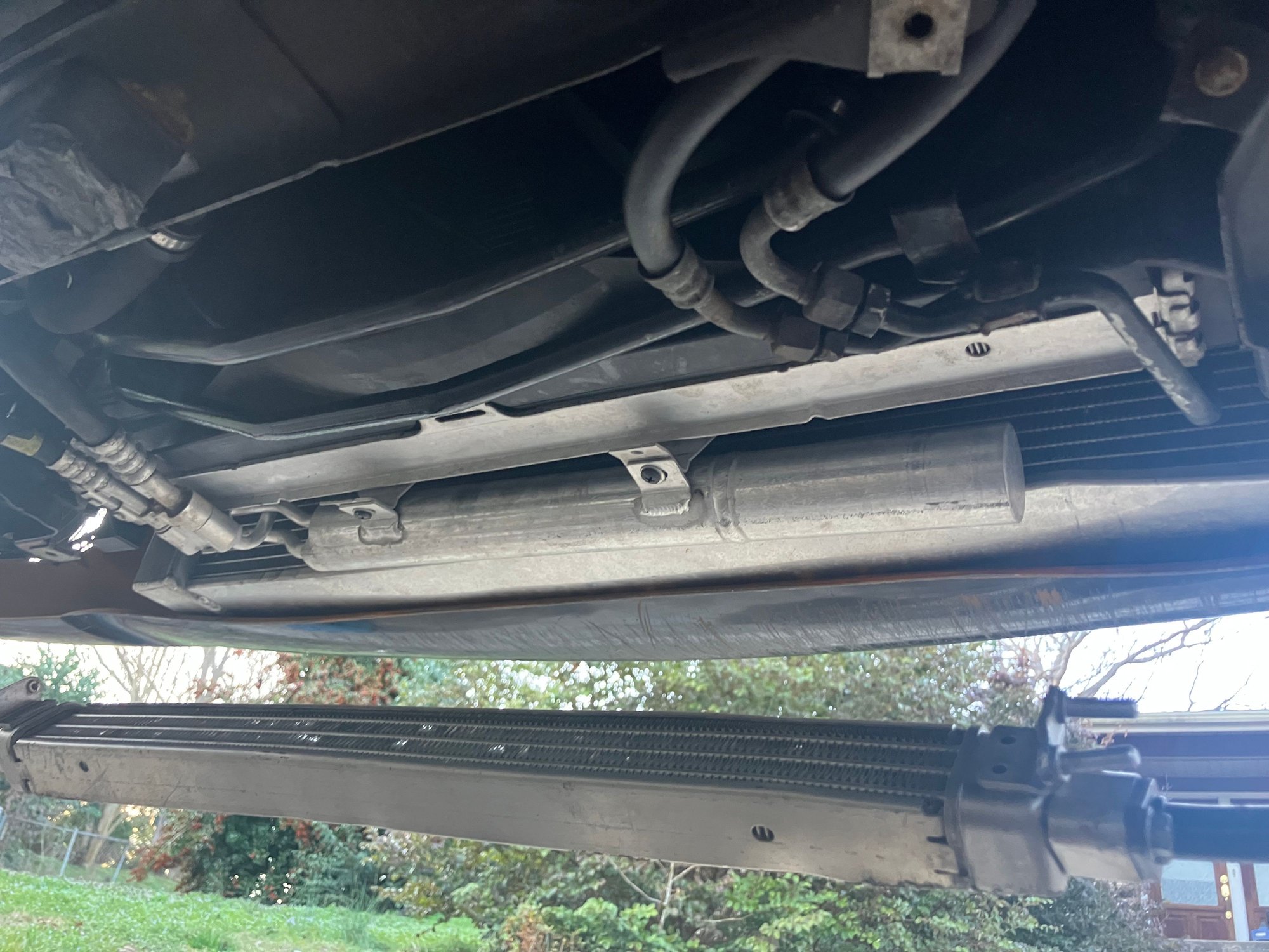

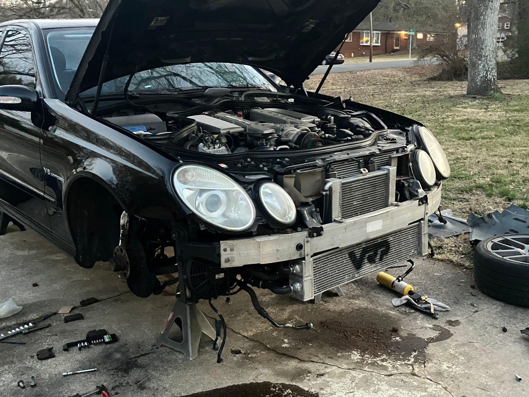

I have a couple more pictures. I’m still at a loss to how to mount this oil cooler. There is no room under the vpr heat exchanger unless this thing is supposed to hang 2” out the bottom. If someone has the VRP instructions or just pictures of your oil cooler fitment that’d be much appreciated. Worst case I may just yank out the passive oil cooler and run a rubber hose directly to the active oil cooler.

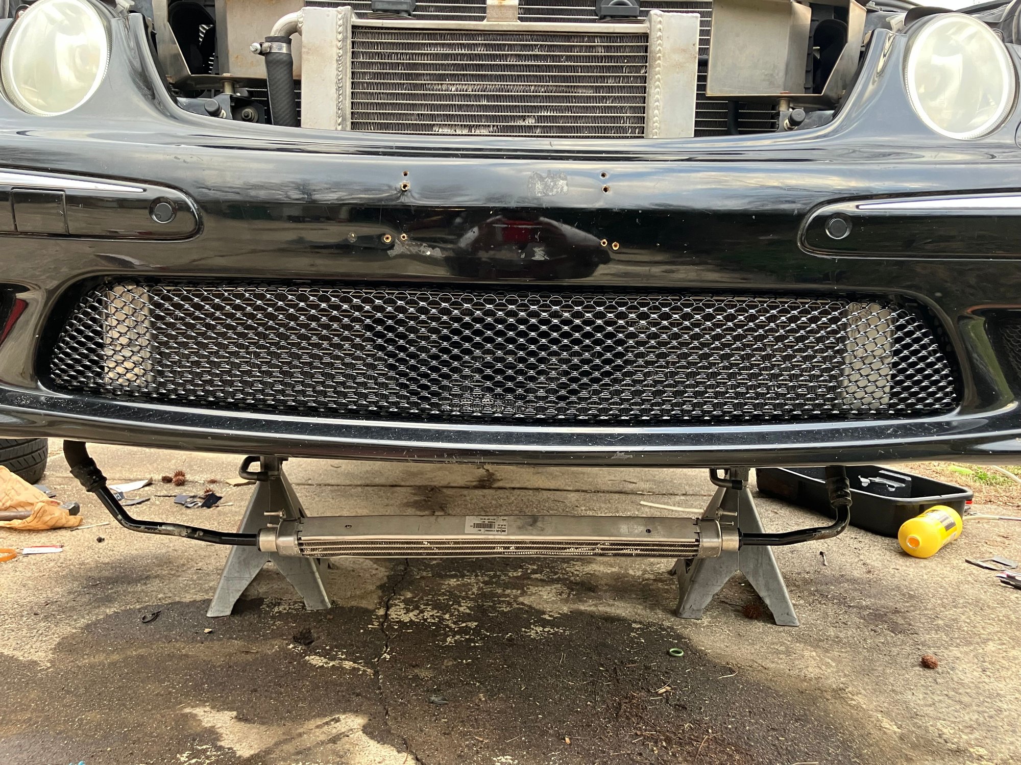

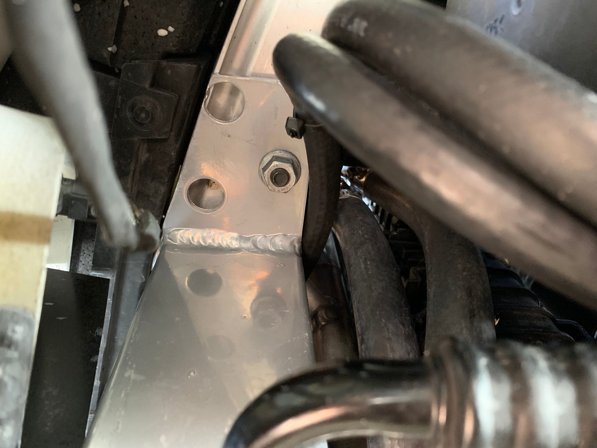

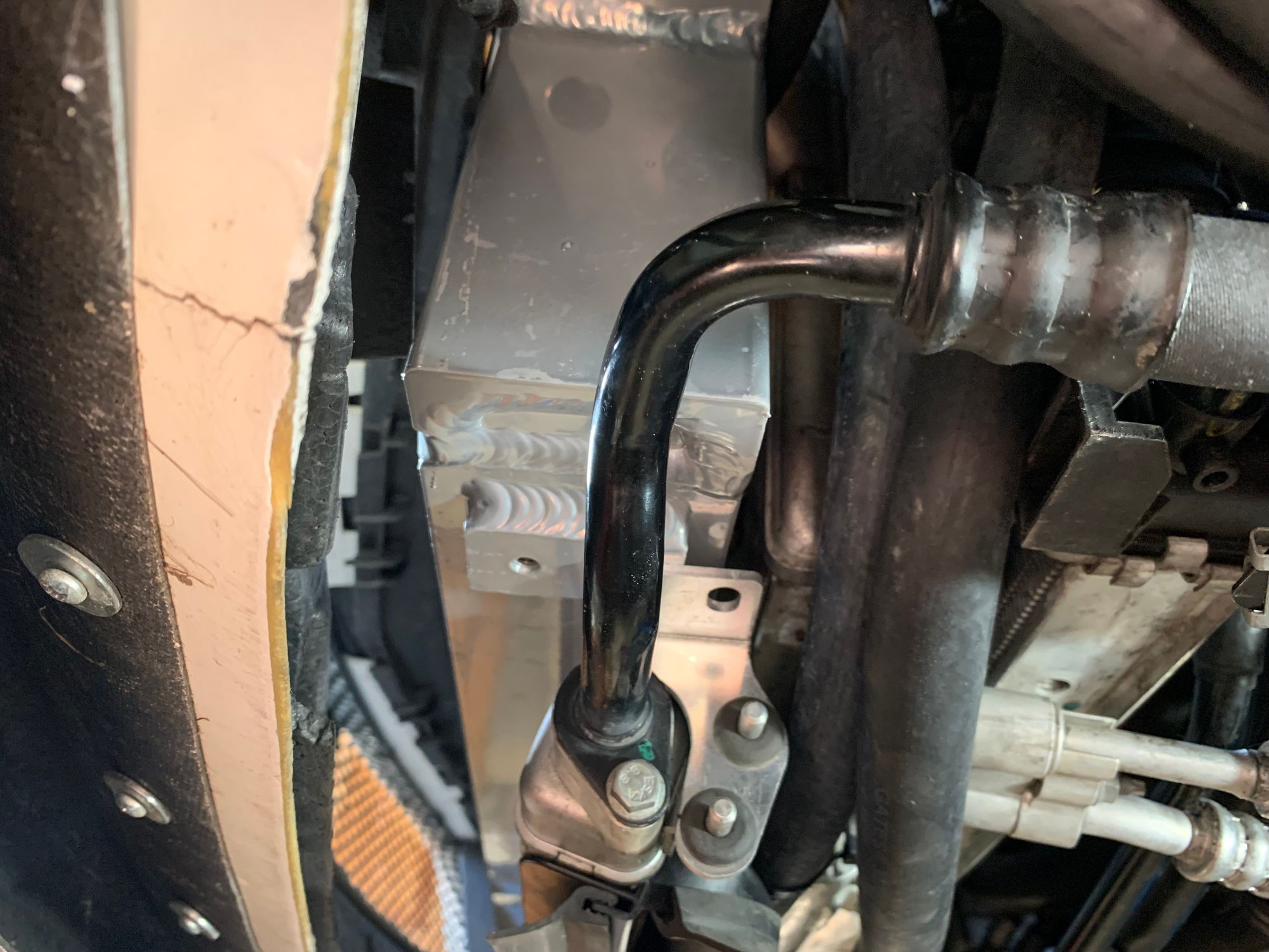

I have the CLS version of your car. I added the PLM H/E below the bumper crash bar. it has mounting location for the oil cooler as part of it. Maybe you coan added mounting blocks similar on your H/E. I have added pictures I took when I did the install.
Oil Cooler was at the correct location for it to vent through the front belly pan.
Mounted under the bumper crash bar.

Thanks for the pictures. My vrp heat exchanger doesn’t have those provisions for brackets. Also in my E55 there is virtually no room to mount it under there. Are you guys running the splash tray too?
