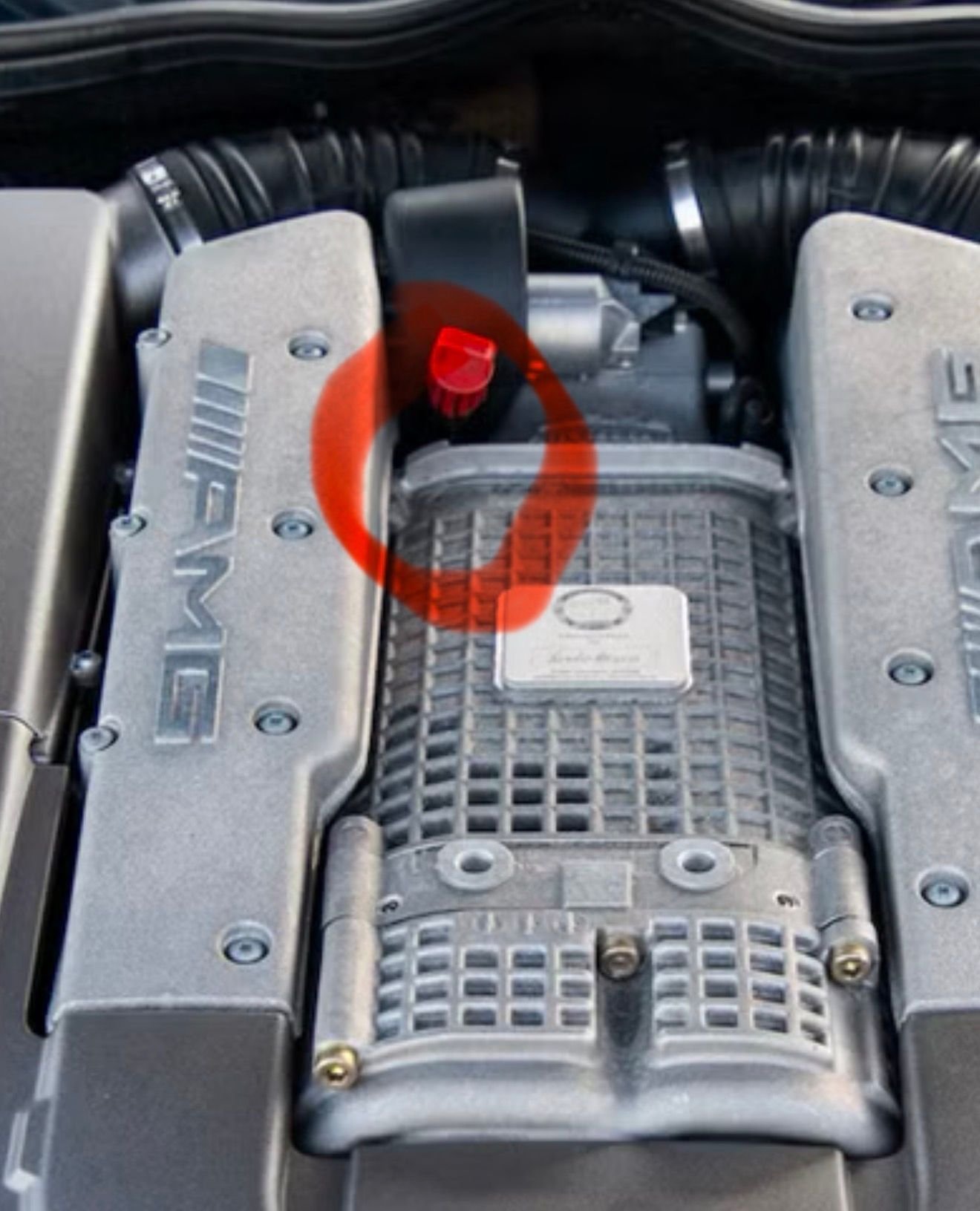

Vacuum hose plugs in back there. Easily dislodged.
The guy with the red cap is how you check and fill auto trans fluid.
red cap is to check oil level with dip stick, no? And the vacuum line I think you’re referring to plugs in on the opposite side

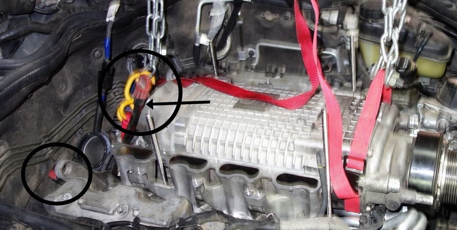

First statement correct.
Second statement erroneous. That is for checking engine oil level with aftermarket dipstick.
Transmission fill tube located behind throttle body.
Throttle body has two lines connecting to the valve cover vents to pull oil vapors into the intake.
Motor oil check tube has the arrow pointing to it left center. Transmission fill tube lower left partially hidden behind the hoist point.
Lines from throttle body to valve covers attach at the points indicated in the circles below.
Easiest to check by removing the two surge tanks. Have a piece of cardboard and punch holes in which to place the bolts as you remove them; the bolts are various lengths. Replacement gaskets are inexpensive.
Thanks @bbirdwell for the clarification, as always you are one of the many wise ones on this forum.
