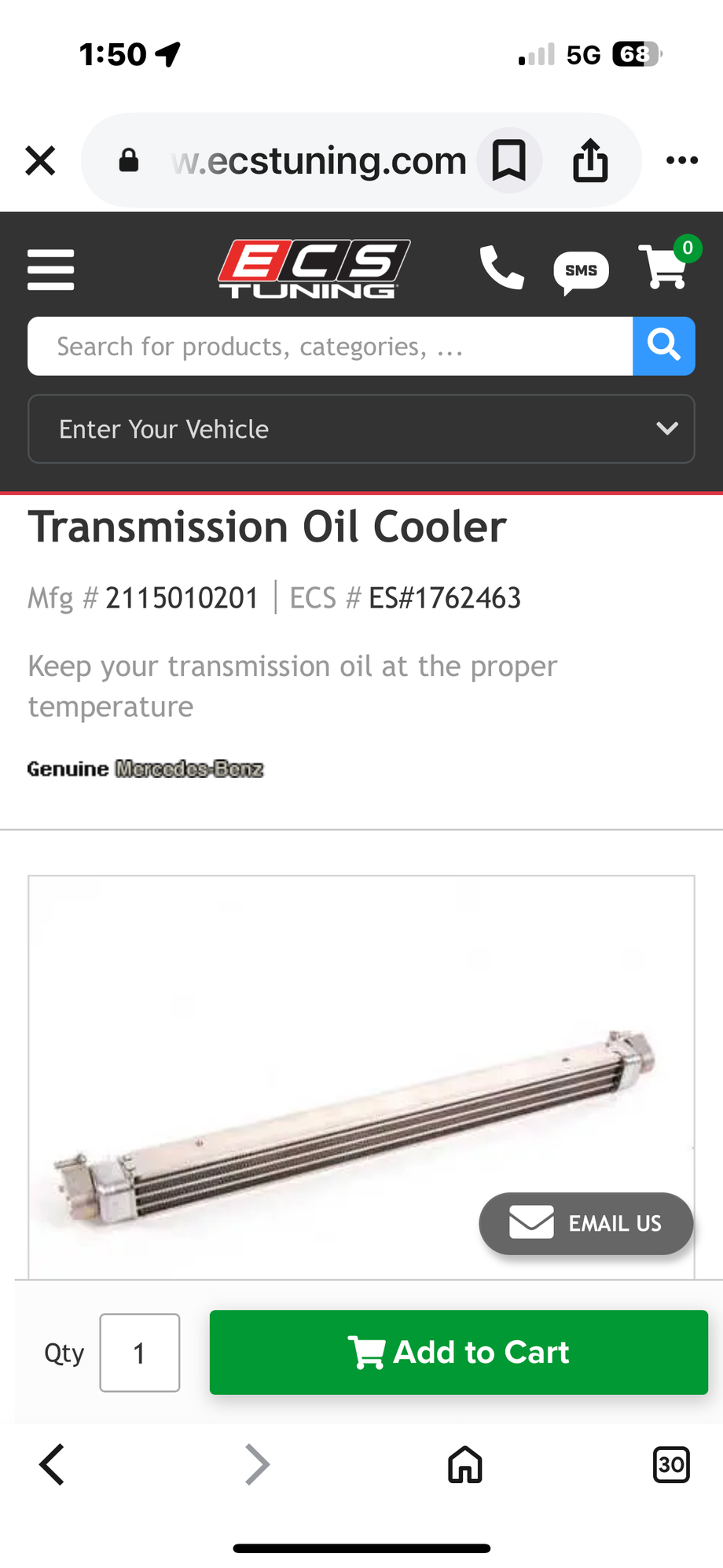

51north's Avatar
Joined: Aug 2018
Posts: 145
Likes: 59
From: Madison Wi
2003 e55, 2014 e63s wagon, 997 911.
Originally Posted by Fountain35
Veleo. I thought the later cars didn't have the oil lines in the radiator but I guess I was mistaken? In any case I'm glad I am changing the radiator. I'll take a couple pics and post them.
Do you have one of these somewhere? My car is a 2003 and it runs through the radiator. The ECS part in the pictures for a 2006
Old Apr 5, 2026 | 03:56 PM
Fountain35's Avatar
Joined: Nov 2017
Posts: 930
Likes: 166
From: Virginia
It has one of those as well.
Old Apr 6, 2026 | 08:56 AM
machild's Avatar
Top Answer: 1
Joined: Jun 2020
Posts: 1,179
Likes: 315
2006 CLS55 AMG, 2005 SLK 350 AMG
Each of the three lines I posted show the radiator is for model years 2003-2006. Using the oil (trans) oil connections on the radiator is completely optional by the user as they can simply not be used. As a reference, my CLS55 MY 06 and built in March 2006 has the oil cooler in the original radiator (just as the three aftermarket lines do) and also has the bar cooler as posted by @Fountain35 .

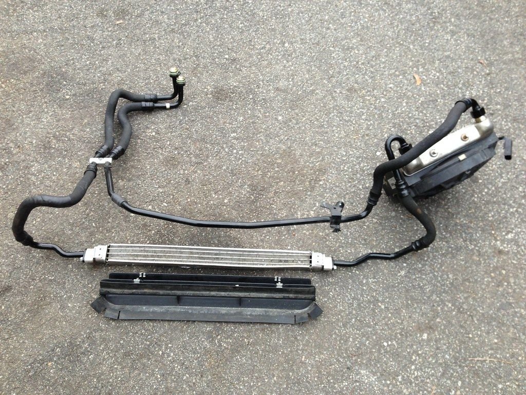

mbmg's Avatar
Joined: Mar 2017
Posts: 157
Likes: 27
From: Arizona
2004 E55
Odd that ECS calls it a transmission cooler. In past posts on this forum it is shown as an additional engine oil cooler in line with the larger square one in the passenger front fender. They added it sometime in 2004. My early 2004 doesn't have one. Here's a photo showing the lines attached.
