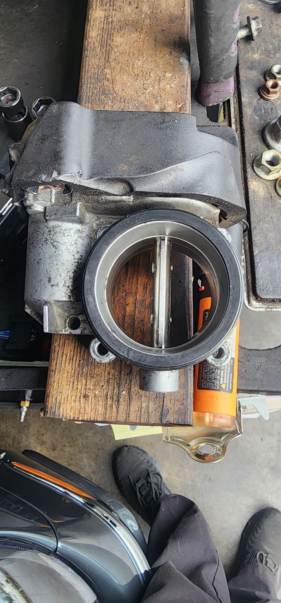

Hi All, Do you guys have the part number for the M113K supercharger bypass valve and know where I can get one? The wiring connector is totally messed up and can't get the wiring harness seated correctly. Wondering if I can find just a new bypass valve, or if you guys have another way to fix that. Please let me know. Thank you!
Guess its number 38 in this picture. Thanks!

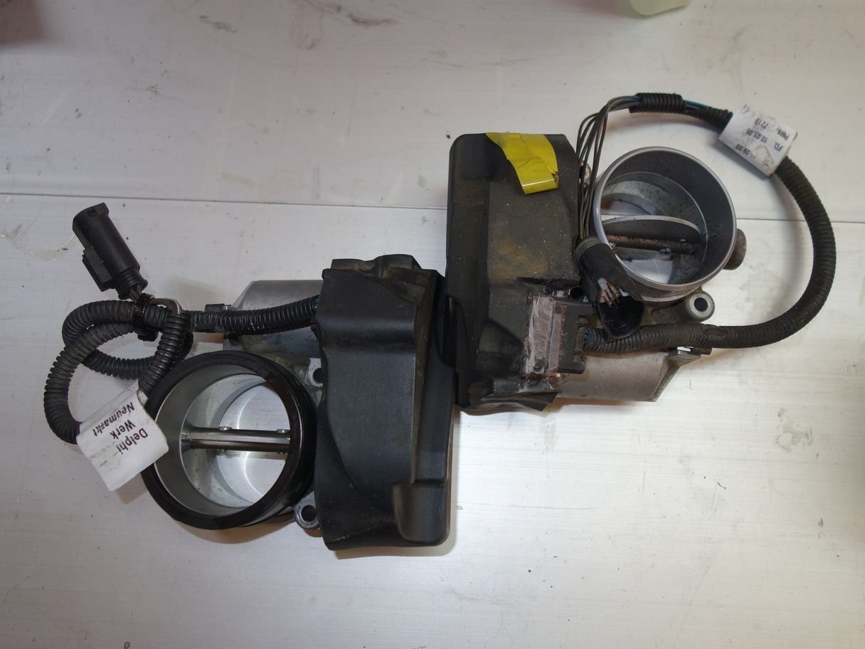

I have a pair of them on the shelf in my garage. One of them needs the sacrificial cable replaced (I have the cable, just have not done the work). Rebuilt bypass valves can be purchased on Ebay except there they are called "supercharger throttle body".
If you can't find one available, PM me and I'll let you know what I have on the shelf. EDIT: I have two each on the shelf.
Verify your part number on "nemigaparts.com".
FWIW, this is what I purchased back in January:
03-08 Mercedes W215 CL55 E55 SL55 AMG M113K Throttle Body 1131500028
US $189.99US $189.99
Sun, Jan 11, 12:37 PM
I do not know how experienced you are pulling the supercharger but here are a few of my notes from when I removed and reinstalled mine earlier this year:

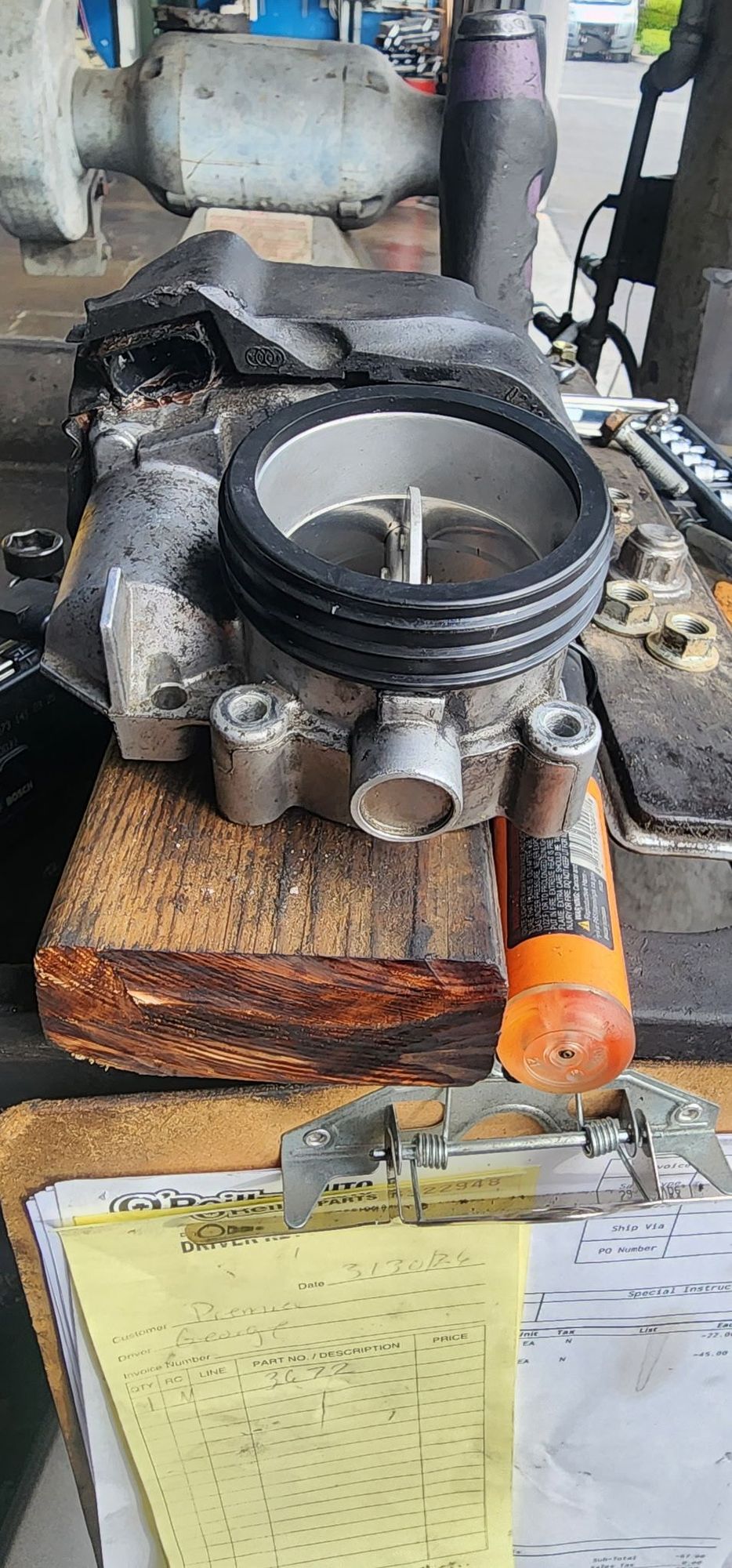

Hi Birdwell, thank you so much that is very kind of you! I love this community. Below are my options as I see it. What do you guys recommend? Thanks!
I found one using your part number on ebay for a decent price, but its used. 1131500028. https://www.ebay.com/itm/198113489074
On the m113k Facebook group, someone told me that the Supercharger Throttle body for the C230 is interchangeable. 03-05 Mercedes W203 C230 1.8L Supercharger Throttle Body Valve 1110980109 OEM. These parts are also inexpensive, although used.
The dealer is saying the part number is 1130980150, which is $1,134. https://classicparts.mbusa.com/oem-p...ody-1130980150
I'm tempted to get the used ones. Unfortunately, my mechanic already put the valve back in the car so I wasn't able to check the part number on the actual unit, but here are the pics of it.

I would purchase one from a model using the supercharged V8 ...CL55, E55, CLS55, SL55 etc.
Later versions added a plastic cover epoxied into place. Early versions had an exposed metal cover. I have one of each on my shelf. One came off my car; it works fine but I discovered the sacrificial cable with a bad connector was epoxied into place. I am going to use methylin chloride to remove the epoxy and install a new cable. The sacrificial cable alone cost approximately $100 at the dealership.
Never hurts to have spares on the shelf...

Problem solved, and some of the codes solved. Although now I discovered that my alternator is failing. My 2004 e55 has 138k miles on it so I knew I would have to. Probably going to replace the water pump and power steering pump "while I'm in there"
The Bypass valve that BBirdwell suggested was the one I used, 1131500028. I still have the slk230 if you're local and want to try that one.
