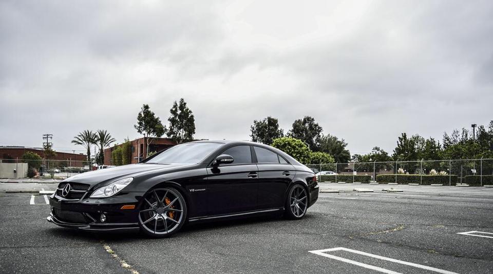

Originally Posted by abcut973
Which ones are you buying?
Verde Axis
Attached Thumbnails Considering wheel set with 36mm 9.5" wide rear wheels-10705245_10101642075823681_1254281213_n.jpg

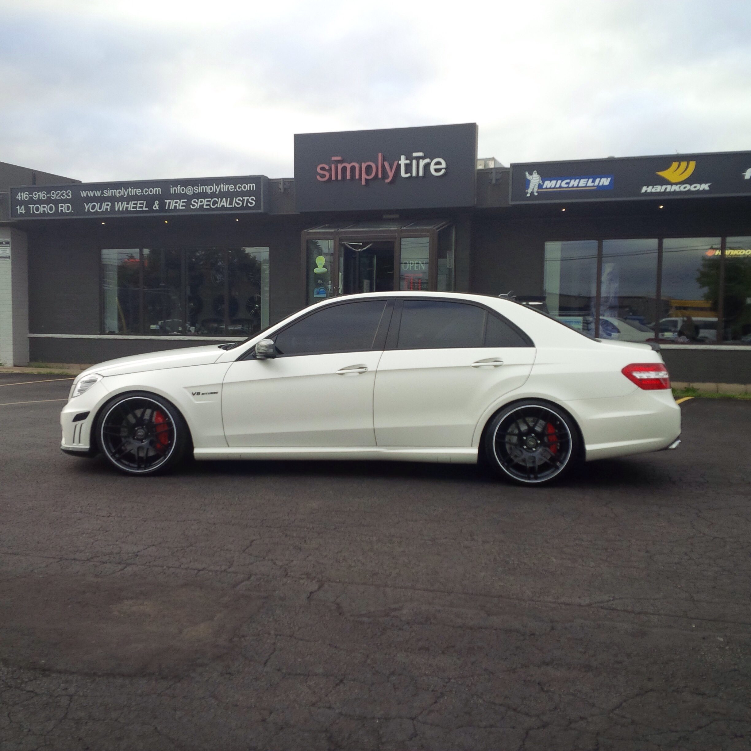

Old Oct 4, 2014 | 01:04 AM
AHI's Avatar
AHI
Joined: Jun 2007
Posts: 582
Likes: 43
From: Toronto
AMG GTR
My car is super low and super flush.
Old Oct 4, 2014 | 08:40 AM
stevel8206's Avatar
Joined: Jul 2013
Posts: 112
e63 biturbo
Originally Posted by AHI
Attachment 296013
Those look great how much did they cost you without tires? If I were to get those same wheels without a drop would they look alright?
Old Oct 23, 2014 | 11:14 PM
AHI's Avatar
AHI
Joined: Jun 2007
Posts: 582
Likes: 43
From: Toronto
AMG GTR
Sorry just got this message now.
Yes this setup works perfectly on stock suspension. Very flush, without being overly aggressive. The wheels are Forgestar F14. I'm running 245-30-20 / 285-25-20. But next year going with 255-30-20 / 295-25-20 now that the Supersports are available in the front size.
