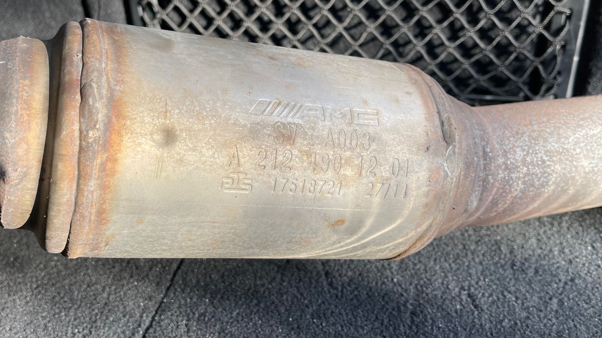

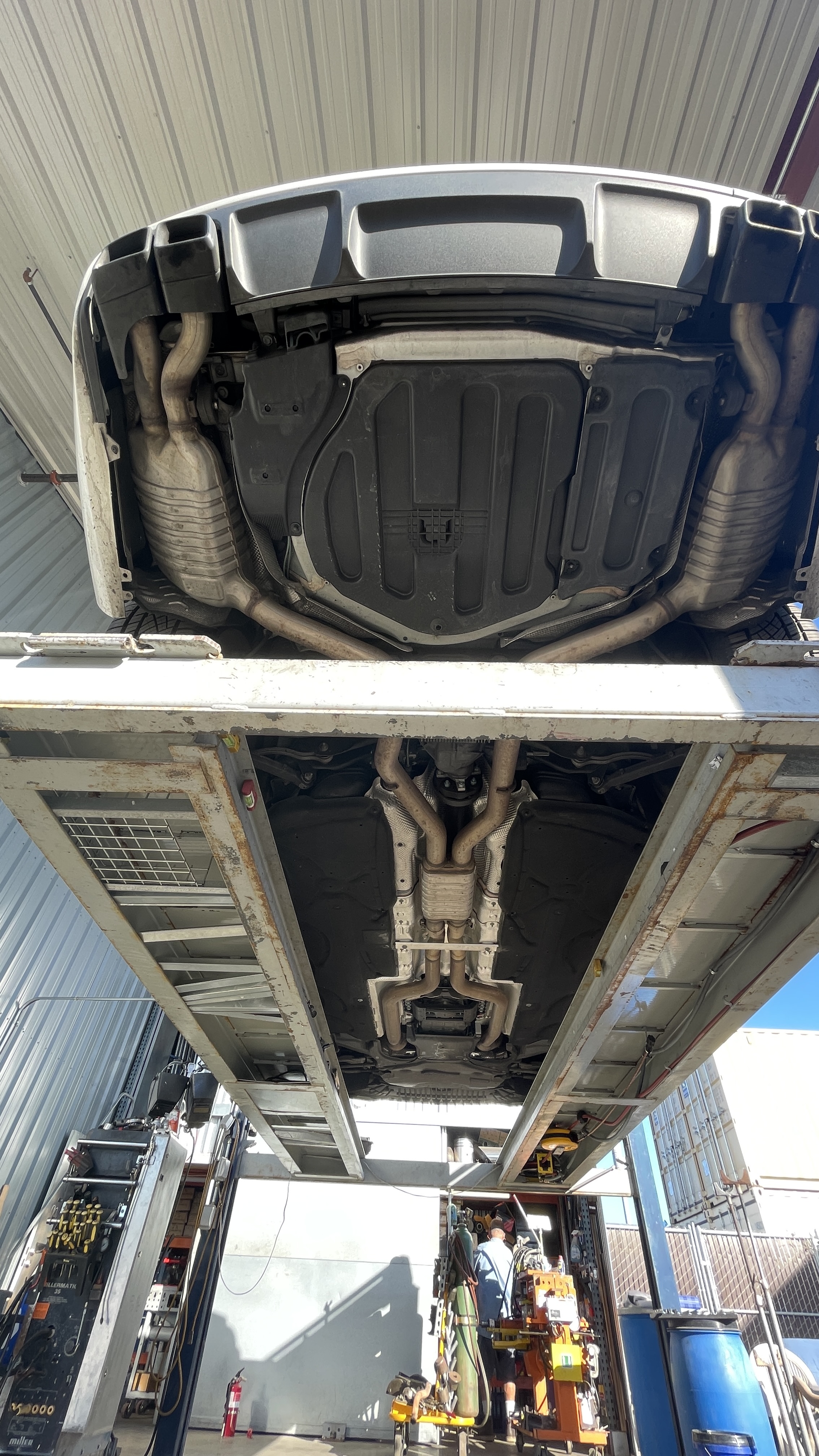

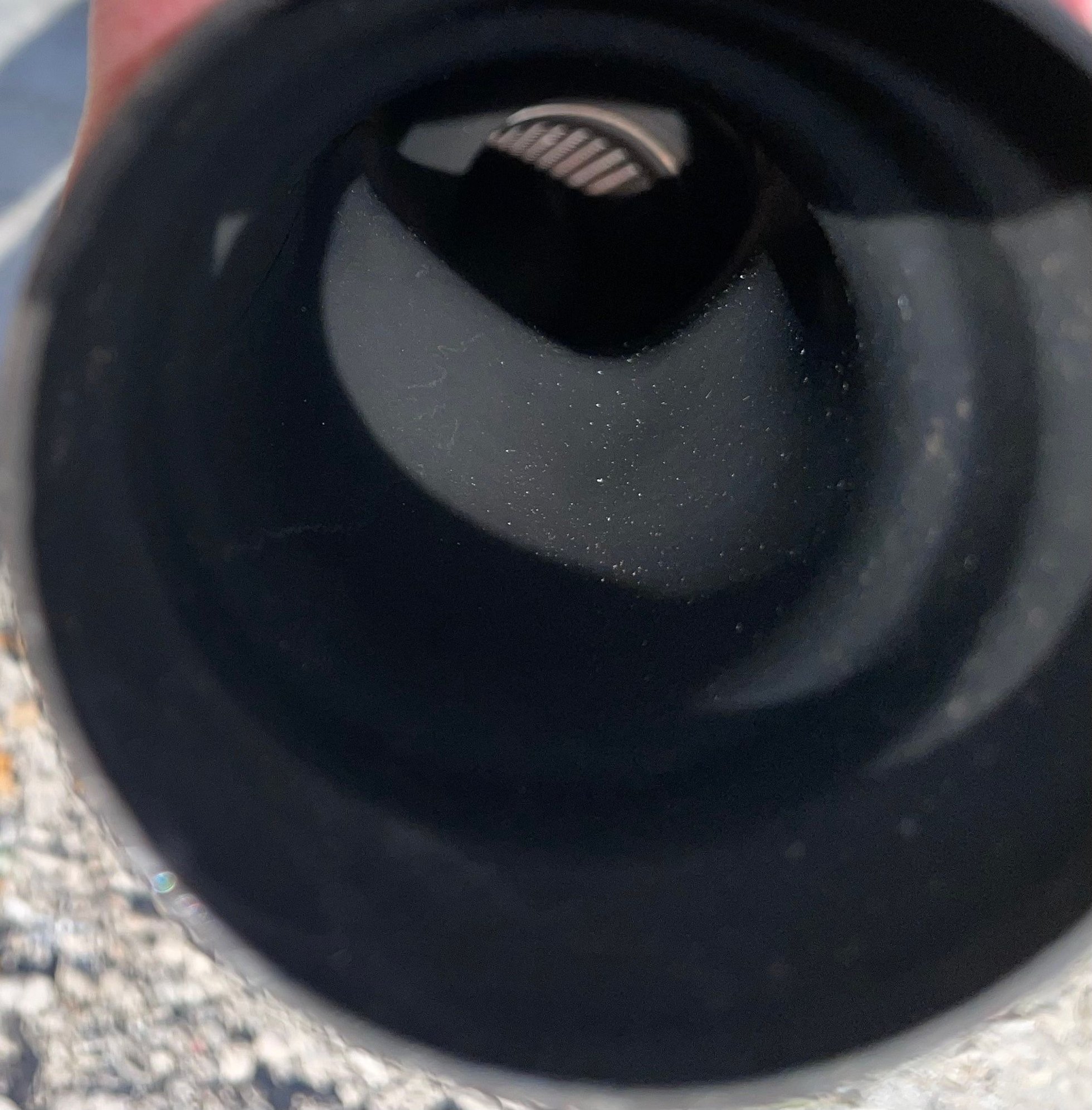

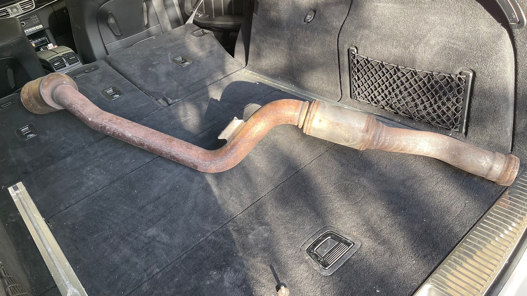

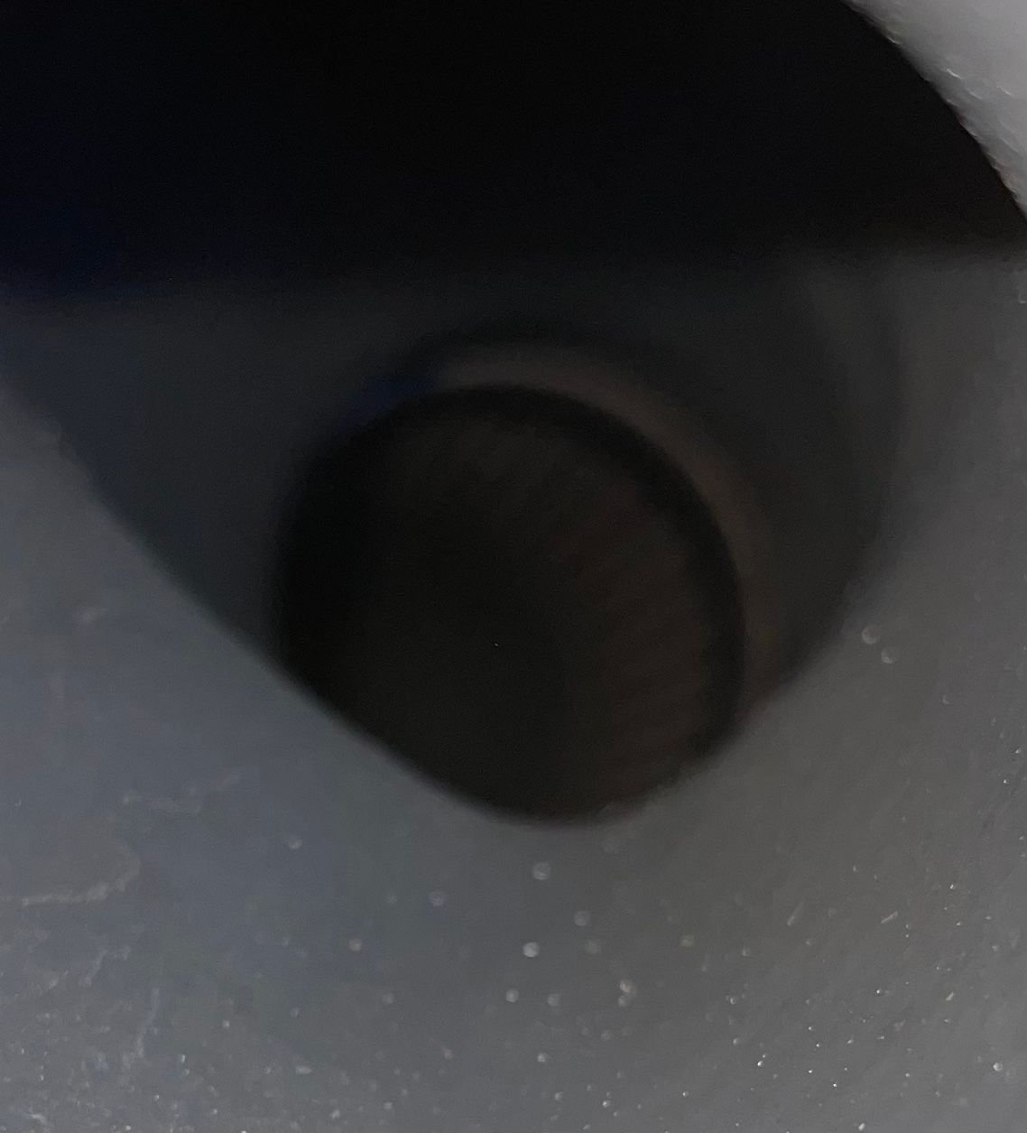

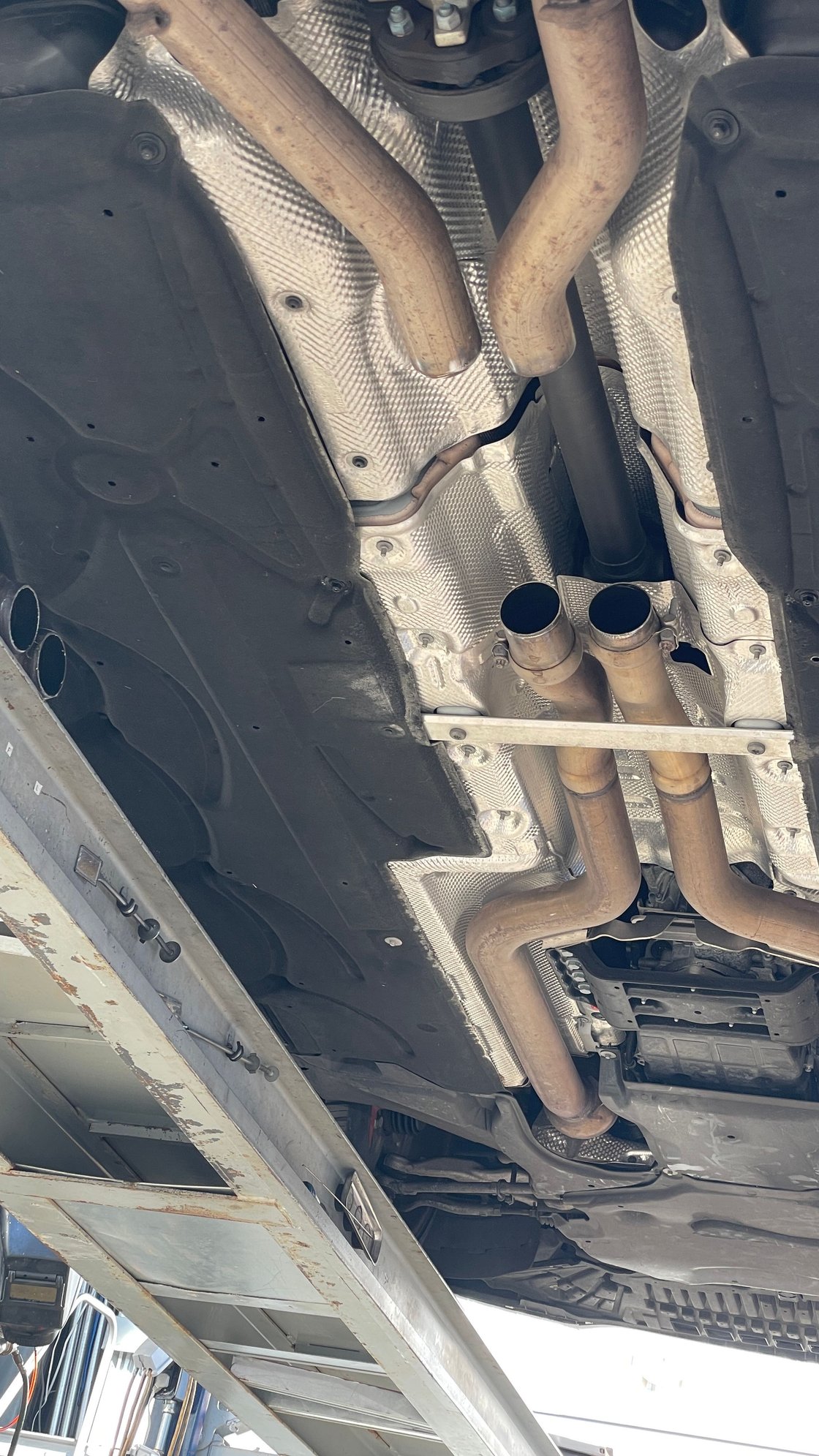

Just got my resonators removed, replaced with straight pipes. Car is 20% louder, and I think I may have lost anywhere from 2-5% of low end torque, nothing crazy, probably have not lost any torque at all and it's just my paranoia. I've attached some pictures and videos as to what mine looks like. I have a w218 cls63.

My wagon had them, they are straight through perforated pipe.
