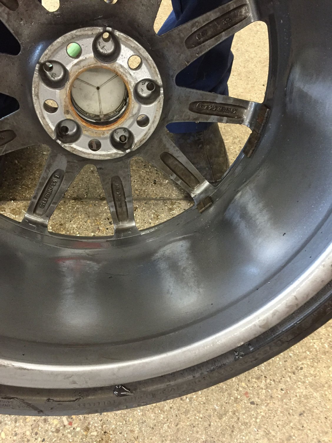

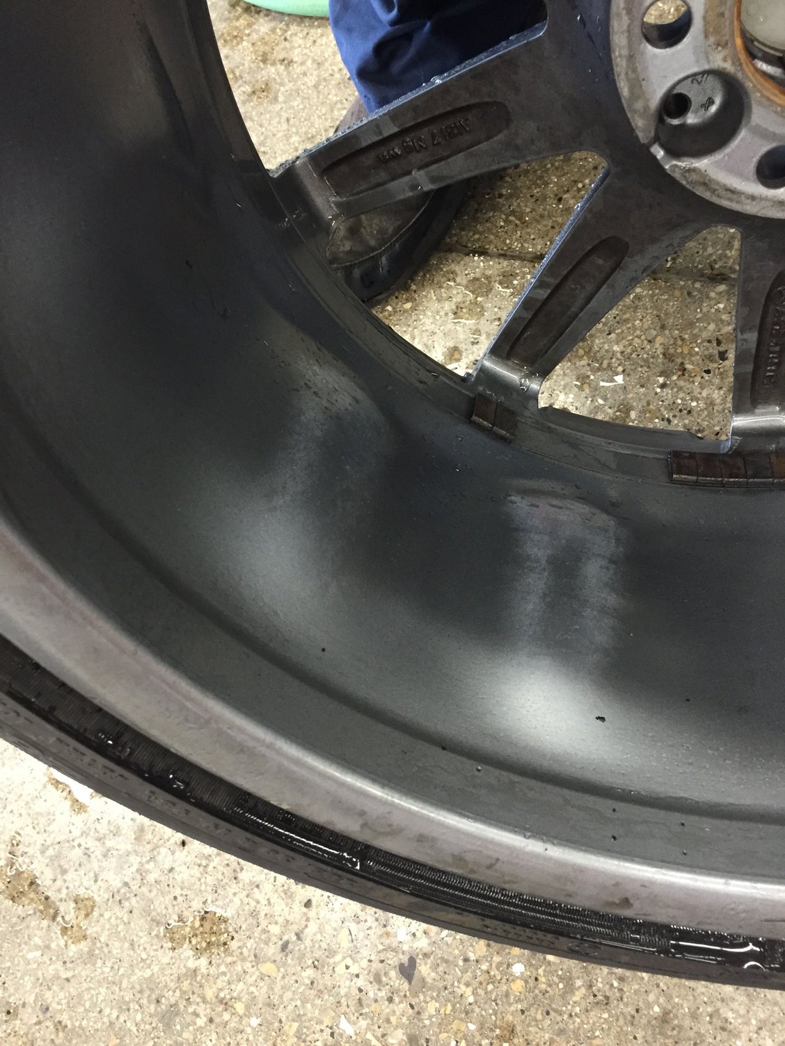

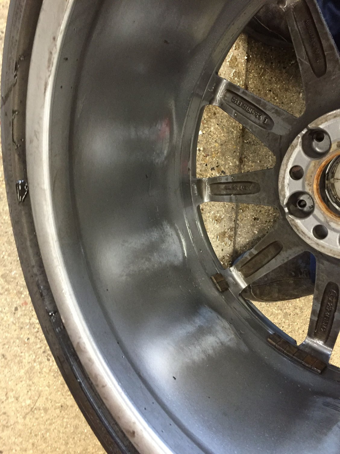

Here u go all u AMG gear heads. Just brought my e63 in for a new set of tires/ Conti's 5', Michelin Sports as u all know don't make a 285 so wanted to stay OEM. As my tire dealer put my car on the rack I had him check all rims before taking them off for new tires and here's what WE saw. Major damage on inside of rim!!! The photos u see look like gray shadows however those are huge ridges that pop up like about 1/4 inch. He said in 25 years he's never seen a rim with this type of damage. Looks like some type of warping from heat. Obviously didn't mount tires until I get a new rear rim. MB dealer outside of Chicago ordered a new rim. Only 3 available in the whole country. Dealer said of course MB will warranty it even though I bought tire and wheel package. Took the car right to dealer and got a loaner. Luckily nothing happened while driving it in the past. Could have been a catastrophic accident had that compromised wheel collapsed. Would love to know the reaction when the MB rep sees this wheel. Will let u know when I get my e63 back. 2012 with only 26,000 miles bought new. Brilliant silver with char leather and p30 package. Carbon fiber trim and red brake calipers. Regards signed lucky in Wilmette, Illinois.

That looks like a deformation from a high speed run, not heat, especially from a back wheel.
Wheel was most likely defective from day one.

Well just got off phone with my dealer. That rear alloy was fixed by a local wheel repair in Chicago as it was slightly curbed last year. As I said I have the tire and wheel warranty package. Seems whatever genius worked on that wheel milled down the inside of the rim and took it down obviously beyond where it should be. This compromised the integrity of the alloy itself. Now the dealer has to fight with the company that services damaged wheels. Of course that originally was ok'd and paid by the company I bought the warranty from! Either way someone is responsible and it's not me. Paid enough for car and warranty.

isnt the light areas on the inner barrel just light coming thru the spoke spaces??
