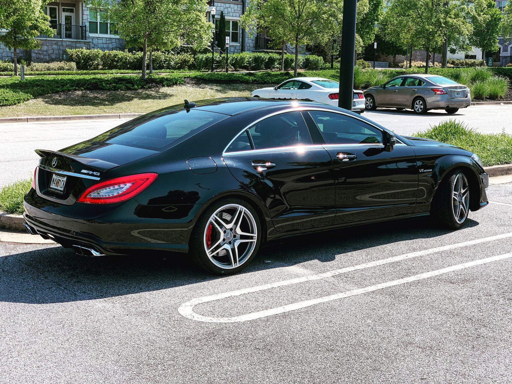

I just lowered my CLS with H&R’s and it’s a LOT lower than quoted. No problems here, looks fantastic.
Old Apr 25, 2020 | 12:03 AM
  #68
1MavRick's Avatar
Joined: Oct 2018
Posts: 445
Likes: 157
From: ATL
CLS 63 and M4
I love the stance the H&R gave my CLS...

'19 E63S, ‘16 CLS63 RIP, '09 E63 Gone, '06 M5 Gone, '97 Supra TT Gone
H&R’s and rear links

Both car stances are nice. Curious for the white CLS why does it seem it didnt lower by much? Are those 20" or 19". If they are 20"s then it definitely shouldn't show much of a drop for my AMG since I have 19"s. Would be nice if it lowered to the same level as the rear. I'm disappointed it doesn't lower much and that I have to get 20" just so the gap wouldn't be less to the fenders up front. Looks like I have to get KWs or coilovers..
Old Apr 25, 2020 | 01:24 AM
19” wheels. KW’s are the way to go if you want it slammed.
