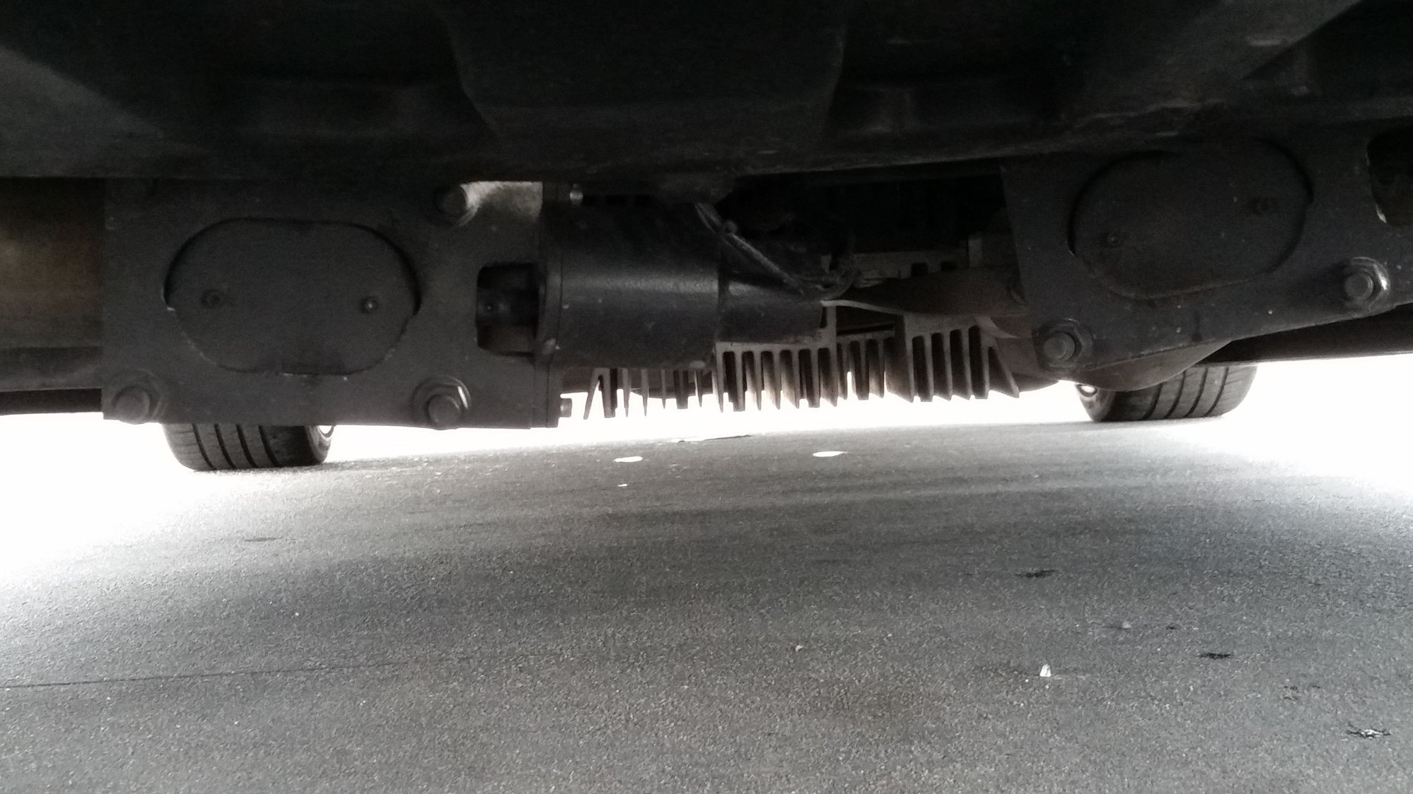

Has anyone had electric exhaust cutouts welded in when doing the resonators delete? Or just had the cutouts welded in place without removing the resonators/cats?
I'm thinking this may be a good and inexpensive way to have a civil exhaust note but unleash the furry when desired

I installed the oval lo-profile QTP electric cutouts just behind the 3rd member on my wife's '12 E63 daily. The exhaust runs down the driveshaft tunnel, past the rear subframe & turn out towards the taillights so it's almost a straight shot thru the cutouts when they're open. Cold starts are AWESOME!
Do you have any undercarriage pics?
Only pic on my phone
